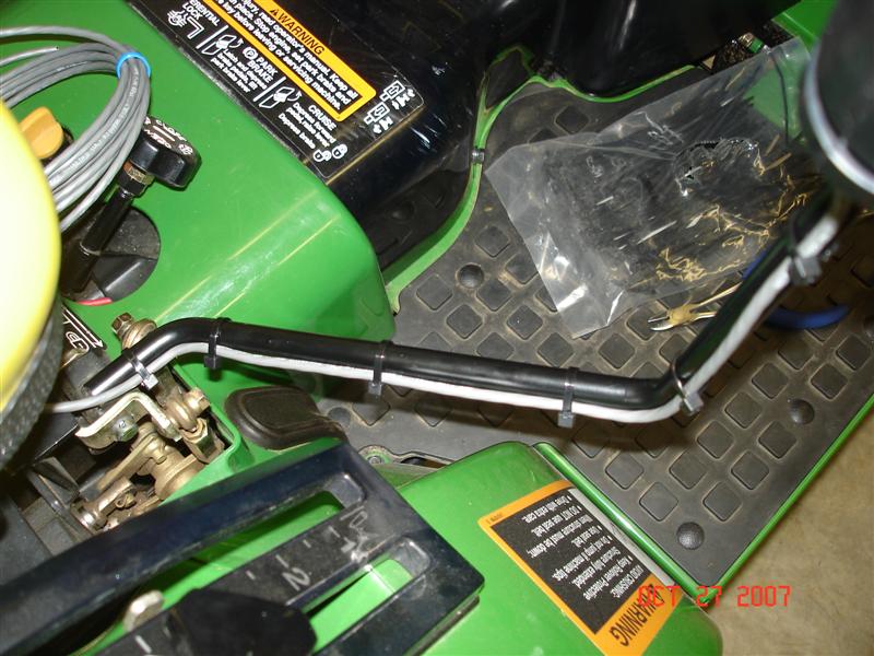

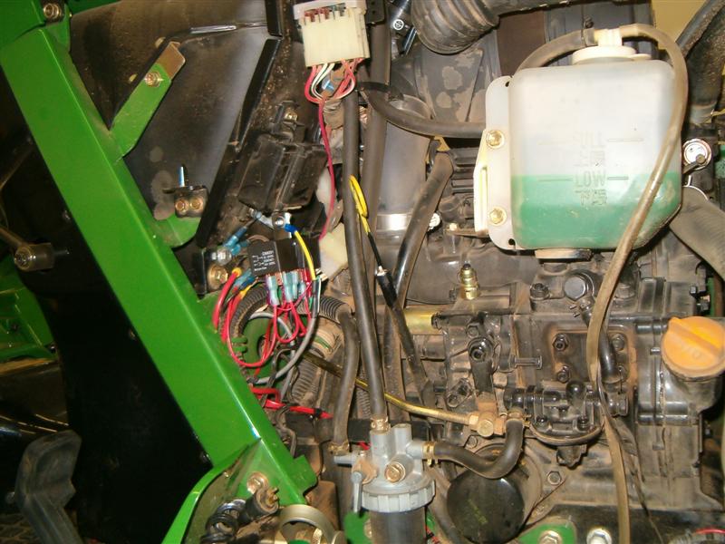

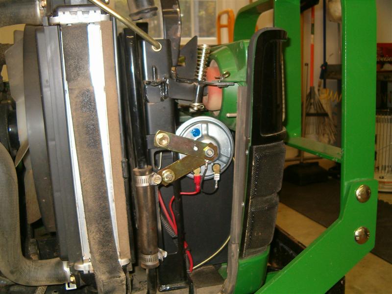

I finally got a chance to install my Joystick handle I bought last year, and while I was at it and had an extra button I installed a horn. The Handle is from John Deere, they use it on the 110 TLB's (cost $170.00) and the horn is from AutoZone (cost $14.00).
The hole in the end of the joystick was to big to fit, so I had to machine the adapter to make it fit.
I added 2 relays because I did not know the rating of the membrane switch in the handle, So I thought I'd just play it safe with the relays. The UP/DOWN switch operates the diverter on the FEL, either UP or Down activates the diverter. The front single switch operates the horn.
Thanks for looking:D

Nice clean install on the joystick and horn, the wire connectors, relay install and wire routing look great. Definitely a good idea to install relays using joystick switches. To protect the switches 100% did you install diodes across the relay coils?
Whenever a switch is used on a DC relay or solenoid, or any type of inductive load (coils of wire wrapped around a ferris metal core) with DC (Direct Current) A diode is installed across the solenoid or relay coils to protect the switch contact from arcing. When the field energy that energizes a relay or solenoid collapses from opening a switch, reverse high current, high voltage is generated that arcs across the switch contacts when opened.
A diode will short out that resultant reverse current generated by the coil when the switch is opened, (It prevents arcing across the switch contacts extending switch life). One diode per solenoid or relay coil. Make sure the polarity is correct! i.e. The white band (cathode) on the diode is connected to the + side of the coil the other end of the diode (anode) is connected to the minus side of the coil. Like this:
Most 12 volt applications can use a 1 amp 1000 volt diode (NTE125)

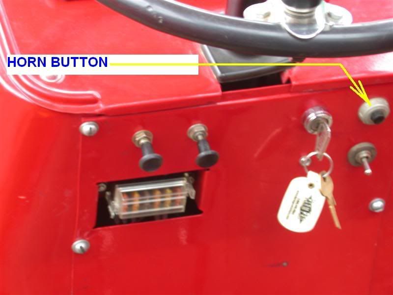

Kenny,
Yeah, my Kama came with a horn in it. I only use it to get my wife's attention though.
Like SOS, three long beeps means "Bring some more coffee please". I've only tried that once though, and it didn't go over very well. So now I just drive back to camp to get more coffee.:)
Here's where the button is located on a lower dash panel below the instrument cluster.

Thanks Larry, I did not use diode, but I remember everything you said from three years of Electronics classes. I will definately get some-I think I mat even have some in my old "project box"
And also thanks for the compliments...:eek:
