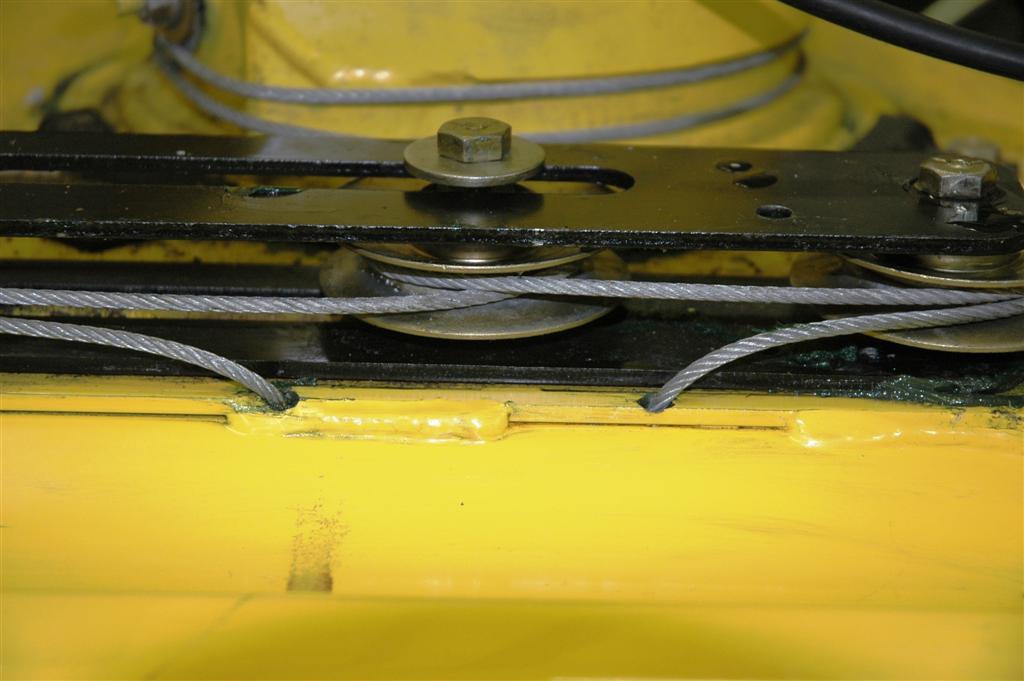

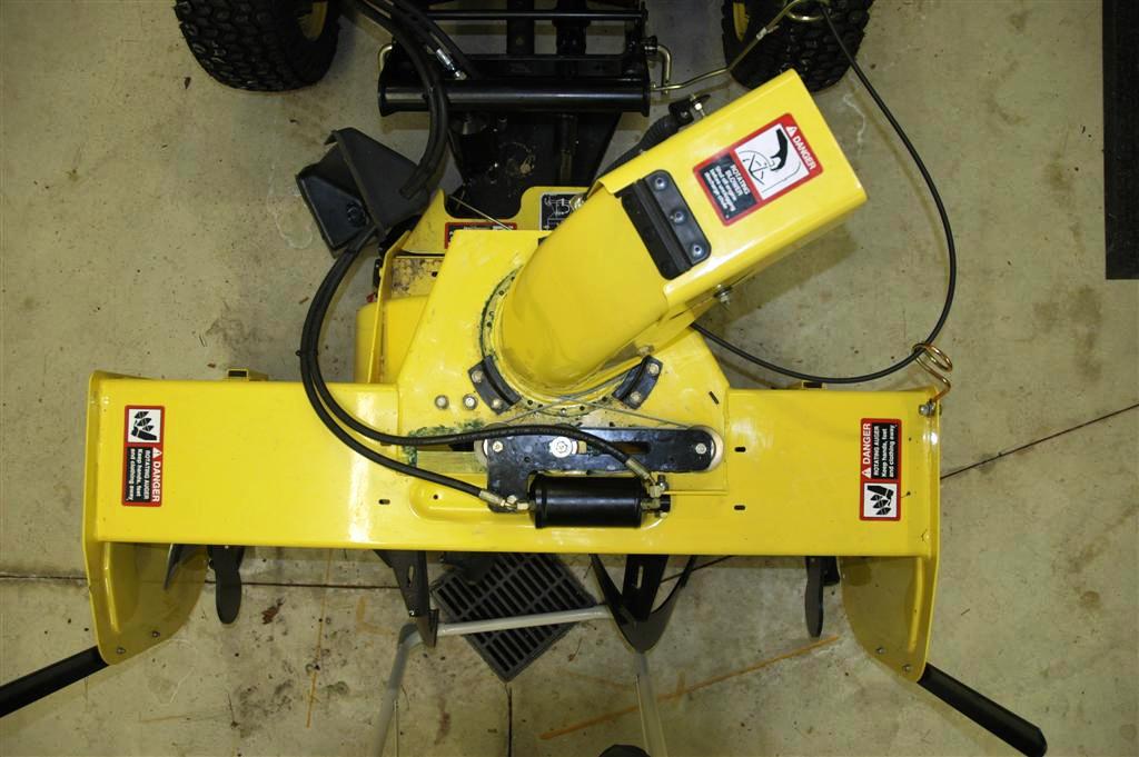

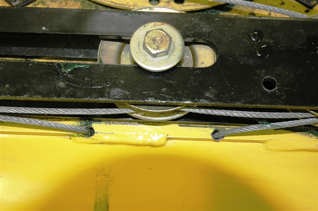

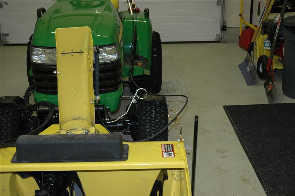

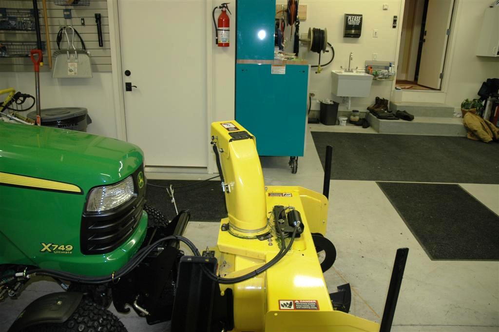

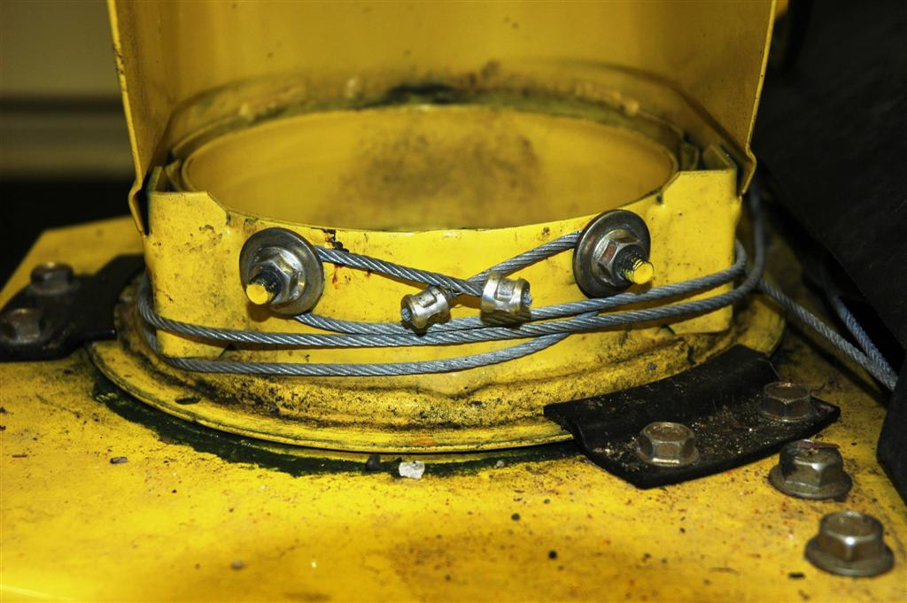

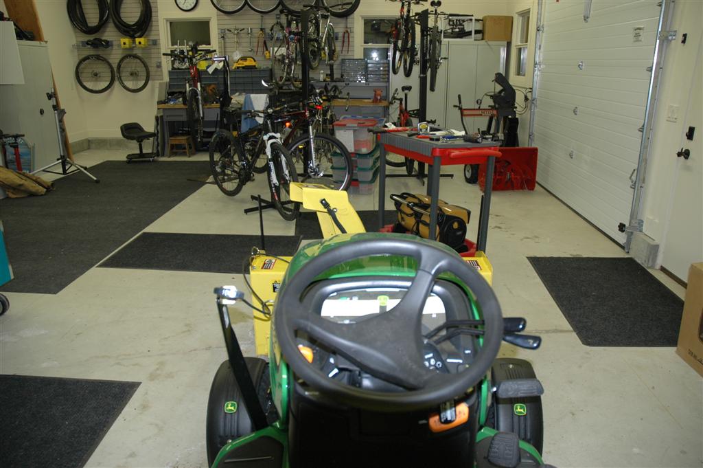

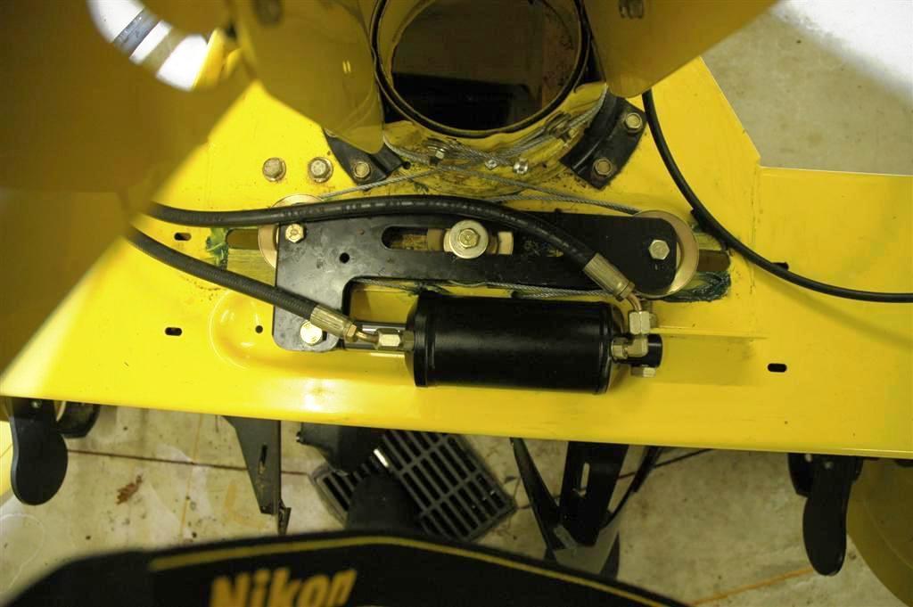

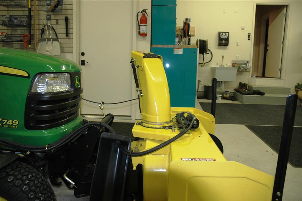

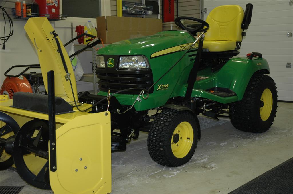

Another member came up with a way to get more rotation out of the snowblower chute; it was posted in this thread. http://www.tractorbynet.com/forums/...od-jd.html?highlight=snow+blower+47"+rotation
I performed the same mod with a slight change - instead of wrapping the cables around the bushing of the pulleys as suggested, I made up new cables (58" long) so I could wrap them in the "V" of the pulley instead thus lessening the wear and tear. Normally in the stock set-up you would take all the slack out of the cables to get the maximum rotation but since there is so much more rotation in this set-up I left a little slack to cut down on the cable wear also. Be careful not to leave so much slack that the cables fall off the pulleys.
One other thing to mention; I drilled the new holes 1 1/2" off the centerline of the slide anchor bolt but 1 1/4" would work better.
Thanks to the fellow that came up with this idea in the first place.

I love the extra rotation you have on your blower chute, you said that you made up some longer cables , I believe that the original cables have a solid ball on one end of the cable, did you order some cables somewhere ? How did you deal with this? Also you said that you drilled a new hole off the centerline of the slide anchor bolt? Can you elaborate on this, I want to do this to my blower but want to have everything ready when I start. what diameter is the cable? thanks for any information you can help me with
   / 47" Snowblower Chute Rotation Mod -Revisited

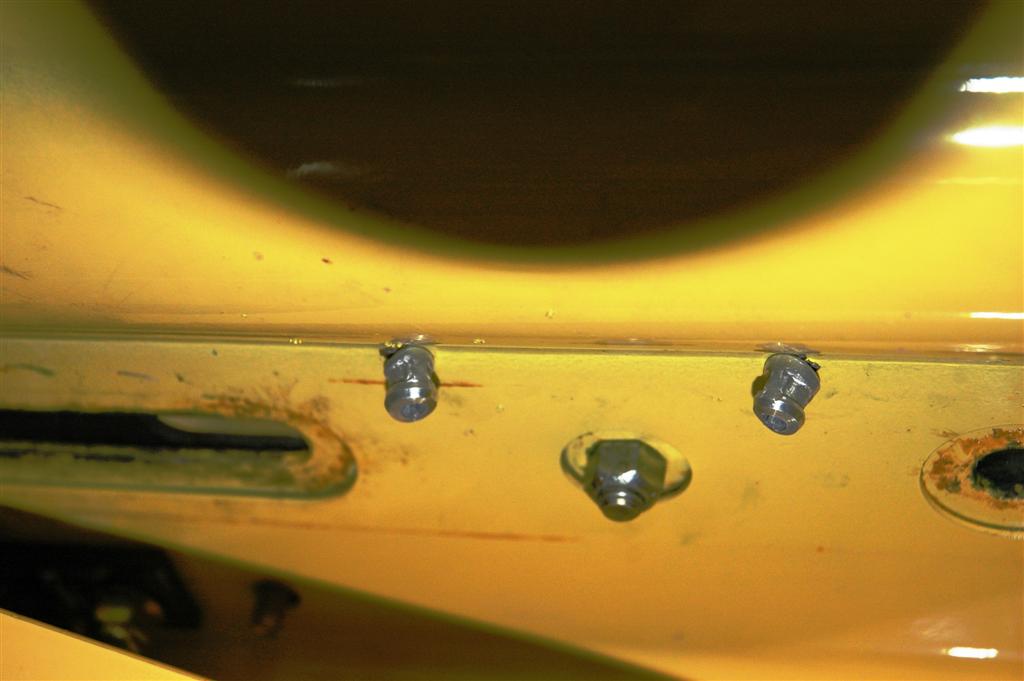

Here are some pictures to show the location of the drilled holes. I drilled 3/16" diameter holes and chamfered them with a 60 degree tool to lessen the stress.
The cable is 1/8" diameter - same as stock - My dealer handed me a big coil of cable along with some compression stops and compression tool and said "bring back what you don't use". (Time to put in a shameless plug for Jim and Jayson at "Four Seasons Lawn and Sport" --- John Deere are you listening????).
I would think that any old time hardware store would have the same on hand and could make the cables up for you. What was nice about having the extra fittings and compression tool was I could crimp the ends next to the chute and prevent fraying.

Thanks Turbo,
I made this mod last night. It was easy and took about an hour. Makes a huge differance I don't have to stop short at the end of the driveway so I don't blow snow in the road and I can get up closer to the buidings now... I should have done this long ago.
