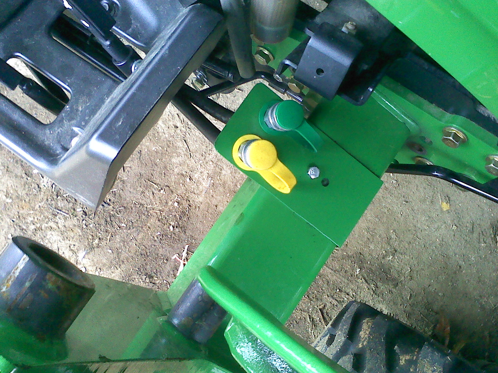

   / Installing a 2 spool SCV on a JD 2320

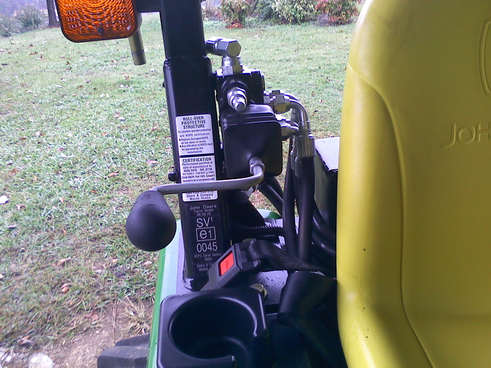

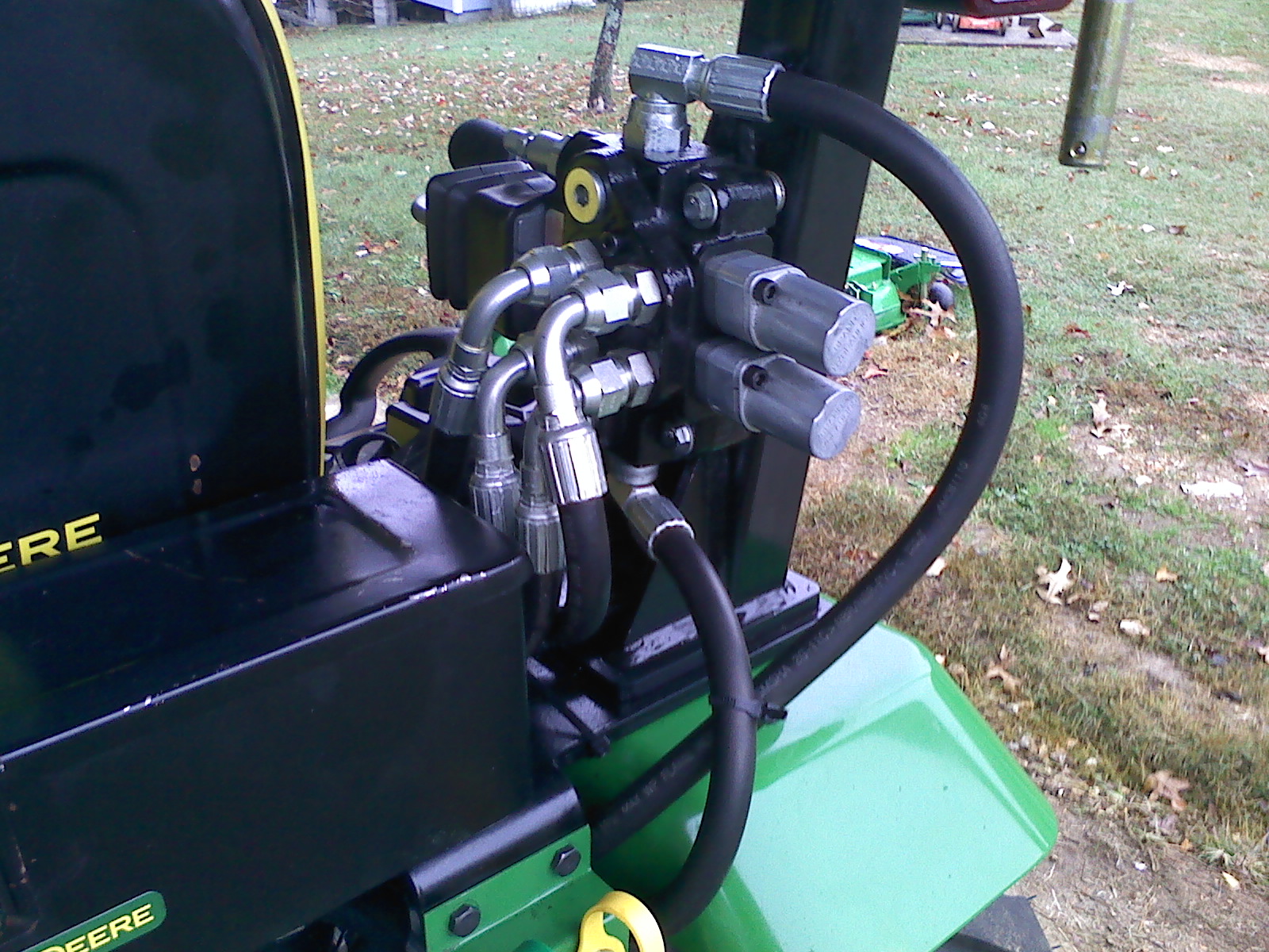

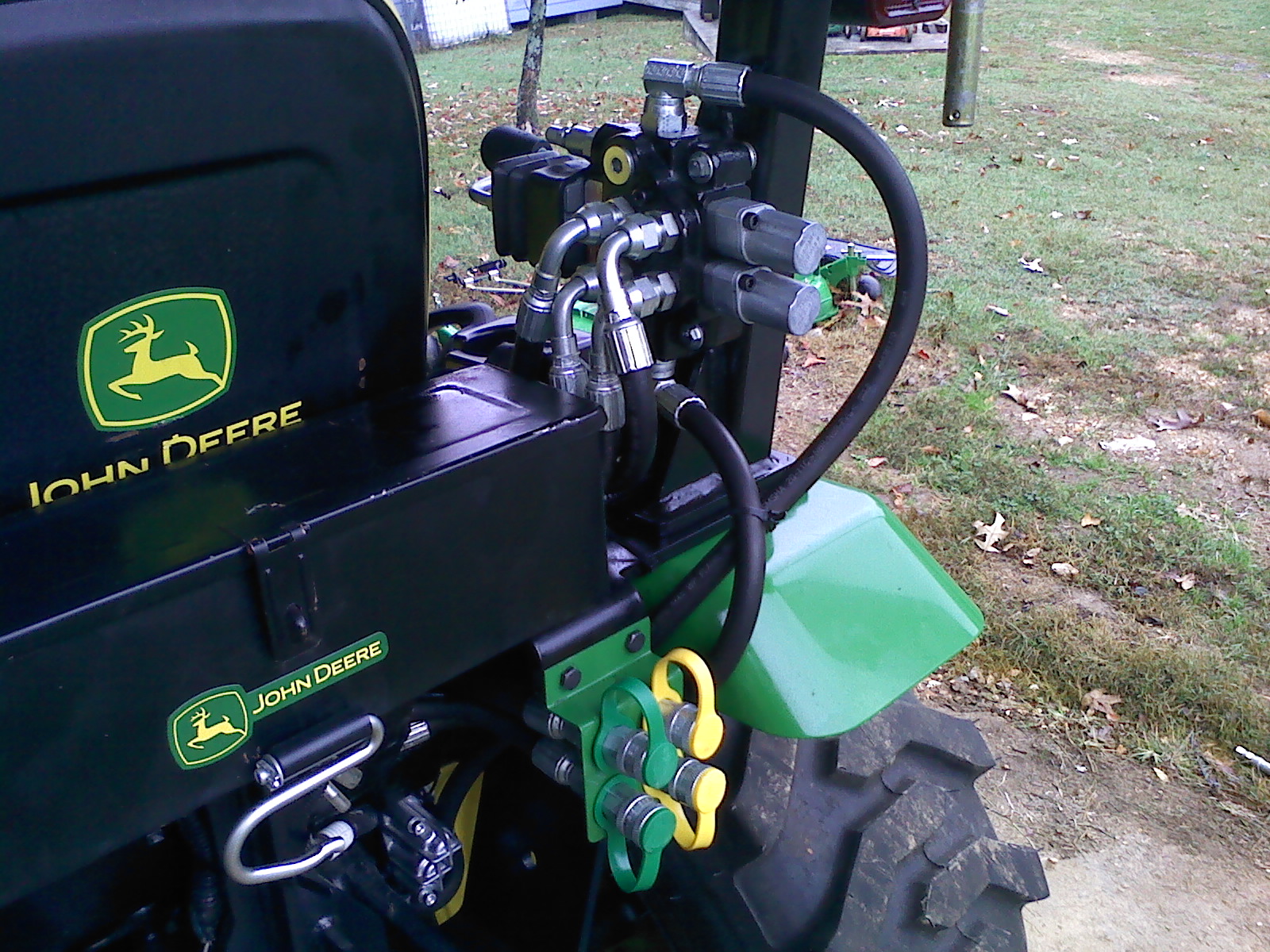

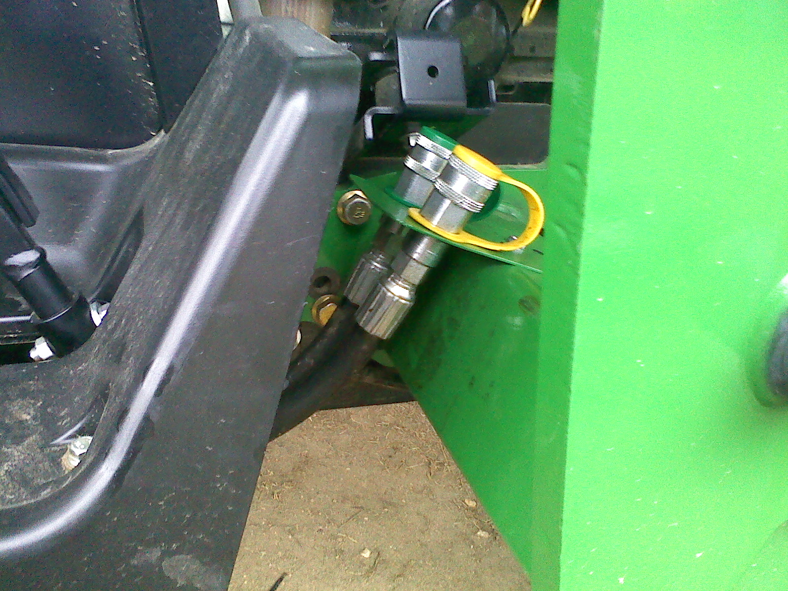

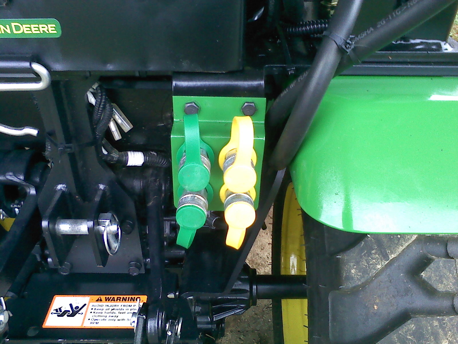

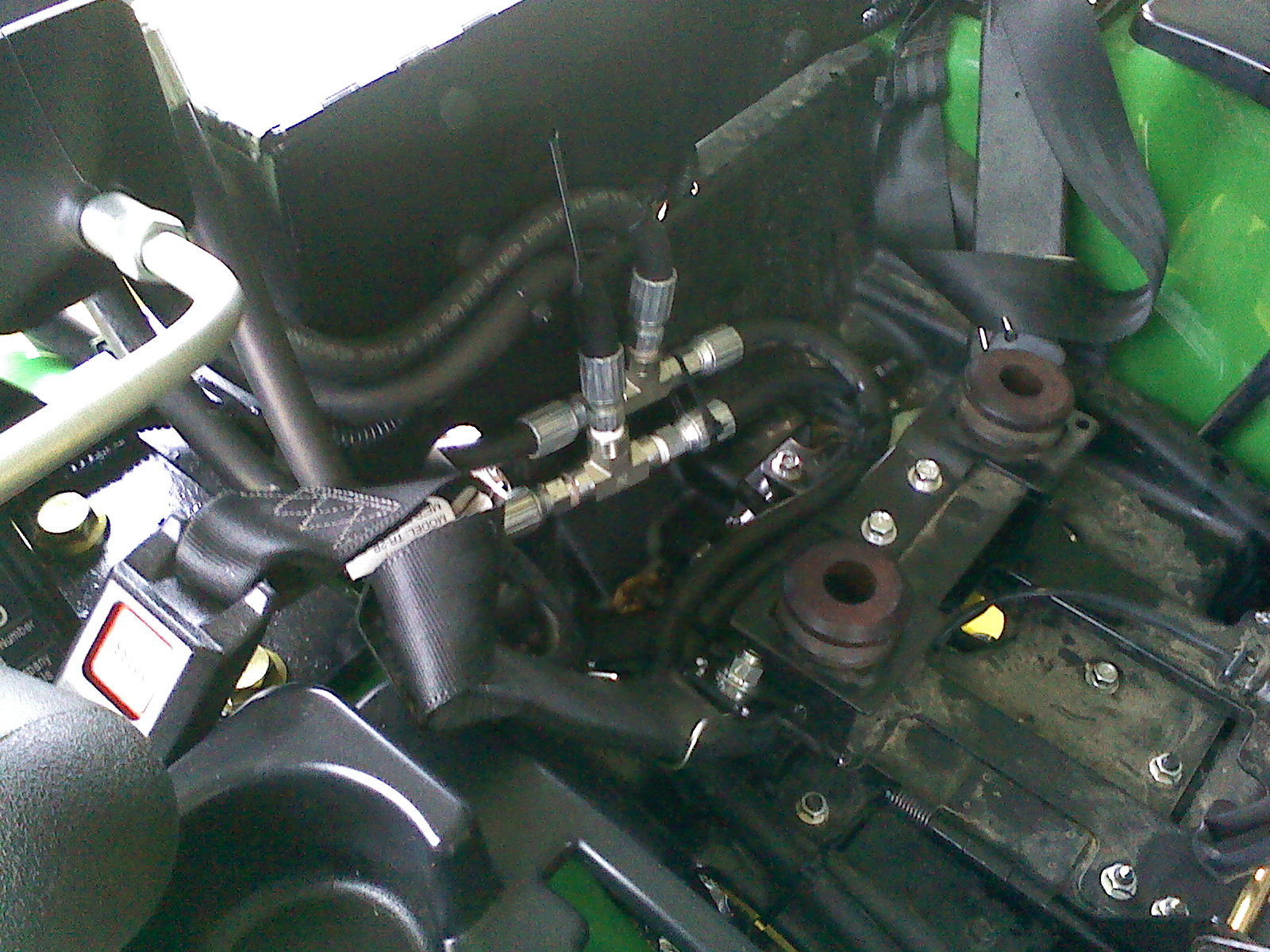

Here are several pictures of my 2 spool SCV that I recently installed on my JD 2320. The valve is a Brand hydraulics 2 spool loader valve. I modified the joy stick handle so it would be more comfortable and easier to use. I used a local industrial supply store for all of my fittings and hoses. I ordered the female quick connect couplins and dust covers from greenpartsstore.com. They have most of the offical JD parts at a fraction of the cost and usually ship it the same day. I made all of my mounting brackets from 1/8" plate steel. I installed 4 quick connect couplins on the rear. I also installed 2 quick connect couplins on my right side loader mast. This will allow me to hook-up my grapple. The front couplins are connected to two of the rear couplins with 3/8" tees. This way I can have a dedicated set of couplins for my hydraulic top link and use the other couplins for either my grapple or my hydraulic offset mower that I made. I am still waiting on my male quick connect couplins to ship before I can use the top link......but I have tested the valve and it works great.
