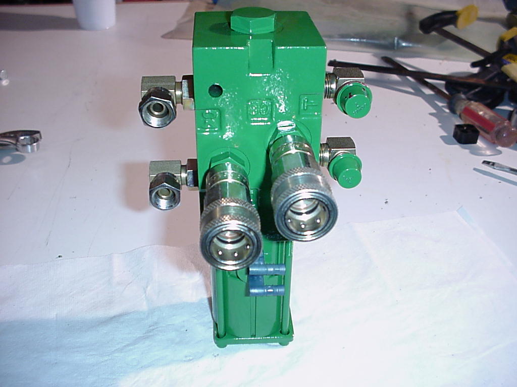

I started gathering parts and info for this project last year, today I finally got it installed.
Here is the Electric Diverter Valve from the Surplus Center all painted and ready to mount.
PS. this is my first post with pictures so bear with me!

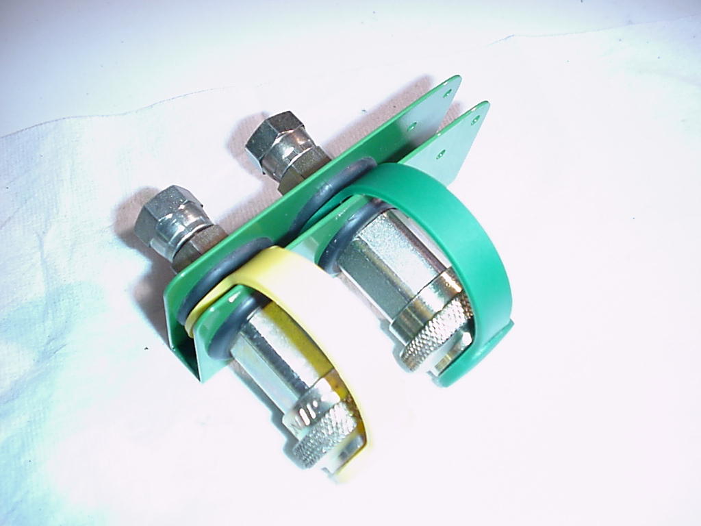

This is the coupler mount that I made to mount on the loader arms.
This project is for a snow plow that I am making also, I needed a remote to operate the angle of the plow. I may also build a grapple for the bucket in the future.

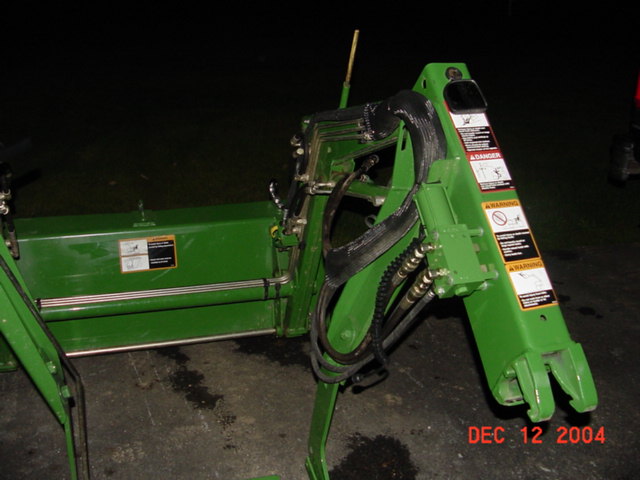

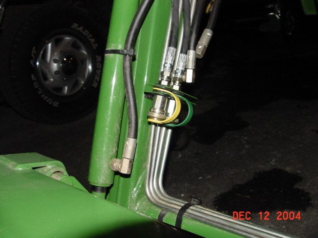

   / Added Remote to FEL...
Here is the couplers mounted up front on the loader arms. The plumbing follws the same route as the existing lines.
Here is a view from behing the loader...

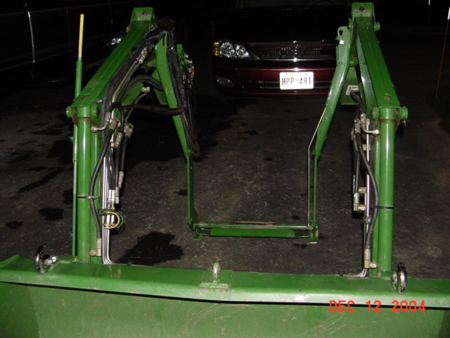

Here is a view from the front. It is getting dark so the picture quality is not the best...Sorry!

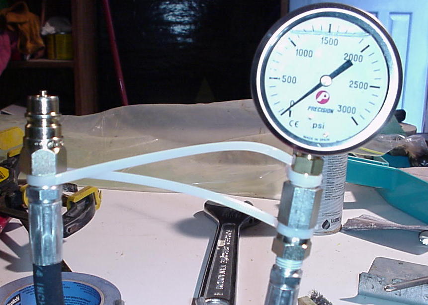

Here is a gauge I put together for testing the relif valve pressure, It was dead on spec!
