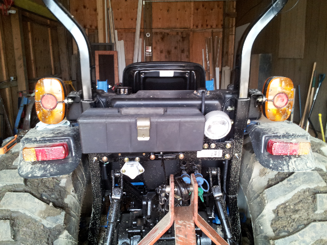

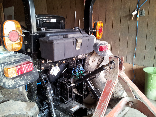

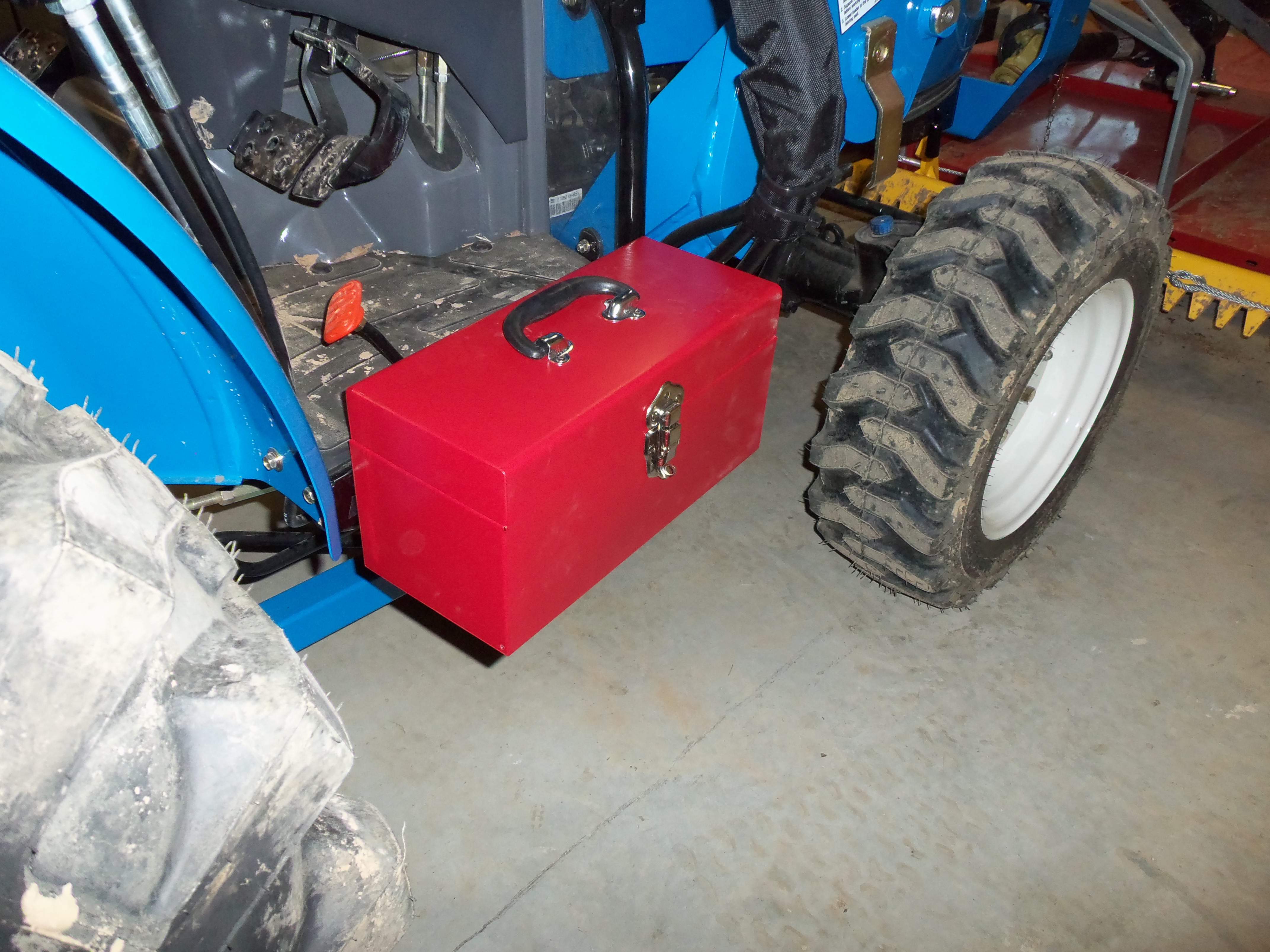

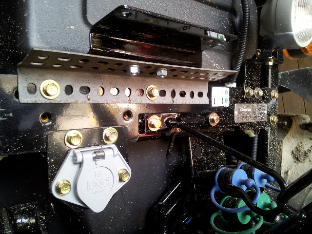

I've seen guys use the NH bracket that goes above the gas tank, but personally was not a fan of that mounting location. I wanted it a bit lower for easier access when working behind the tractor.

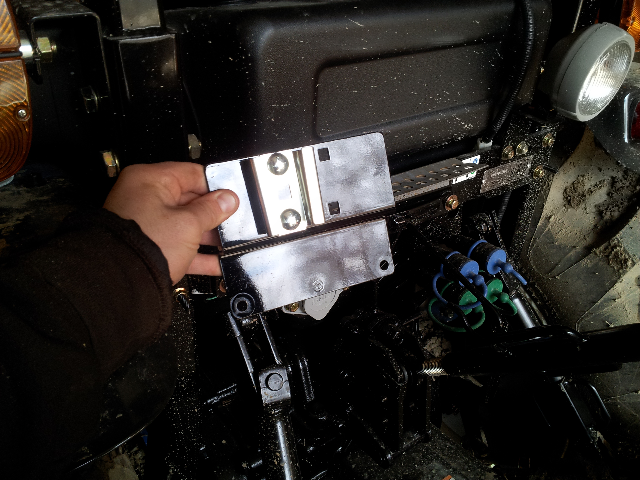

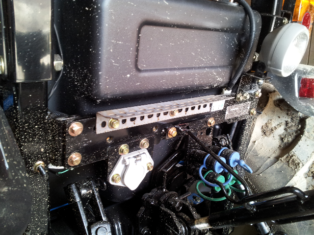

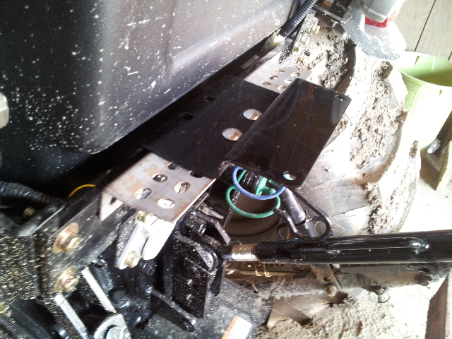

I took off my hazard placard (triangle) and noticed it was a perfect spot for the toolbox. I removed the triangle mounting bracket and bolted on a piece of angle shelving iron. I then reused the triangle bracket for a nice level platform for the toolbox.
I just so happened to have the matching New Holland toolbox which I had removed from my mower, and presto, perfect fit!

Nice job - Looks OEM!

my nh came with a tool box mounted just about where yours is but i been looking at it, my box is not big enough i got to fix the mounting where i can put bigger box. thats a nice nh you have
   / Found a good place to mount my toolbox #8
That toolbox looks good, I mounted mine where the right step was. Good luck on the rehab on your shoulder, I had rotator cuff surgery many years ago.

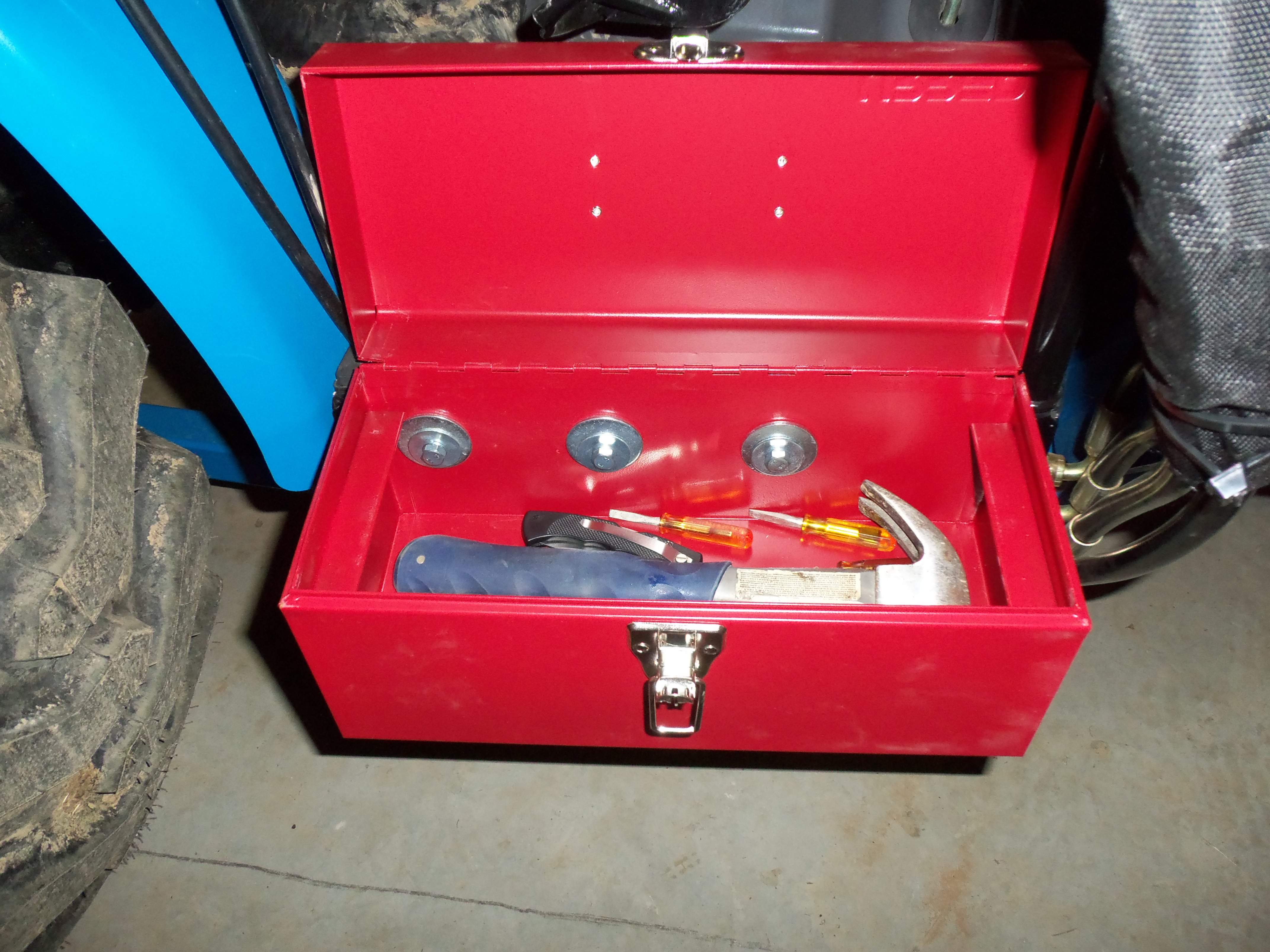

I did it to mine 2 years ago, way helpful when your out bush-hoggin and break a pin or something. I bought a new set of tools for it with pins and hardware etc. Your gonna love it :)
