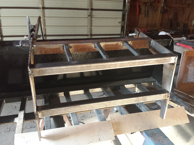

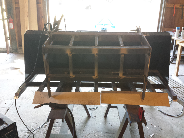

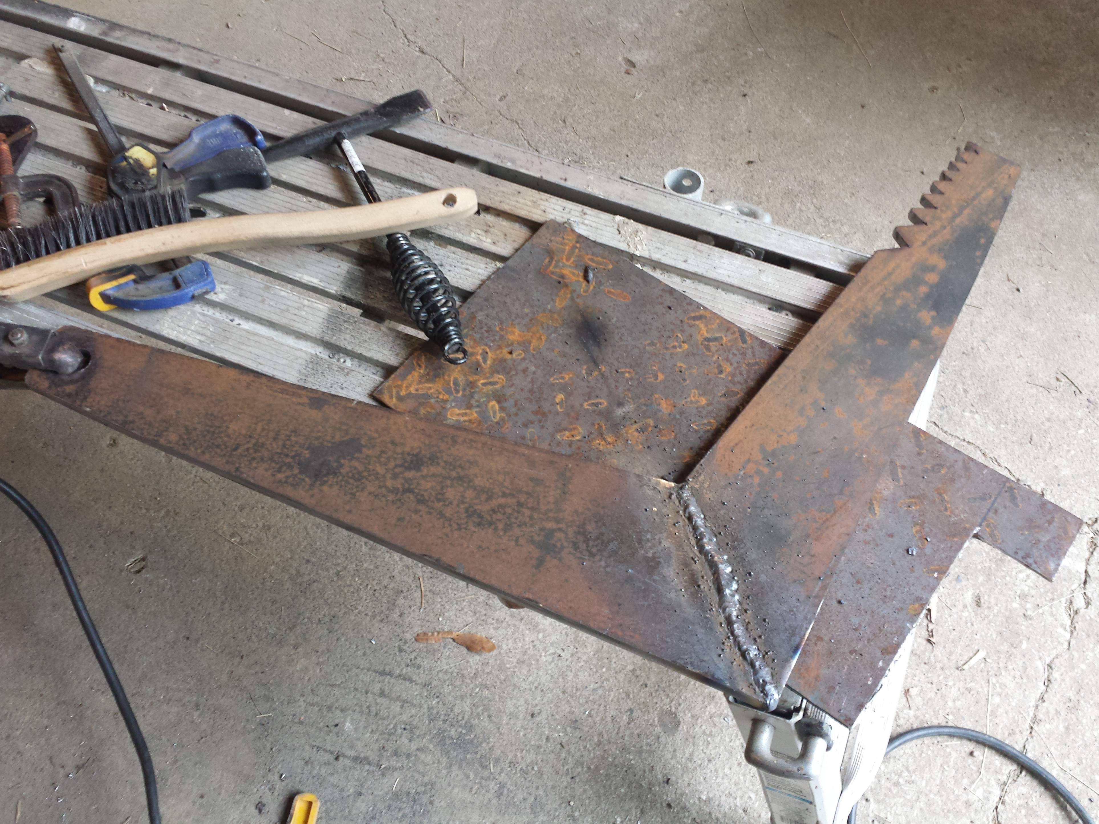

Been wanting a grapple for awhile, but ended up spending the money on other things :mad: ... oh well. So, recently, I found this new 60" Rock bucket on a local auction site, and won it for $228. :thumbsup: I figured I'd either sell it for a profit OR make a grapple out of it. Well, I wen't with option 2, so here's the project so far:
The bucket:

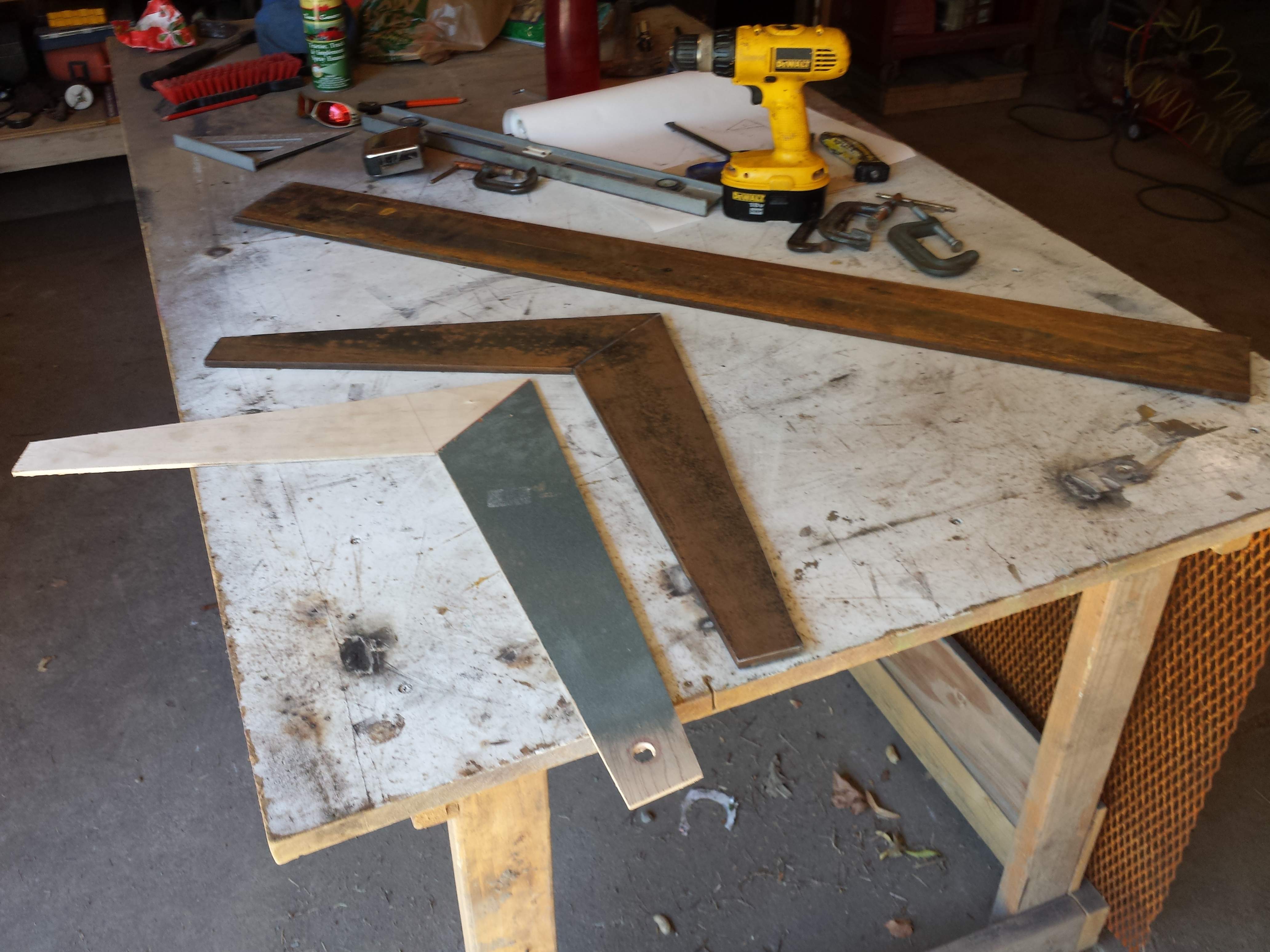

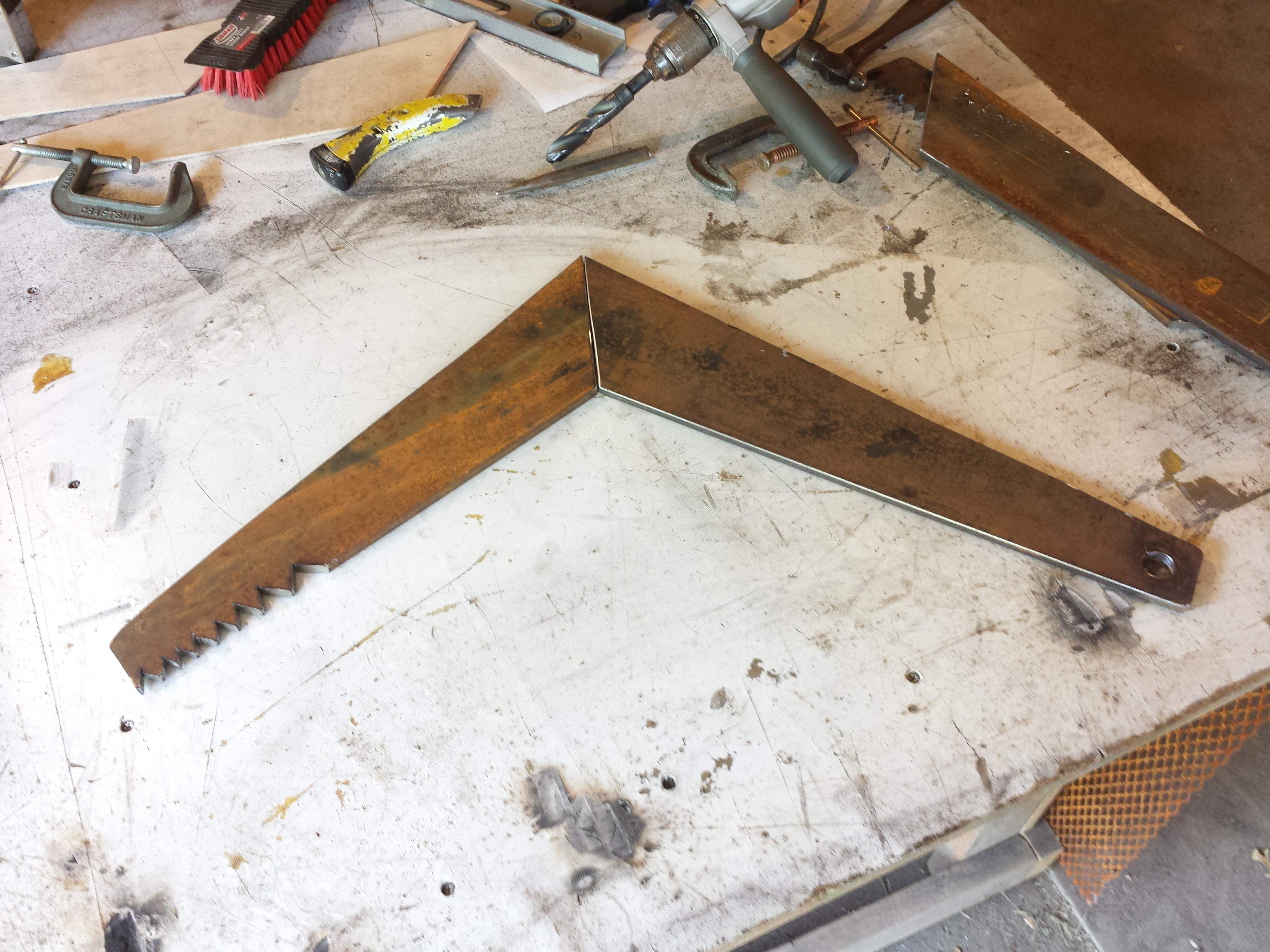

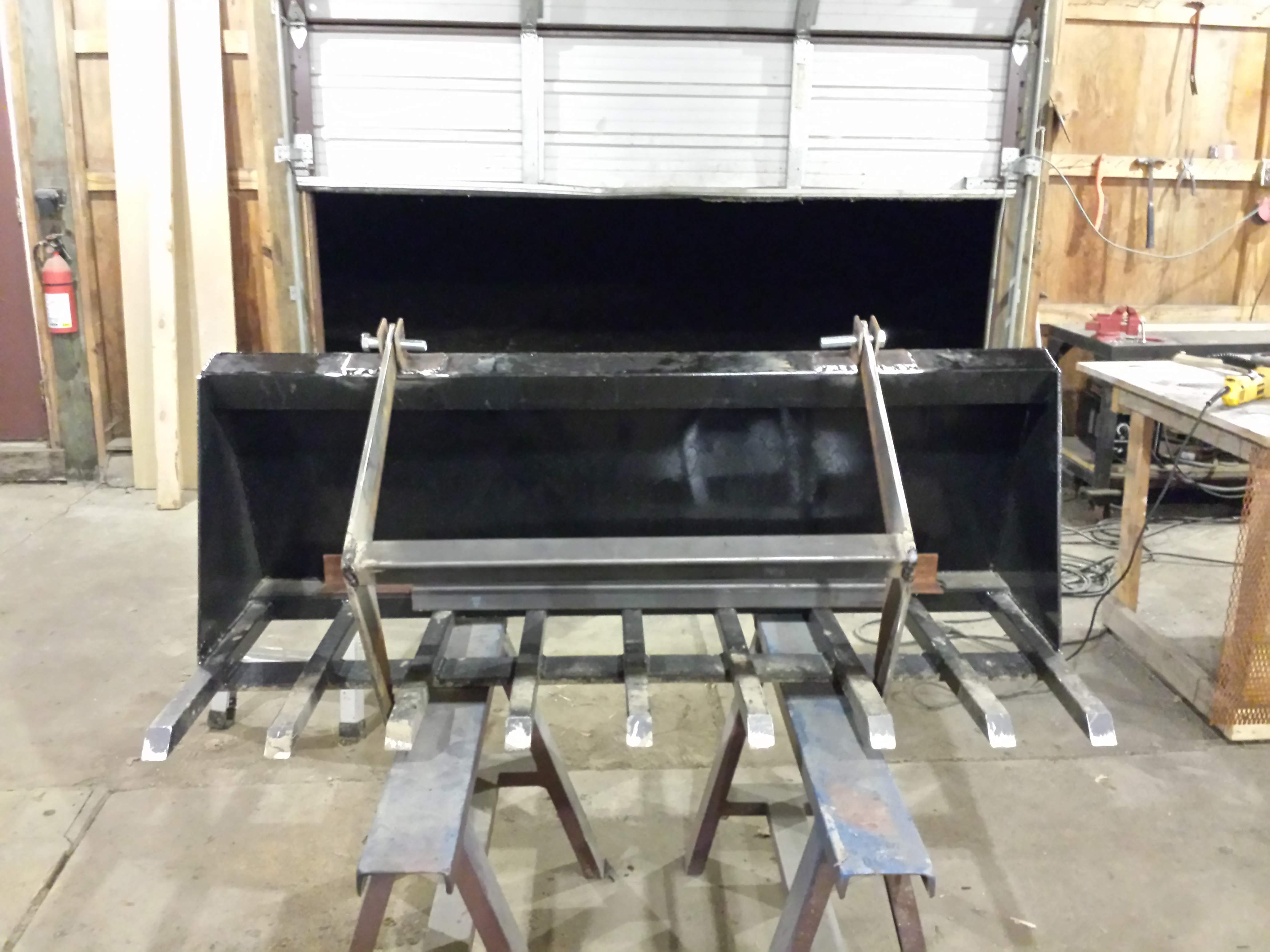

The metal: I picked up all the metal needed for less than $100 from my local metal shop (using scraps & cut-off's like always :D ) The lid/tines are 3/8" thickness steel X 5" width. I cut them to shape and welded them into the proper angle. Added some biting-teeth to them as well.

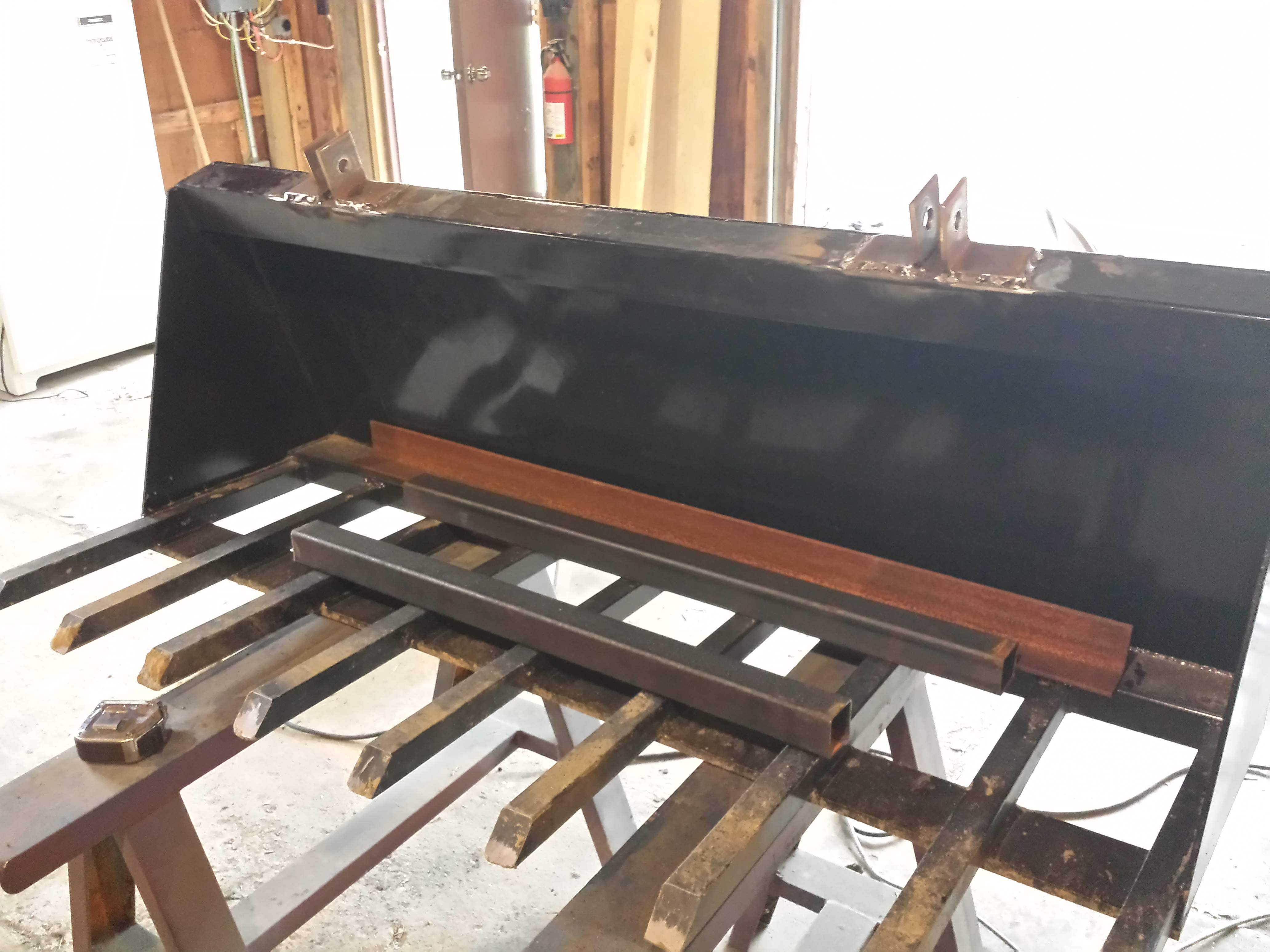

The lid is attached to the bucket with two 3/4" bolts at the pivots. The top of that bucket is 3" tube steel, so it's a good strong base to mount things, although I used some 3"x3" angle iron as the pivot mounts. The lid opens to around 36".
This is the progress so far, but it's only been a couple days so it's moving pretty quickly I suppose. Next step is to fab up the cylinder mounts, and add some more bracing & a center half-tooth to the lid.

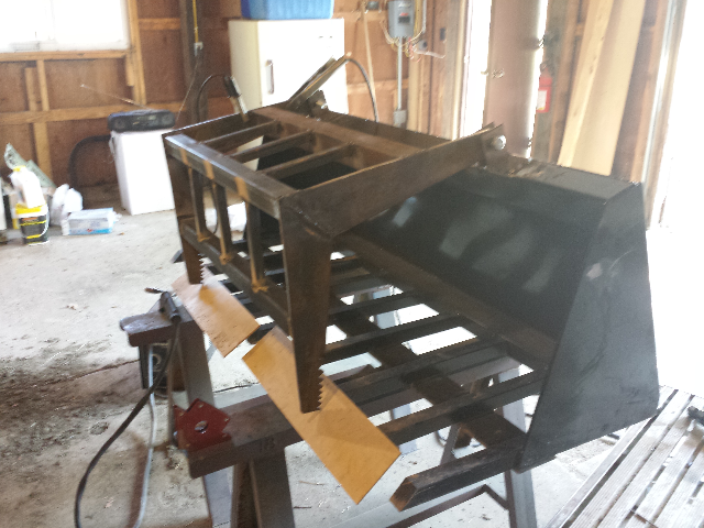

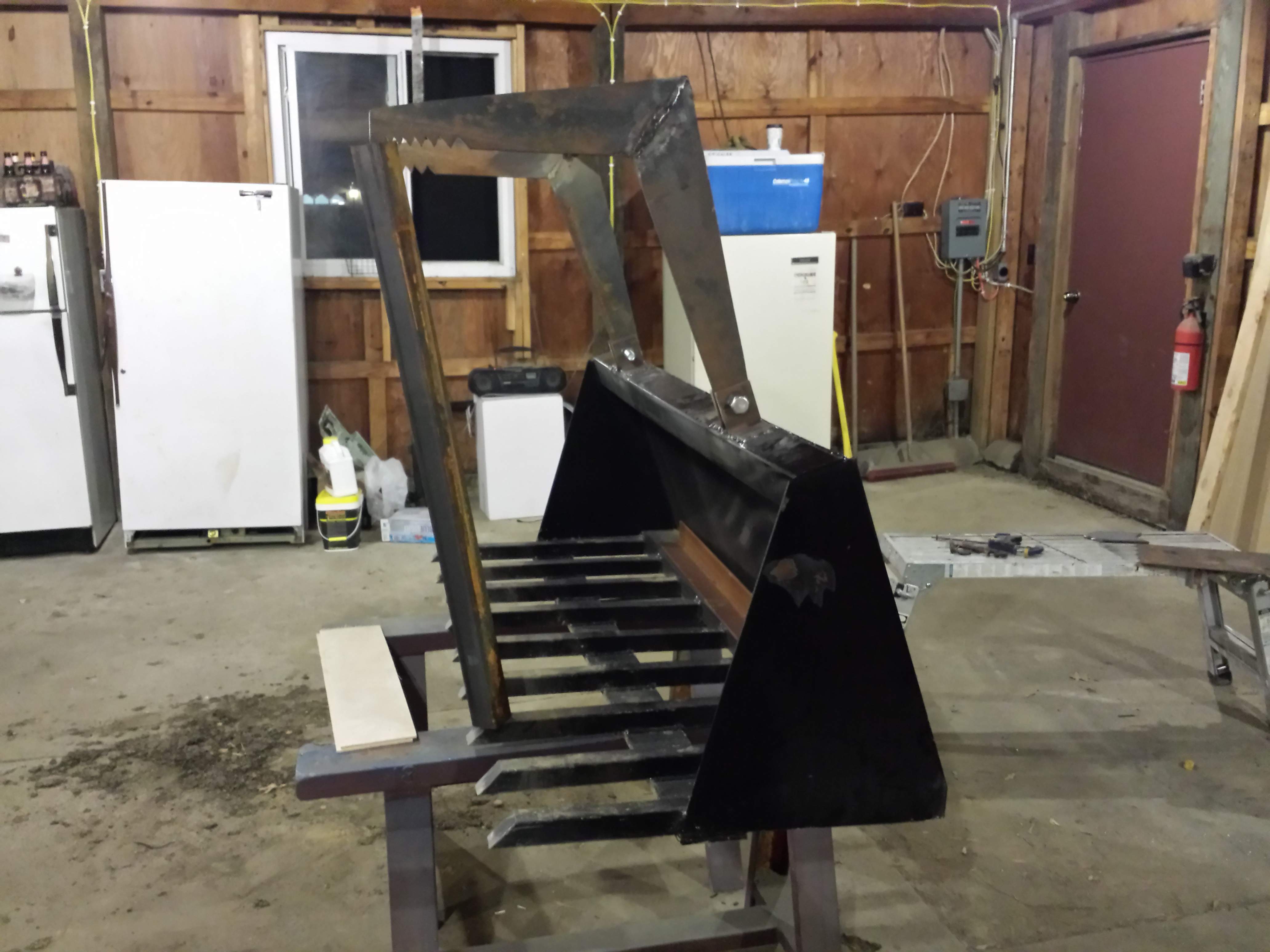

Well fellas last night I ordered a cylinder, it's 2.5" bore, 8" stroke, non ASAE, 2500psi, straight column load rating around 12500lbs. Should do the trick, now it just needs to get here. Luckily I have all the dimensions needed for the pin spacing so I should b able to fab up everything before it gets here.
QUESTION: is 3/8" hydraulic line Ok? They have 4000psi line in long lengths at my local store.
   / PROJECT: Building a grapple bucket for the LS

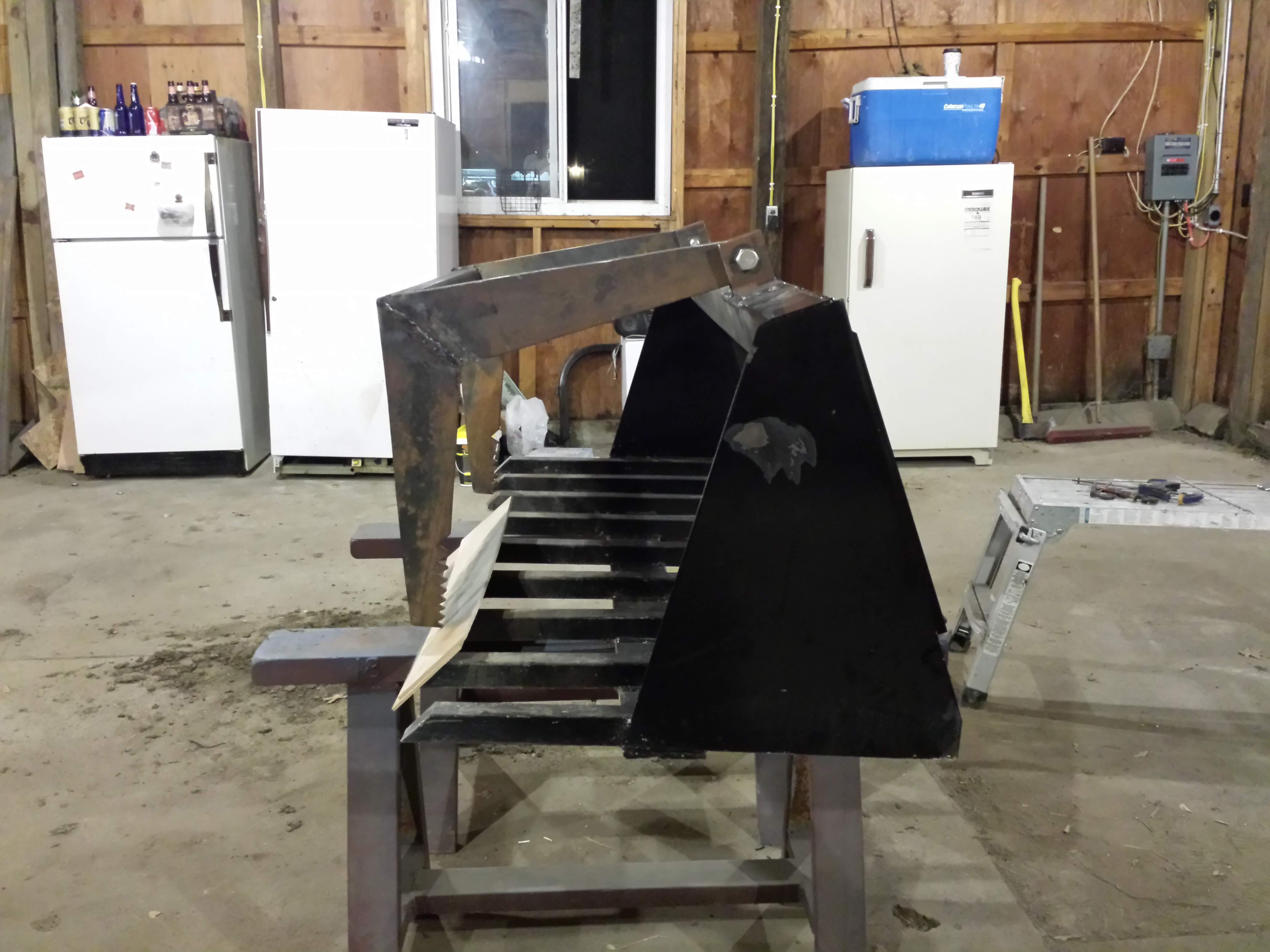

More progress:

Should be plenty. Pretty sure thats all mine has on it, and its almost too fast as it is!
   / PROJECT: Building a grapple bucket for the LS #10
Looks good, it might be a good idea to plate the joint on the sides with a dimond or triangle plate. This area will take alot of stress.
