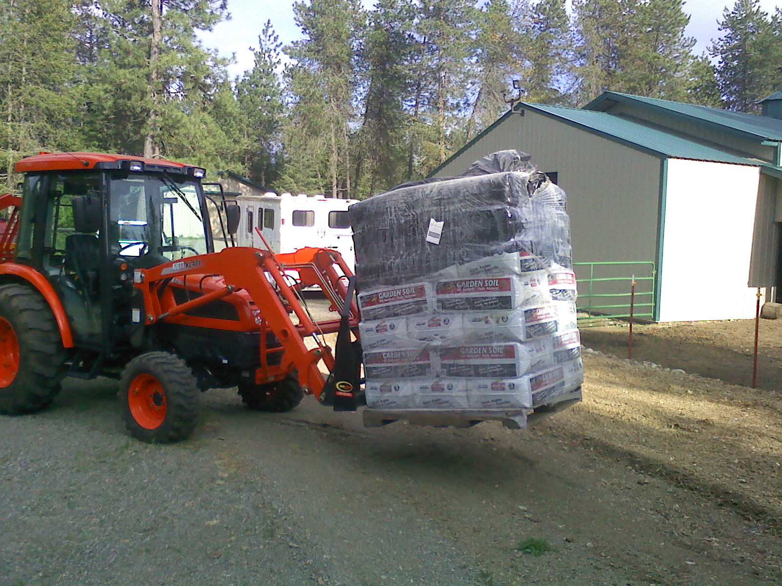

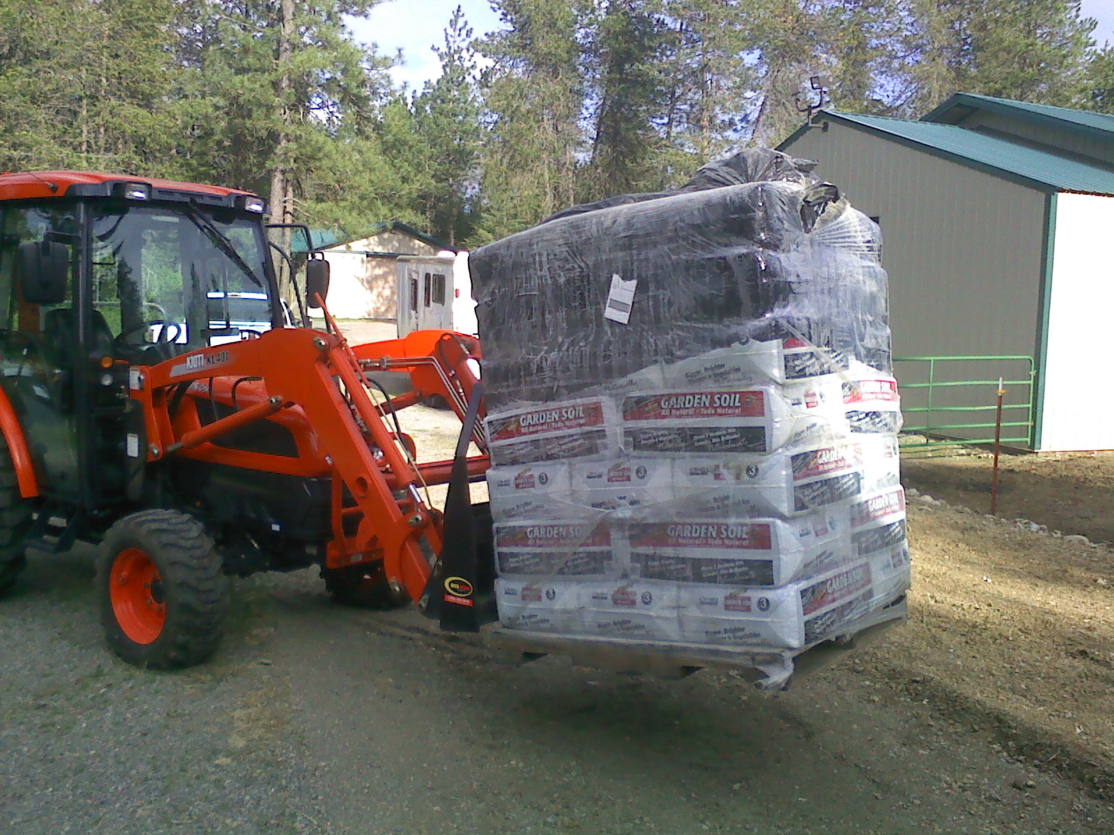

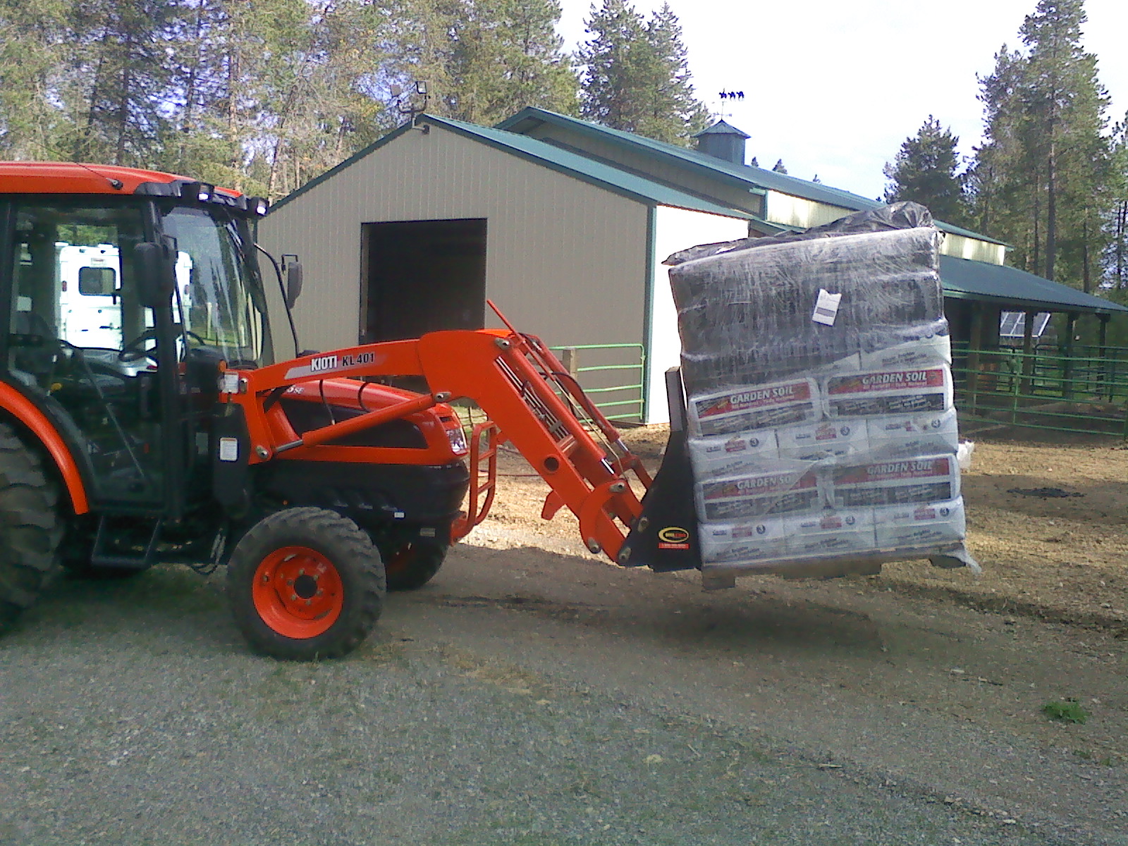

i find the same thing with my DK45. . without added rear weight, i cant come close to lifting max weight without rear coming off the ground. I lifted a pallet of soil conditioners awhile back, and after adding in weight of pallet forks and pallet.... i did reach advertised lifting capacity for my tractor. But i also had to have my heavy brush chipper on the tractor.
this was from my earlier post last year
I had 35 - 3cu ft bundles of top soil delivered earlier this spring I. didn't think about them being very heavy until i went to offload the pallet. The rear end of the tractor started to come off the ground.
So being the nosy person i am, i looked at the bags ... however they did not list a net weight. So i got out my large material scale and weighed 3 bags.
61#
63#
63#
so if i average the load at 62# times 35 bags = 2170 # plus maybe 40# for the pallet and the forks weigh 400 # according to the manufacturers site.
grand total (best as i can tell) = 2,610#.
mind you i had to put the chipper on the back end to help keep the rear wheels on the ground, but dang if this tractor didnt lift what it says it can lift in the advertising. And it lifted it off of a flatbed trailer so it didnt just lift it off of the ground.

I lifted it off of a flat bed trailer, but not full height. i didnt want a ton + of manure over my head LOL
here are a few pics. I got the weight of my forks off off the web site i ordered them from.0525121751.jpg0525121752.jpg0525121752a.jpg
