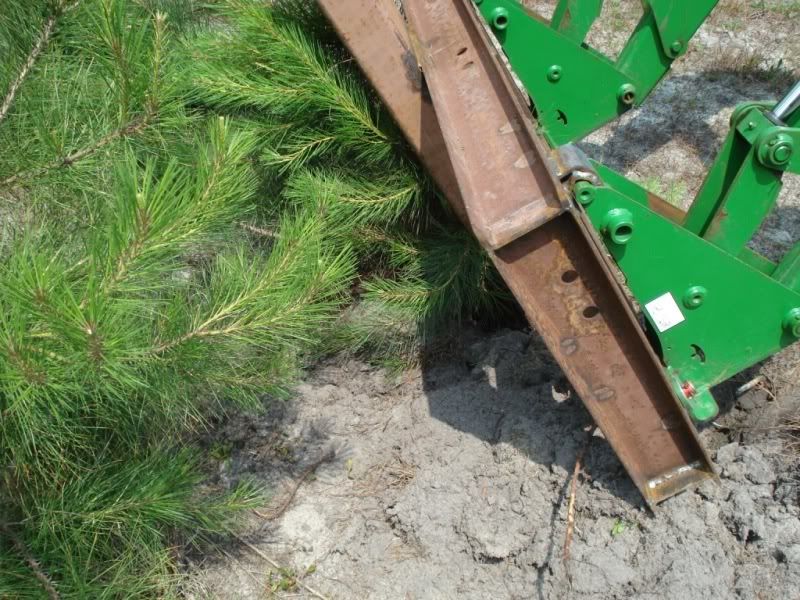

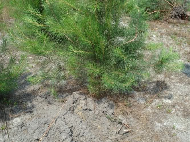

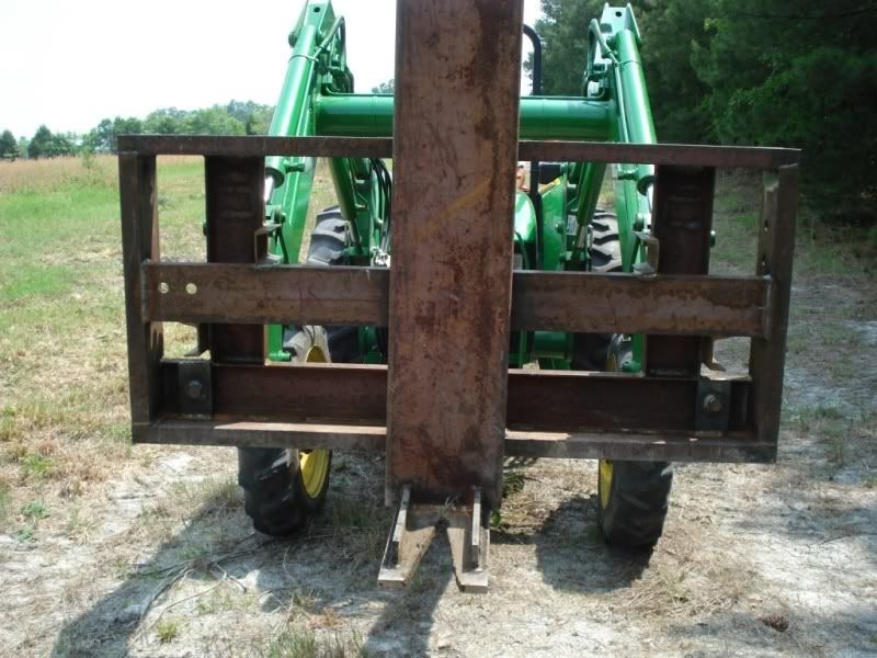

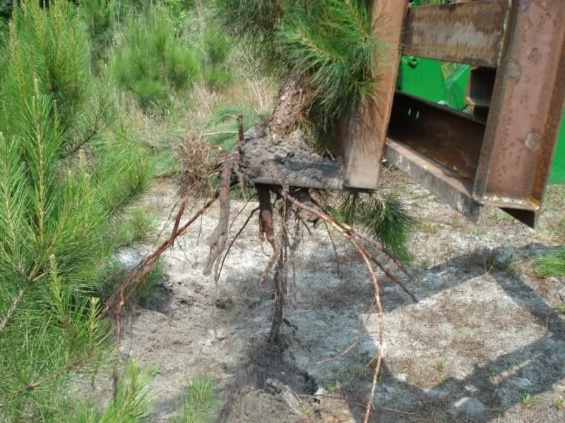

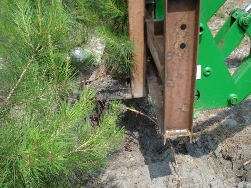

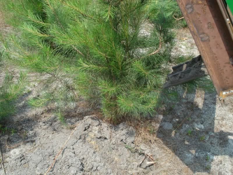

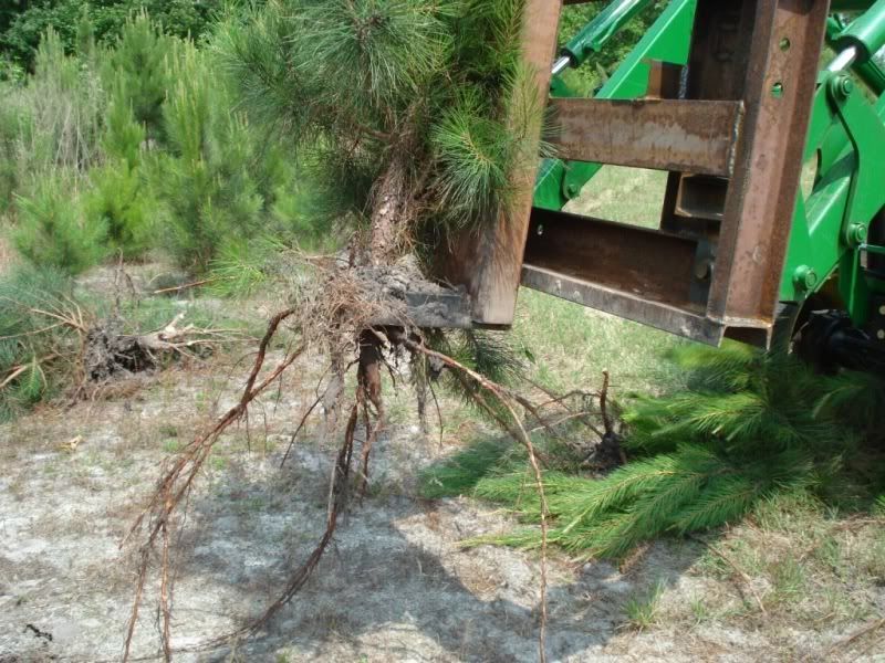

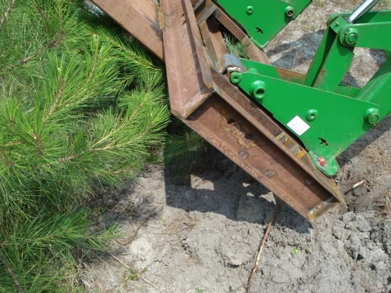

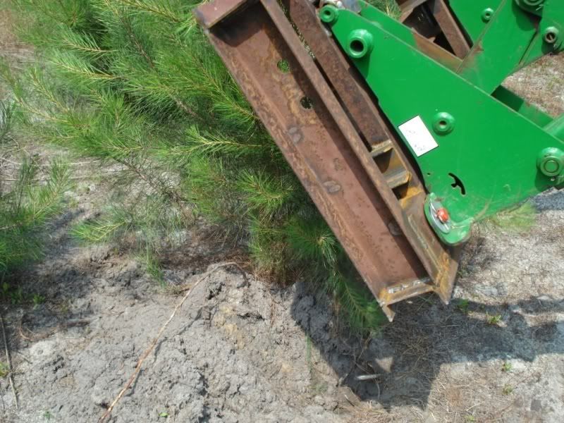

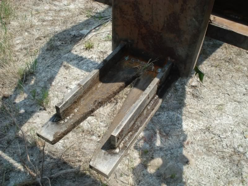

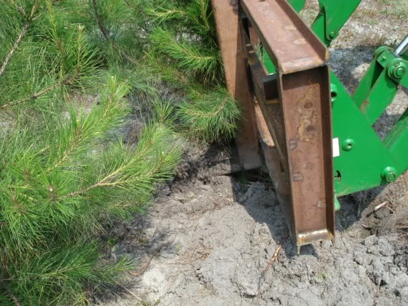

Here is a Tree Grubber that I built for my brother's tractor. He recently bought 25 acres and there are about 5 acres of small saplings/ pines/ scrubs that he wants to easily remove. I came up with this idea from TBN as well as pictures of commercially built units for skidsteers. The V plate is 3/4 inch plate, 4 inch opening at the wide end. The frame is mostly 5 inch channel. The next step is to sandblast it and get some paint on it. It took him an hour or so to get the hang of it, but he can zero in on one and up-root it fairly quickly, much better than a shovel and axe!
Sorry the pics came out in reverse order so you will have to start at the bottom of the pics and scroll UP to see it in action.
-Vinnie

I'm not sure how much lift and curl capacity the FEL has; but it can probably safely pick up 1000- 1500 pounds. It is a model 541 and the specs are listed for lots of movements depending on the position of the cylinders. By design, the V is closer to the FEL arms than the front edge of the bucket when mounted, so I think this gives a little more mechanical advantage to the FEL. Also, by making the V plate only 8 inches wide, this concentrates all the power/ pressure/ umph that is normally distributed accross a 6 foot bucket.
Piloon, I was originally planning to build this for the 3 point hitch so it could be used on other tractors. If it worked out well, I was going to modify it to fit the FEL. I finally decided to just build it for the FEL since it has more flexible options such as the curl and viewing from the front of the tractor as opposed to looking backwards. I could still make this fit the three point hitch with the addition of some lift pins.
After seeing it work, I think you would definitely want the top and tilt hydraulic cylinder in place of a top link. The lift capacity is plenty strong, but the curl function really helps to keep the tree in the V during extraction.
