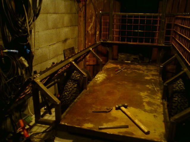

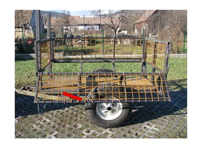

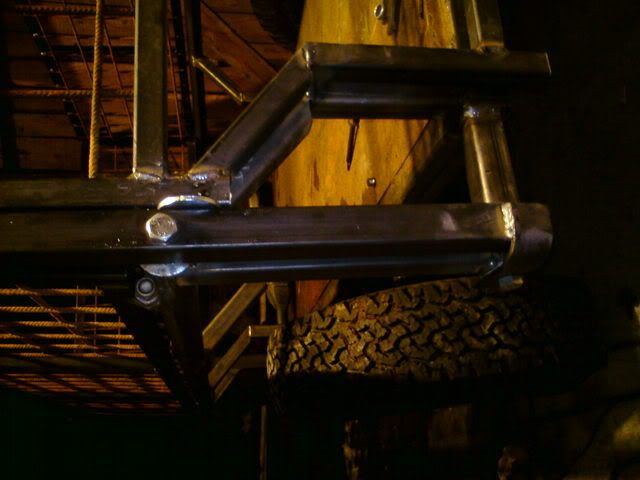

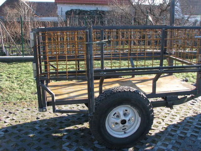

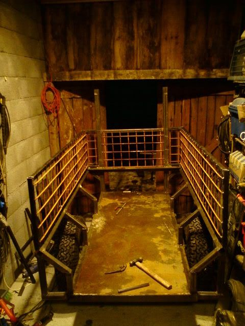

Well, i figured i was not happy with the load volume and the optics after putting the wheels on and narrowing the axle.
So, today i jumped on it again and decided that if i was building this trailer, which i suppose is a 1 time thing, i could as well take some risks if the outcome would satisfy me more.
Here the results:

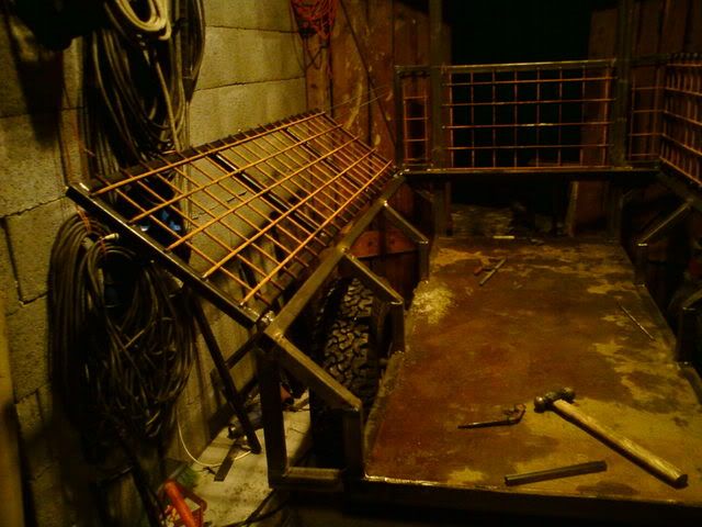

Not the perfect way but i cut out 45 degrees triangles from the original side and folded the whole assembly. Well it worked out.
In the back i added a support which will make a nice light frame also.
The top part of the sides can be flipped in any position holing it with a chain for eg free hay loading, and in the complete down position allows for easier hand loading from the side.
Now still a door frame for the back and the metal plate sides and it starts to look as a mature trailer.
Load volume increased to 2.25m3. big enough for about too much of everything! :p

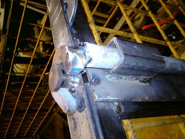

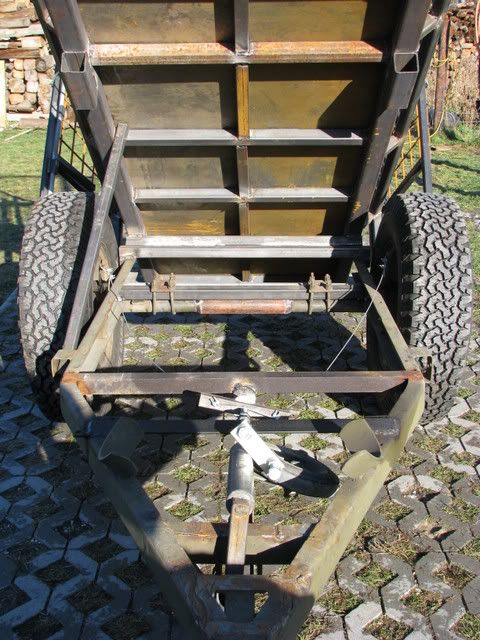

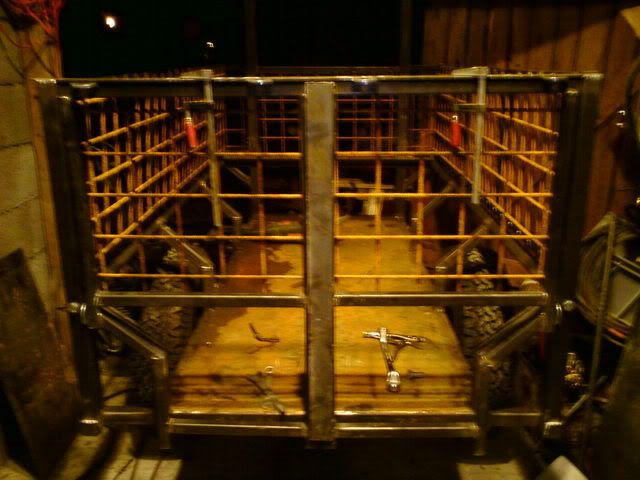

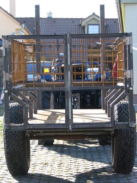

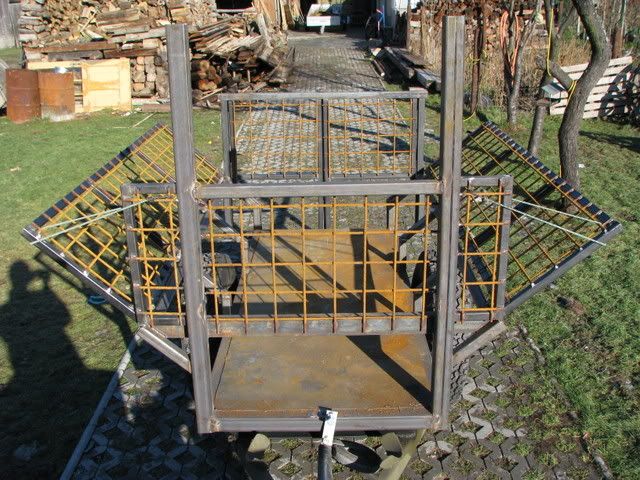

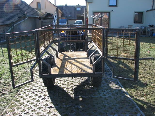

So yesterday i made the doorframe and the doors for the trailer. Just a couple of pics.
The frame is bolted onto the back of the trailer so i can remove it but also in such a way that i can swing it down. With the whole construction being made sturdy enough it must be possible to use the doorframe as a loading ramp for small wheeled things. (wheelbarrows etc)
As closing mechanism i want to use the same principle as found on truck trailer doors. This also reinforces the driving ramp idea.
Going shopping for some hinges and the locking bits for the sides and then still the metal siding.
Hope to be ready with it by the weekend.
edit: I just realized that it is 1 month today since my first post / start of the build. Done a couple of other things also and it was mainly work in the dark hours but starts to be time to have this trailer finished.

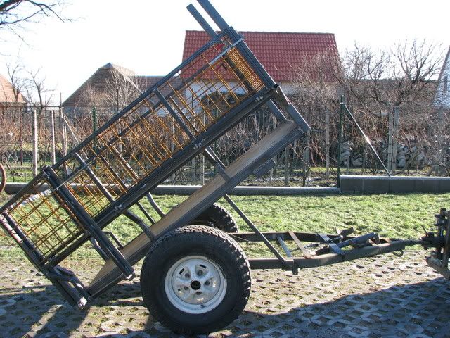

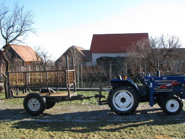

Snowstorm yesterday evening while temps were rising. Today, perfect weather and all looks 'spring'
Time for an outside photoshoot:

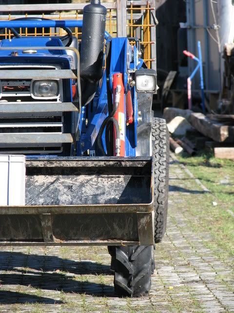

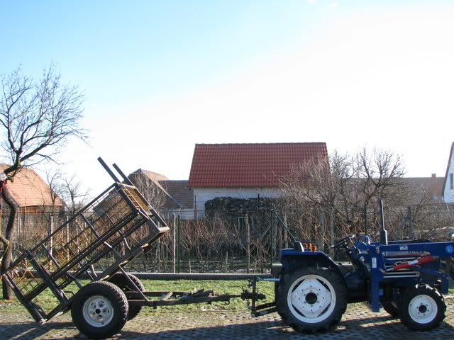

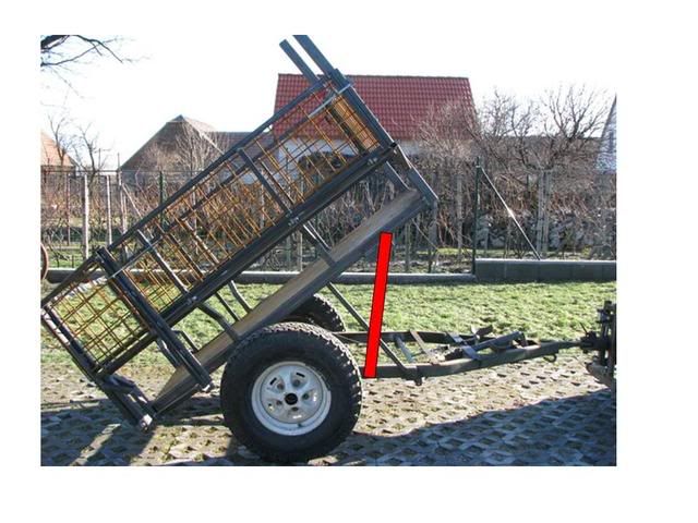

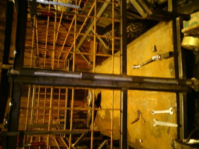

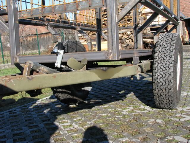

Hydraulics are coming near.
When going for 2 outboard cylinders i would use:
2.5/1.5 400-800 tilt cylinders from the FEL ( and upgrade the FEL cylinders to get more tilt force)
this would give me at 2000psi and an angle of:
20 2x 2015lbs = 4030 lbs push
30 2x 4909lbs = 9818 lbs push
45 2x 6942lbs = 13884 lbs push
going from a 2 ton load and taking in consideration the pivot point of the loadbed i would need 2200lbs to dump.
So i guess i have to find and angle between 20 and 30 (i also presume that the tractor is not giving 2000psi, but have no idea how far off)
Mounting the cylinders is a bit of a mystery to me, Attached 2 pictures showing where and how i want to mount them.
Ideas, remarks?
