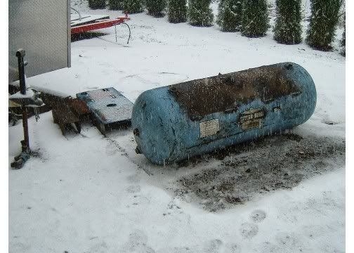

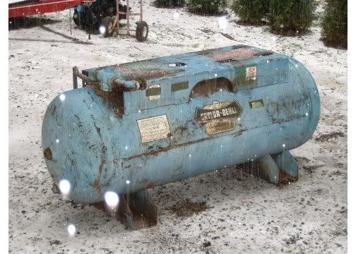

Well I'm adding another project to my list.
I've been looking for a tank for some time now and came across this 200 gal air comp. tank, for $80!
Got it home and cut off some brackets. Then it started snowing so I had to stop.
I still have to clean up some welds and fill some bung holes and then figure out how I'm going to hang some trailer hubs on it.
Once I get the tow bar on it I'm thinking about a platform to mount a vibrating plate on it.

Got some work done on the roller today!
First I took off all the brakes and backing plates and cut the axle in half.
Have you heard the saying "I'd rather be lucky than good"? Well I got lucky, the end bell plug holes on the tank just need a slight hit in four spots with a file and the axle will slide right in!
I then cut an access hole in the side, slid the axle pieces into the tank and clamped them with a piece of angle iron.
I rigged up some straight flat plates across the hubs so I could measure the alignment. I tack welded the axle in the center and then unclamped it and moved it around till the alinment was as good as I could get it. This took a fair amount of cut and try.
Next I notched some 5" chanel with the hot wrench, to pick up three of the lug studs. I know it looks crude, but its not high speed or anything so it will be fine. I bolted them on the hubs, cut small slices in the chanel, heated and bent the chanels to almost touch. I dont have my ring hitch yet so I tacked a piece of steel to hold the chanels till I get it.
