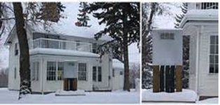

Air Intake of Earth Tubes
It will come out of our slab in the pole barn house like in the photo below.
I would also have a door on ours so I can turn it off if not needed. We would probably only use the earth tubes in extreme weather.
