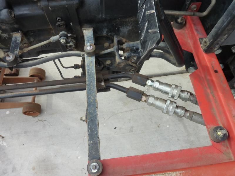

I'm looking for a bit of help. I have searched and found quite a bit of info but want to make sure I get this right.
I would like to add a top and tilt to my Yanmar FX28. I have a loader on it and will post pictures of my existing set up.
this is a picture of my loader valve, I'm thinking a power beyond could go in the top port which is not being used?
The hydraulic lines to the loader valve come from under the right foot rest. there is an on/off lever under the seat that controls the flow to those lines. I'll add some pictures here. This where those two lines come off.
this is where they end up under the right foot and connect to the loader lines.

How is your flow path? Point to point.
Is it from the pump to the loader then to the 3pt?
If the loader valve is feeding the 3pt now, then you can assume that the loader valve has a PB port.
Do you have six or seven hoses on the loader valve?
If you have PB coming to the 3pt now, then you can interrupt the flow at the 3pt for the remote valves for the T-N-T.

Flow path, I'm not sure, on my last picture that is the line from the hyd pump. On my second picture you can see that same line has well has the out and in lines that go to the loader valve. If I had to make a guess it would be pump-loader-3pt. if I did not have a loader the lever would be off, thus eliminating the two ports on the side that go under the rt foot and up to the loader.
There are six hoses on the loader valve. The top of the valve has a port which is not being used and I thought that would be a spot for the PB.
I'm sorry if I have not explained things well. and thanks for the help.
