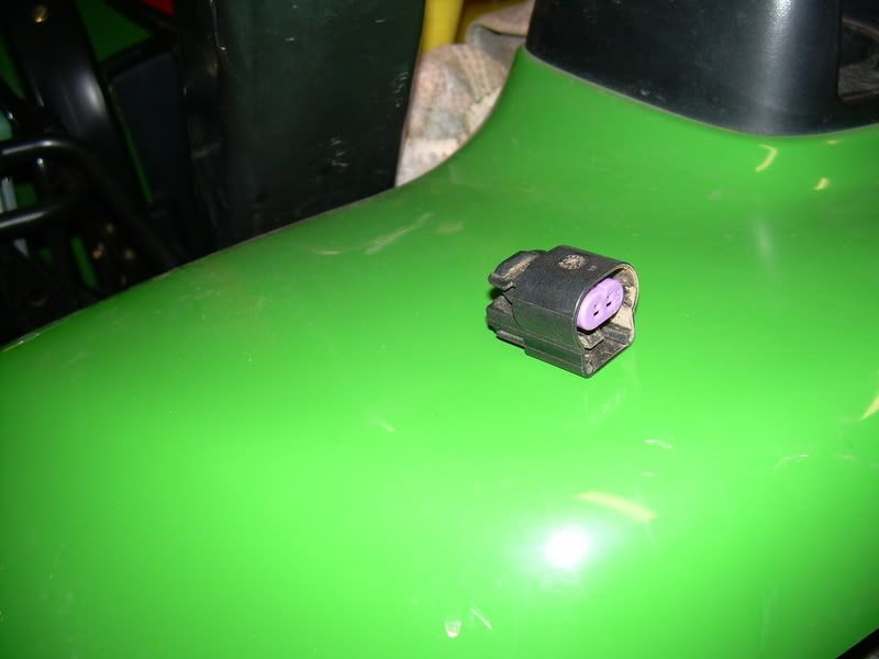

I now just want to do it as simple as possible, I found this nifty little piggy back fuse thing that lets you get an extra circuit out of an existing one with out overloading the existing one. The problem is that I don't want to mess with any important circuits like the main or the hydrostatics even though this thing is supposed to be safe to add an extra 10 amp draw, the non essential circuits (tail lights & work lights) are not hot even on the line side unless they are switched on. the only space on the panel that has 12 volts on the line side when key is off is #2 and #4, the unused #2 space (it's a 30 amper) says trailer option, which I would like to find out more about, is there a plug in the harness in the back somewhere that I could use to power my outlet? The #4 space says "never used" and has only one terminal in the line socket, nothing in the load socket, would that be ok to use with my piggy back thing? The #12 says do not use or tranny will be disabled, all the other spaces have no terminals in them.
I did find a capped plug like socket on the back of the harness which does have a ground, but could not get power to it when I put a fuse in the trailer option space.
Any help will be appreciated, does anyone know how to get a full wire diagram for the 4310.
Thanks John,
Here are some pics to help.
This is the piggy back thing
This is the socket I found on the back, anyone know what's it's for?
This is the thing that was plugged into the socket

Not sure about your fuse box, but have the same outlet out the back on a 4720, figured it was for a baler or trailer lite hook up. The last item looks like a dust cover for the outlet wiring.
Found out today that's for a back up alarm, there is a trailer option in the fuse panel that also requires a relay, then an optional 7 pin power socket that has to be all spiced into the existing harness in the back, it's only like $50.00, I guess it's for all the light functions on the back of the tractor.

If your 4310 is the same as mine, I have the trailer wire harness taped off under the seat. It took some digging to find it but it was there . If you don't already have the work lights on the back of tractor, there are two hook up wires on both sides you might be able to use. I found them on the right and left side by the base of the roll bar (in the same area as the back up alarm). And I highly recommend getting a copy of the service manual. It has every thing you would ever need to know,it is worth every penny.

Yes it's under the seat its' just the raw end. For the trailer hook up they want you to buy the plug kit from JD. I wanted to see if anything in it would be heavy enough to run a sprayer. You might be able to find out more on jd's web site under the parts section they do have good schematics. If you haven't already.
