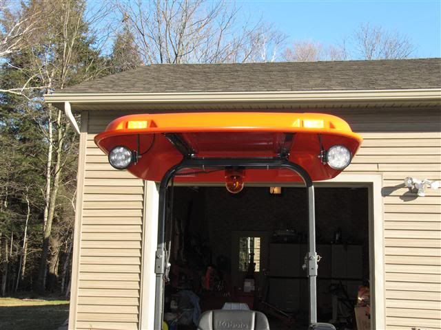

I did a lot of searching for lights that I felt would give me sufficient lighting, yet put a reasonable load on my B3200HSD electrical system.
Thanks to some folks on this forum, I got good pointers to some LED lighting that looked perfect for my application. Thanks to "SpringHollow", I purchased the 18W (~1.5A) LED lights from the following site:
autolumination.com
The lights can be found about 1/2 way down this page. Here are the specs:
LED Power: 18W
. Operating Voltage: 10-30V DC
. Luminous: 1380Lum
. Waterproof rate: IP 67
. Current draw 1.4A @ 12V,0.70A@24V
. Optional Color: Black
. Color Temperature: 6500K
. Material: Diecast aluminum housing
. Pmma lens
. Beam: Wide flood beam pattern
. Size: 128mm*116mm*43mm LED Power: 15W
. Luminous: 1380Lum. Waterproof rate: IP 67
. Current draw 1.2A @ 12V,0.60A@24V
. Pmma lens
. 18 Watt
For the switches, I chose to use marine switches that are waterproof and have a light on them that indicate when the lights are ON.
For mounting the switches, I chose to use the blank plate that is on the plastic housing on top of my right tractor fender where the 3-pt hitch controls are.
Since these are only 1.5A each, I was able to tap into the already wired and fused bullet connectors that come with the tractor....these connectors were on the right hand, rear side of the seat and were strapped to the std wiring harness with electrical tape....I show a picture below where that is located.
I am EXTREMELY happy with these lights and I am very very picky.
Here are the results:

Thanks for the compliments, guys!
I thought about using the turn signal switches for the front/rear worklights since I really don't use them, but a couple of items kept me from going that route:
1) Tractor still under warranty....didn't want anything to potentially be an excuse by the dealer not to fix under warranty, so ran my own circuitry
2) The dashboard is a challenge to try to remove....I tried it (even removed the steering wheel). but the engine speed control knob created a hangup and I wasn't gonna mess with it any more :D
3) The blank plate created a good opportunity if I screwed up the cutting of the holes....I could simply order a new blank plate and start over. A relatively cheap security blanket.

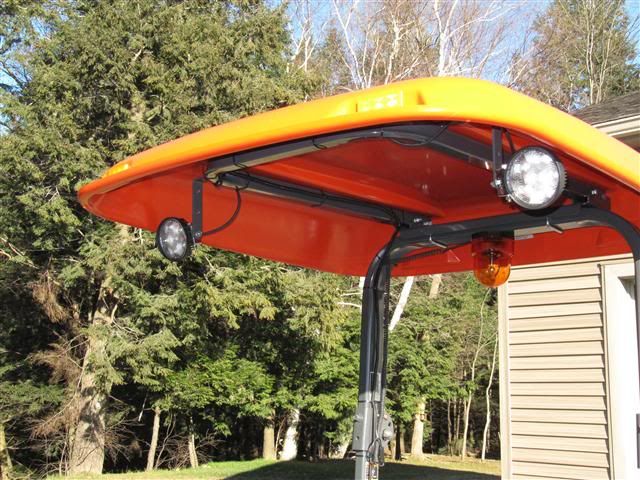

I also didn't show a picture of how I mounted the lighting. I mentioned before that I took a 90' bracket, rounded one end with a sabre saw (using sheet metal blade) and dremel tool, and attached it to one of the existing bolts that are used to hold the canopy on to the support bracket. I used the Rustoleum Charcoal Gray Gloss Enamel spray paint (found at my local Home Depot) to match the ROPS color.....I'm happy with the match - the flash of the camera makes the ROPS look darker, but in person it is pretty close in color! Here's a pic:
Another item, that was a secondary surprise, was that because of where I mounted the lights (a tad back from the edge of the canopy) I can actually see my entire instrument panel with the factory tractor lights off.....the pic in my original post, where I'm sitting in the seat, shows how well the dash is lit up......this was a much appreciated side effect of where I mounted them.
To answer the question of where I got my marine switches, I went to a store called West Marine (we have one local). Were I to do it again, however, I would have looked online for a better pricing.....these things were quite expensive (~$20 a piece) at the local shop and I know you can get weatherproof switches much cheaper than that online. I was in a pinch for time and needed them during a certain window I had for installation time over the weekend, so I bit the bullet and bought the only ones I could find in town.

I'm certainly happy with the spread pattern of these lights. I had never seen these in operation until I received them in the mail, so I was basing my decision on what others have posted on these forums....I'm extremely happy with their light output and beam pattern.
