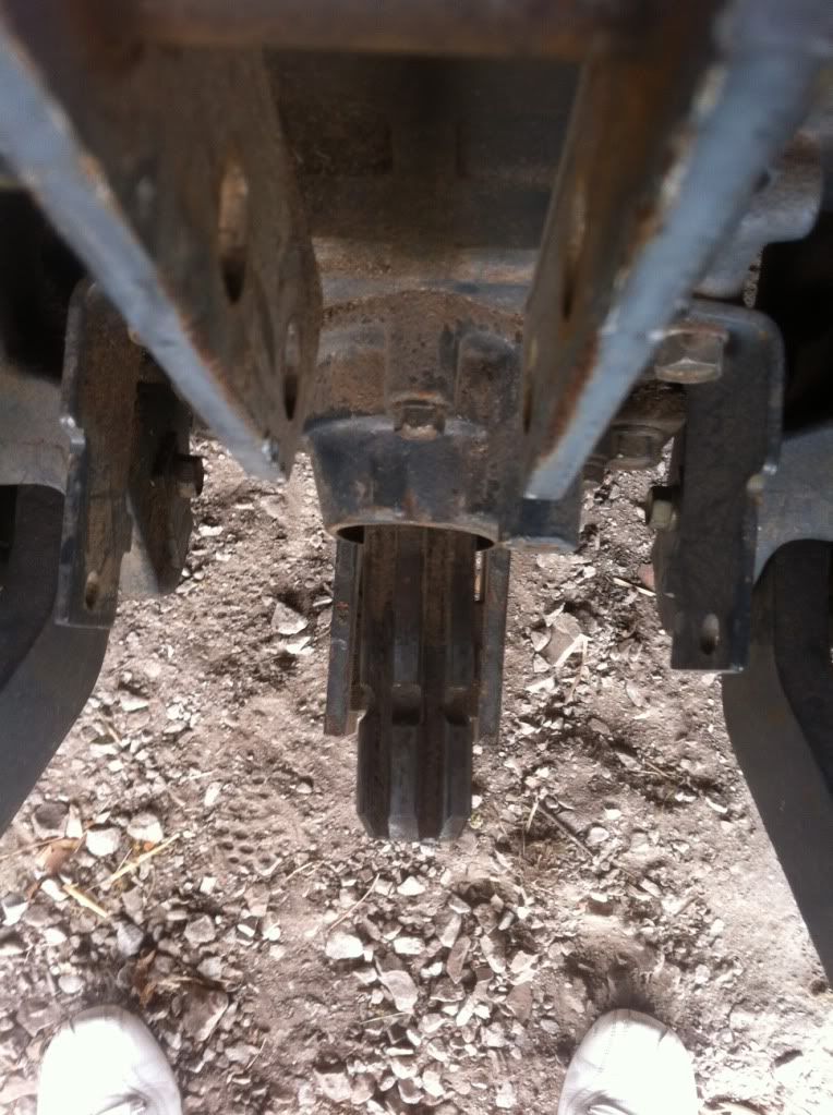

Well, I've had better days. I borrowed my dad's tiller to till my garden, and it has a teensy tiny short little pto shaft. I hooked it up to my tractor and it would barely stay on. I lengthened the top link and it tucked it in a little. It worked for one row, then right when I got comfortable, the shaft came apart, spun around, stuck on my side link and stalled my tractor. I decided not to push it any farther (too late!) and took the tiller off. That's when I noticed oil coming from beneath my pto shaft on my tractor.
I engaged the pto and it spun, but it sounded like it was wobbling around, and sure enough, it was.

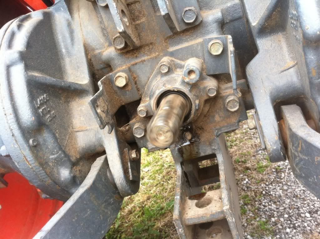

It's a little hard to see, but the shaft is bent and there is/was oil coming out.

Man, what a pain. But don't worry, real men break things all the time. It's just natural. You can keep borrowing the tiller, just buy a longer pto shaft to use with your tractor. It's cheaper than a tiller by far. The pto shafts that I have had apart for new seals were pretty simple. Some one will chime in on your tractor soon, sorry I can't help you here, but I don't think you have to worry.
   / Broke my PTO shaft #3
You're just a 'farmer' trying to save a buck. :) Happens.
Most of your troubles should come out with the shaft by unbolting the 4 bolts around the pto. Hope it didn't hurt any internal gears, and shouldn't be too bad on parts and labor.

Always make sure your PTO drive shaft is the right length. Unless you want to learn the $1200 hard way! (I chose the hard way)
The good news is I'm also getting my 400 hour service done included with that price, so when I get my tractor back in a week I'll be good to for a long time, provided I don't break anything else!
