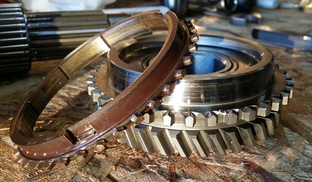

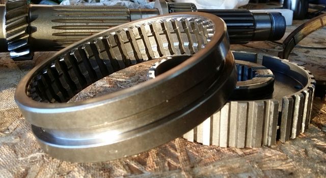

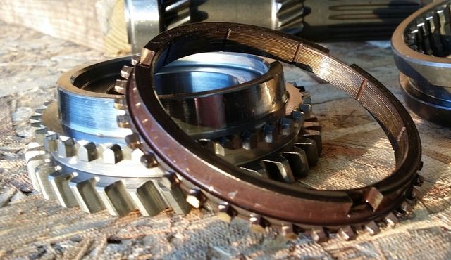

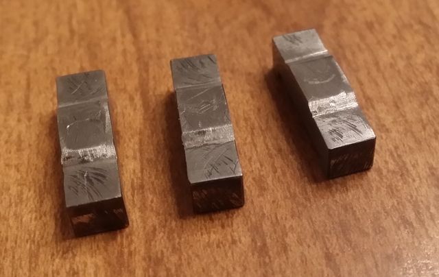

Took the parts to work today and we definitely think the issue is in the splined gear / collar assembly. There are virtually no signs of wear on any parts except for the three keys. If you assemble the gear pack without installing the 3 keys in the inner gear everything slides butter and aligns like perfectly. Put those keys in and things get real tough.
The one/two and three/four gear packs slid much easier. The fwd/rev pack has a much heavier spring clip but I think it is mostly due to the keys.
We hit the keys with some 280 grit and then I tried polishing them with a diamond stone. They are much smoother (there were some slight ridges in them) but they still have some deeper marks in them.
Reverse gear and synchro
Inner and outer splined gears
Forward gear and synchro

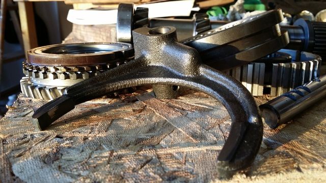

The shift fork shows some light wear. The other side has an equivalent amount of wear but on the opposite side, possibly indicating a misaligned fork. Miss-alignment could be due to a bent fork, bent linkage , or out of tolerance machining in the transmission casting. Nothing is readily apparent.

From what I see in your photos, the keys look to be right up there as an issue. They look pretty hammered. No interference to speak of between the shift collar and the inner hub? Only one photo(the bottom one) shows a synchro ring installed on it's respective gear. That looks about right, position wise, but hard to tell from that distance. Looks to me that the keys may well be the biggest problem. As for replacing just the keys --- your money, your call. They always come apart faster the second time.

The book states a .031" minimum clearance between the synchro and ring gear. I have over .050 on the forward gear and over .060" for the reverse.
There is no interference sliding the collar over the hub without the keys. For the price of the keys and the time it took to get here, they are getting replaced.

So, an update. I filed/stoned some light burrs on the gears of the sliding collar and replaced the three keys 2 weekends ago.
Everything worked fine after that. I've mowed 20 acres in the last 2 weeks with no issue. I got the transmission up to 160 degrees with use.
