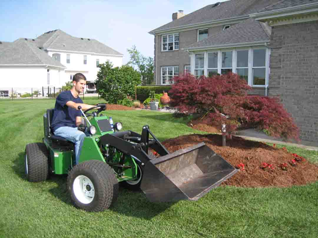

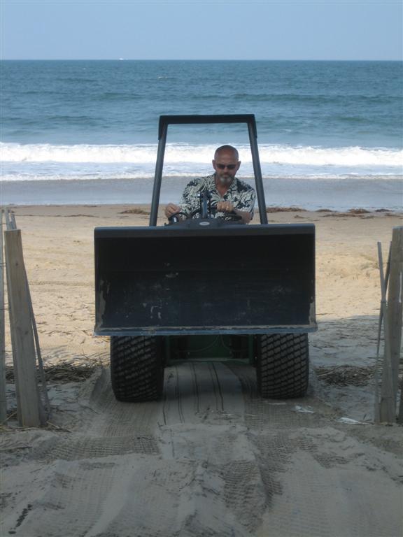

Hi Dave,
The big tires are very good for sand work on the beach. They work well on soft lawns as well. However, I think that the stock tires would probably be as good for lawn work. Stock tires would result in a nice price savings too. This machine won't tear up the lawn. Moss is right on the tracking. We move a lot of mulch with no lasting imprints. I keep the big bucket on all the time and fill it to the max.

Thanks again guys. For the work I do I'm sure you are all right, that functionally and for money reasons the stock tires are the way to go .......as cool as the big tires look:cool:
