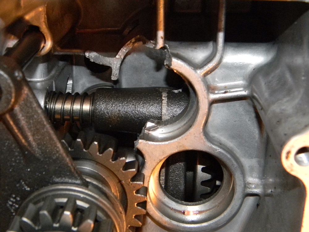

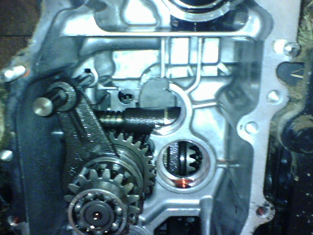

I have continued this posting from a previous one that was getting quite lengthy, the purpose of this thread is to share and gather information on a John Deere 2305 rear PTO failure and transmission housing repair and to seek knowledge and support on a class action suit against John Deere and gather fellow disappointed 2305 owners for this righteous pursuit.
See pictures of this catastrophic failure attached at bottom of this thread...
Here is my posting from back in May 2010 from the previous thread...links to the old posting and another one like it attached below....

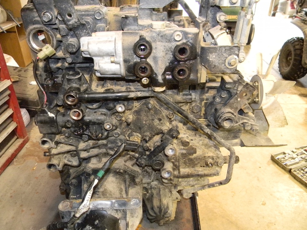

Unfortunately I found this posting and many like it all over the web on how the John Deere 2210 and 2305 has had catastrophic rear PTO failures and problems. The reason I am here and writing this is to join the increasing number of dissatisfied consumers of this tractor. Same situation that I am finding more and more by searching the net and talking to other 2305 owners,tilling or bush hogging, hit something where slip clutch doesnt disengage for one of many reasons (load not significant enough to cause clutch to slip, froze up from rust or paint, etc...), and rear PTO housing gets completely destroyed. I took this immediately to local Koenig John Deere dealer where purchased 3 years prior, only to find out 2 days later, they have seen this exact problem before and my bill is over $6000. $3300 of which is just parts. And wait, it gets worse. Service manager at this dealership tells me this is a known problem and JD has since "beefed up" this transmission housing to prevent this problem. I was in shock! I took my broke 2305 back home to evaluate it myself because i couldnt believe they were correct. After 45 minutes of removing parts to get into the rear transmission, my nightmare came true. The thin, badly engineered cast aluminum housing gave way. How JD ever expected the already brittle cast aluminum metal(only 1/8-1/4" thick on outer wall) to withstand any torque at 540 RPM under a load is insane. And the kicker of all this is, their redesign of this is the only parts offered, so the remaining pieces i could have salvaged that were not destroyed are trash, and i have to completely replace ever part in the rear housing on my dime. This tractor is warrantied for 36 months on the drivetrain or 2000 hours. Of course my tractor is 6 months out of warranty and has less than 300 hours of total run time, of which only a few hours of use on the rear PTO. A supervisor from JD is supposedly going to get back with me in the next 48 hours to discuss, but my hopes are dwendling of getting them to help I will keep you posted as to how they handle this situation. If it turns out to be negative support from John Deere in helping owners of the 2210 and 2305 to repair their machines, i would like to know if any other members on here are interested in joining my lead in a class action lawsuit against them. Thanks
Supervisor from John Deere called me back today. She first said that "With your tractor being 2 years out of warranty and with 600 hours on it, we can not offer you any assistance." I then had to inform her that both of those statements were false. My tractor has 200 something hours and is only 6 months out of the drive-train warranty. She had already made up her mind and insisted that there was nothing John Deere would do. Is this the type of service and quality that most John Deere consumers are subjected to? I am working my way up the ladder trying to get some assistance on this matter.
Long story short after hours and hours on the phone with dozens of different John Deere managers and customer service representatives, including the territory rep here in southwest Ohio, John Deere didn't lift a thumb to help me on discounting parts or labor for this repair. In the end, the owner of the dealership where the tractor was purchased, gave me an 18% discount on parts, mainly to just get me off his back. After an exhaustive battle for almost 3 months, and without my front end loader and mower (manure piling up and grass getting high), i gave in and bought the parts at the discounted rate. It took 4 friends and myself working very hard 1 whole weekend and 5 nights after work repairing this transmission. Attached are pictures of the flaw and repair. Note: The new transmission that replaces the old has an bearing wall thickness nearly 3 times thicker than original design. What a nightmare this has been.
