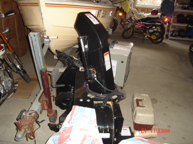

When you say "chute deflector" that's the linear actuator that controls the top of the chute, yes?
So far I've had no problems with it --that I've noticed-- but that sounds like it could become an issue pretty easily; thanks for the tip!
One thing I do after blowing is to park the beast in the driveway facing the sun (assuming there is some...) to melt off any accumulations before putting it away. As my 2360 is black, if there's any sun at all, it melts off & dries pretty quickly.
My 2360 is about to enter its 4th winter; tractor now has about 190 hrs. Looks like it may get some work this weekend....

We had a warm day today so after lubricating the chain I pulled the chute deflection actuator for disassembly. Removed the 4 downward facing allen screws around the actuator and the one upward facing screw pointing twoard the motor. The bottom case came off easily and was filled with water. No gears popped or fell out. Cleaned and lubricated the gears, Turned the actuator upside down and wiggled the shaft for water to drain out of the actuator itself. Reinstalled bottom case. I didn't think I had enough wiring to install the actuator upside down so made a sheath out of a Foodsaver bag to fit over the shaft of the actuator sealed at the top and extending about an inch over the base when fully extending the actuator. Bag finished size apx 7" by 2". Reinstalled and tested, worked great. It's kind of a redneck fix but was easy and works to keep snow/water off the shaft.

Well, the news wasn't good... apparently, the actuator used on my 2007 #2360 blower --and possibly others?-- is an "obsolete model, no parts available." The fellow from Warner Electric advised me where to look for its number, and what it would look like.
The "-05" at the end of the number signifies a special order stroke length of 5"; standard is 2, 4, or 6" stroke. The number was stamped onto the side of the shaft.
He suggested the only solution would be to purchase a replacement linear actuator, but the cost? My best guess would be in the $250+ range. (!)
I did, however, find that on the "Warner Linear" website, the current-model light-duty acuators (M-Track) have a much different (and stronger-looking) upper bearing/seal. They also now come with an end-of-travel limit switch.
Glad mine seems to be still OK.... I'm liking the bag idea a lot!:thumbsup:
