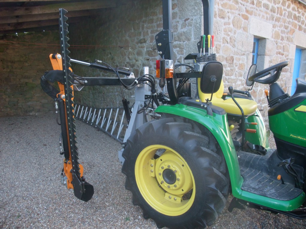

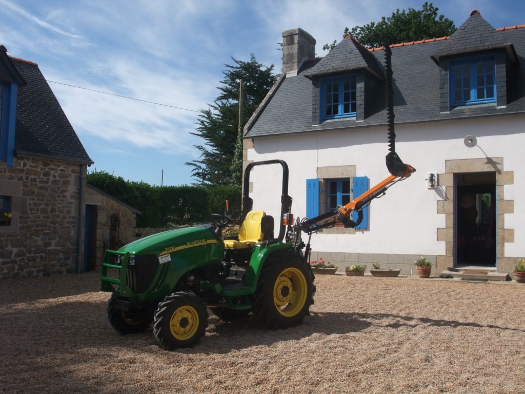

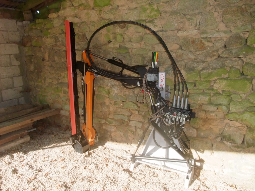

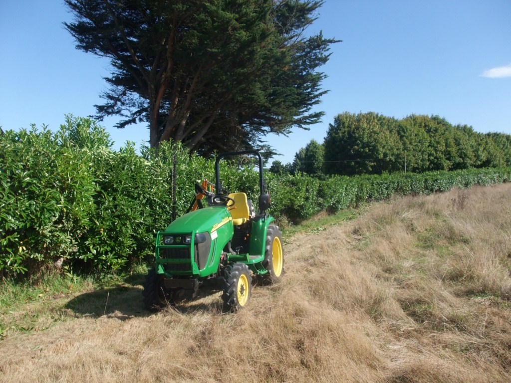

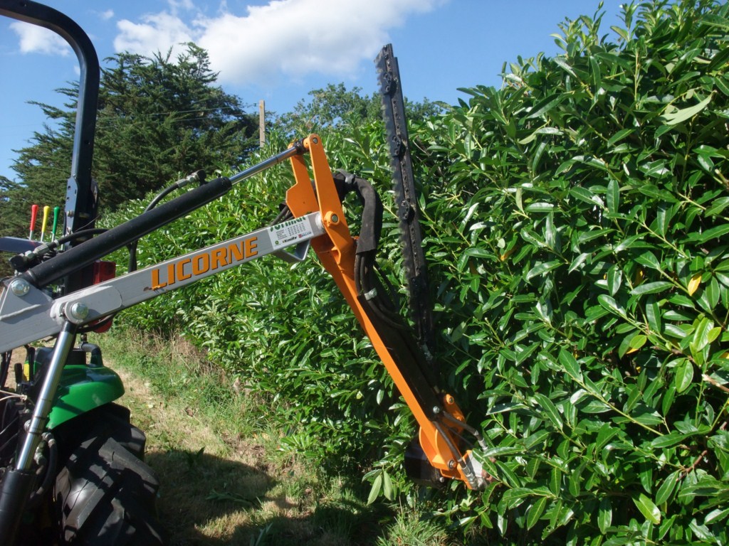

A sickle bar is a very handy device. It can cut grass in difficult places or trim hedges (vertical or horizontal cuts). It is not very heavy and does not require a very powerful or heavy tractor. I don't think you can get this British model, but there must be many like that in the US.
