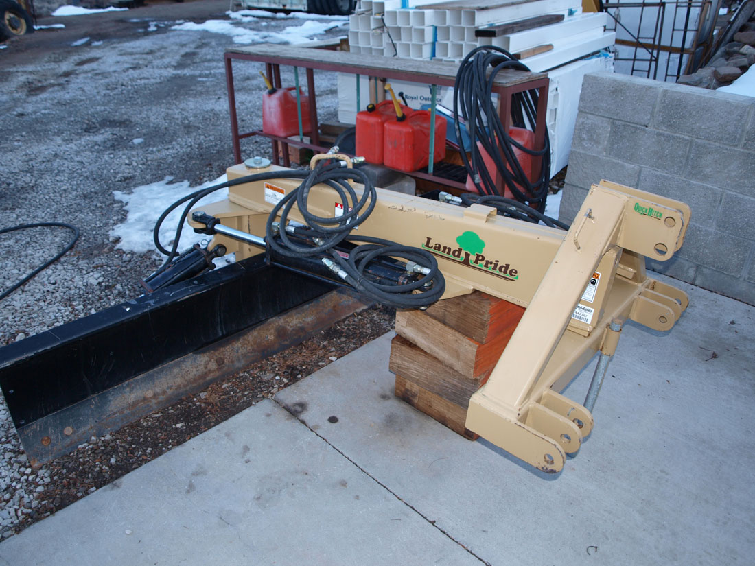

I'm not a landscaper, only road maintenance with a good blade as well. This blade is 84" and HYD three way as well. ( the blade in the pick )

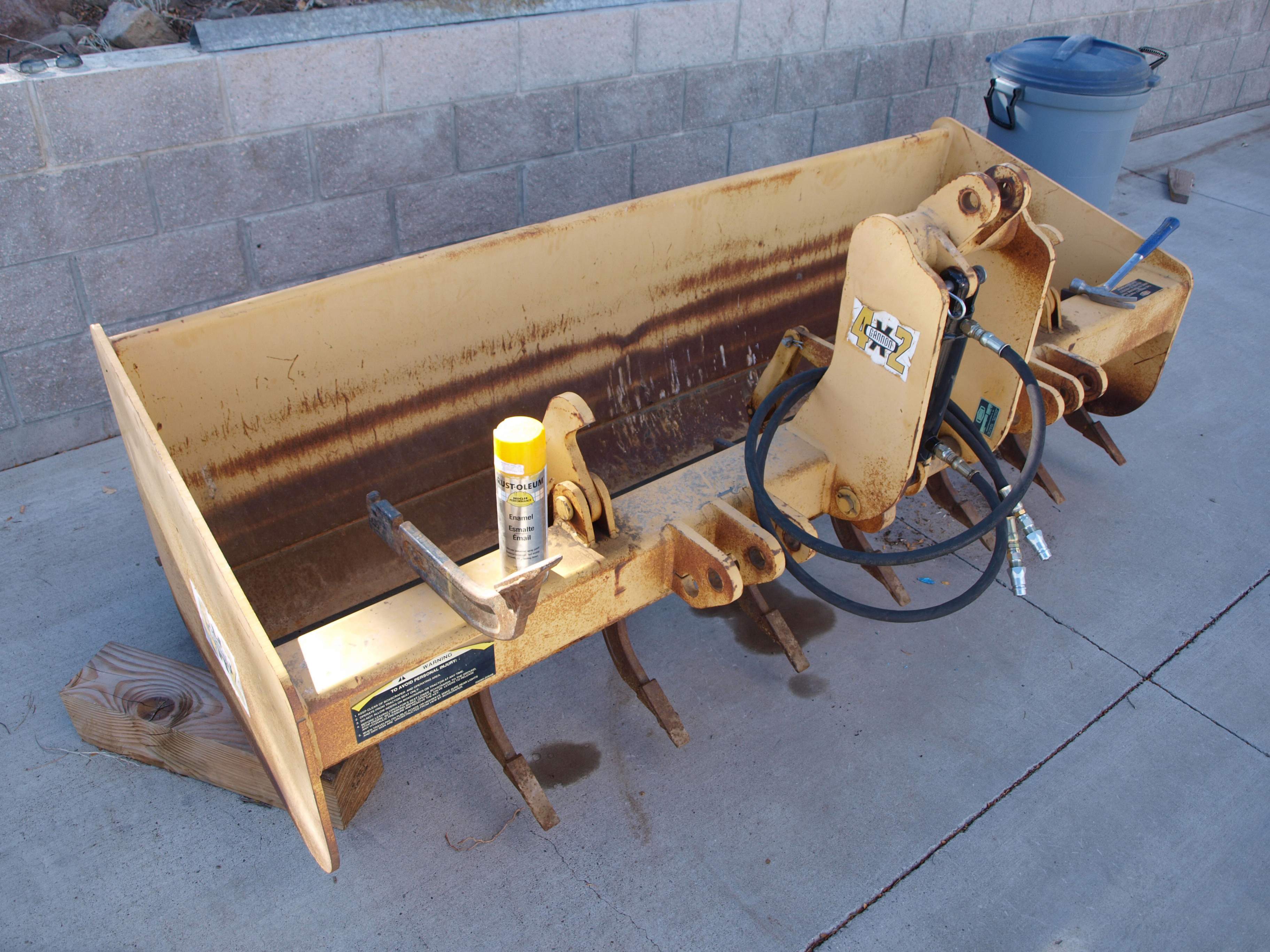

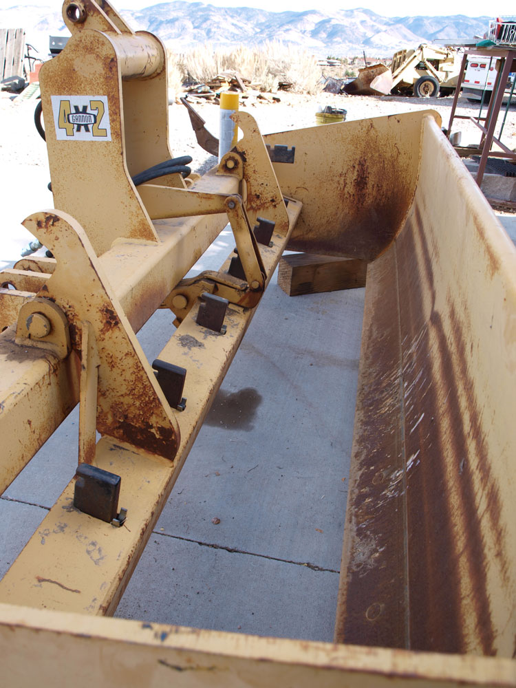

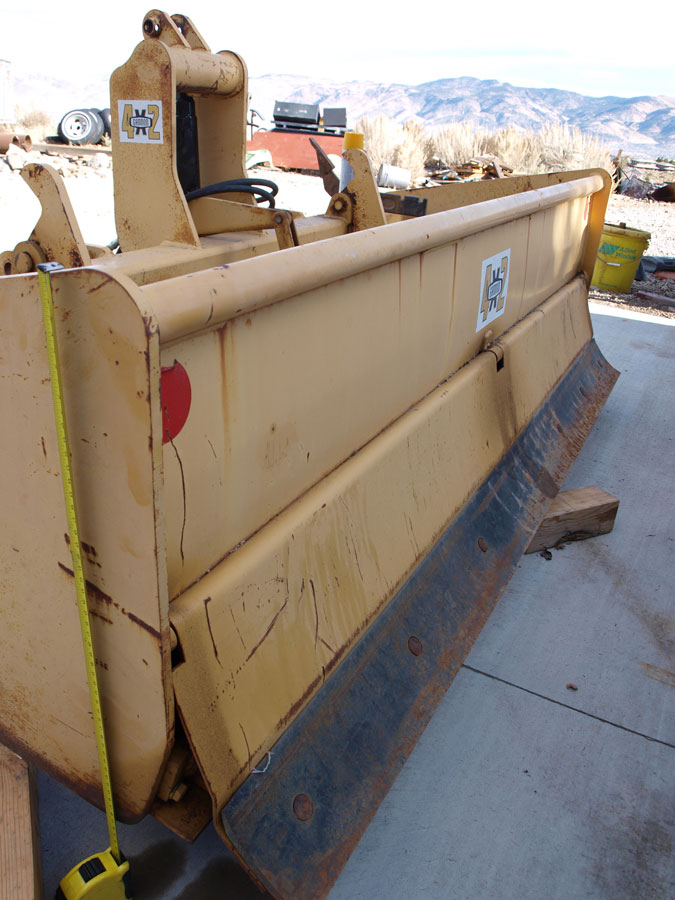

As promised some pics of this beast of a Gannon/boxblade. As you can see from the pics it has very little use. The pins are all cat 2 so I picked up some sleeves for my cat 1 pins. It has a tailgate, which I now know what it is used for, thanks to the members on this web site. Deeper cuts with the front blade. The scarfer ram fits like a shoe so it could be original with new paint and hoses. My rear tires are loaded and my tractor is well over #5,000 lbs minus the driver, I'll leave that detail out.:laughing:
My research and job site imformation/eyes, see a 4x4 vs mine a 4x2, can't see a defference. Anyone know?

Outstanding tool there. I think your tractor will have a hard time in soft material or heavy cuts with this one. I have the Fontier version, a tad smaller and lighter, and my 83hp 4x4 definitely knows it's there. Mine is cat I and all three pins have bent or broken from the load. I'll be glad to trade with you:)

Nice looking boxblade, hope you have a fel on the front of your tractor to counter balance it. I have one very similar that I use with a 5,500 lb 4520 and I have to use 4x4 or I will spin the tires easily.
Looks like you have clevis hitch for cat 1 and 2, might need to get the correct pins for this. These pins have shoulders for fitting both hitch sizes. Also when you replace the broken scarifier make sure you get the correct one for this implement, the cheap ones won't hold up.
At any rate I have used mine for about seven years now and have been very satisfied with the results I get from it. Really does a good job of moving large amounts of dirt and is heavy enough to produce a smooth grade.
