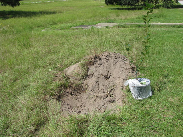

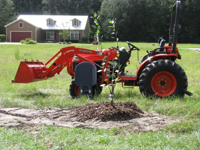

It was hot today: 88 degrees in the shade....but there was no shade where I decided to plant one Pineapple Pear and one Kieffer Pear. These are in the family known as Sand Pears in Florida. Sand Pears set a fair crop however the pears remain hard at maturity. Two different varieties are needed for pollination. These two pear trees are planted about eighty feet apart on the grassy lip of a retention pond. My wife makes poached Pear Butter and Pear Preserves from Sand Pears but I planted these to provide fruit for the pet deer within the Riverwalk development.

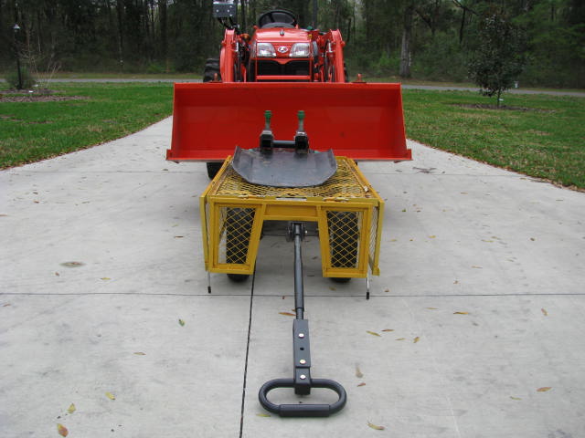

My tractor is a Kubota B3300SU tractor/loader package: 33-hp / 1,800 lbs. The clamp-on Bucket Spade is from Bucket Solutions in Wheat Ridge, Colorado 80033. The bucket spade weighs 110 pounds and immovably clamps to the bucket with two 1-1/4"-hex-head machine screw torqued pads. In photo #2 you will observe there is plenty of support under the bucket. There is the 4" screw pad on top side of the bucket, the bucket itself and the heavy spade on the back side indirectly receiving the well distributed screw pad pressure. Bucket Spade is built very robustly.
This is an effective tool for digging. It cut through the sod easily and I excavated the two deep planting holes in just a couple of minutes. (Other days it has cut through general scrub growth and Muscadine Grape cores; large Water Oak stumps and associated large Oak roots have defeated the spade, or more accurately, my patience, occasionally.) It was not the time savings.....it was having the tractor and implement do the work on the HOT DAY. The bucket spade is NOT as capable as a backhoe but Bucket Spade cost $369 delivered in February 2012. Much less money than a backhoe, it attaches and detaches in two minutes and requires NO hydraulic line connections....and your 3-point is open for another implement.
Kubota gives the minimum lift capacity for the LA504 loader bucket as 750 pounds. Well, the spade is 110 pounds way out in front, with leverage making it effectively heavier. Put a blade load of wet dirt on the spade and you have quite a bit lift capacity being used due to the leverage. An 1,800 pound tractor w/FEL is about the minimum able to use the tool well. If you have clay or clay and rocks to dig in you would want a larger tractor and heavier FEL.
It might seem the bucket spade is hidden behind the bucket when in use. Not really, it mounts on the lower lip of the bucket and to dig you are pointing it down, so you see where it enters the earth. Generally speaking spade works best inserted at about 45 degree angle, not much more to the vertical. In tough conditions you move the tractor forward in LOW using wheel power to help push the spade in, not 100% bucket hydraulic force.
