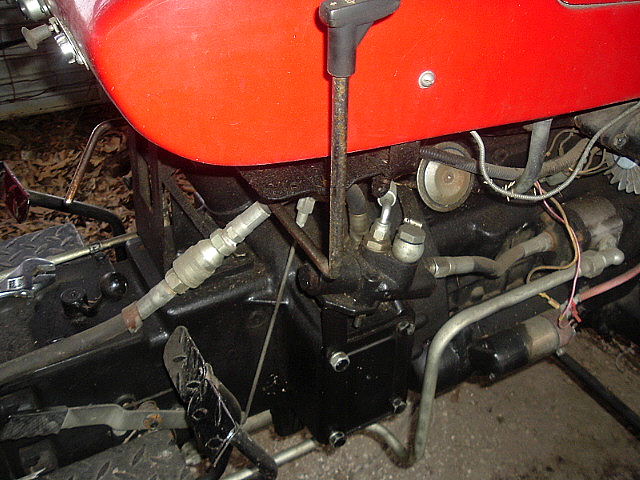

I am about to add a front-end loader to my Jinma/Nortrac 254. I have question about the hydraulic plumbing. The Quick Connect has been placed behind the Diverter Valve (going to the 3pt. lift). Most tractors I see have this Quick Connect before the diverter valve. Can I attach the loader with the connection behind the diverter valve or will I have to change its location? Any advise would be appreciated. I have added a photo for reference. connectionvalve.JPG

It will work OK, the steering will have priority over the loader AND the 3PH instead of just over the 3PH as the other configuration now has... Probably the way they all should be:)

Added to the non-OEM wiring evident at the starter/solenoid, I'd say that PV config was the work of a hydraulic-savvy previous owner. I'm gonna speculate that QD section was relocated from the pump output

my tractor came from northern tool with the loader on it and its tied in after the diverter valve
