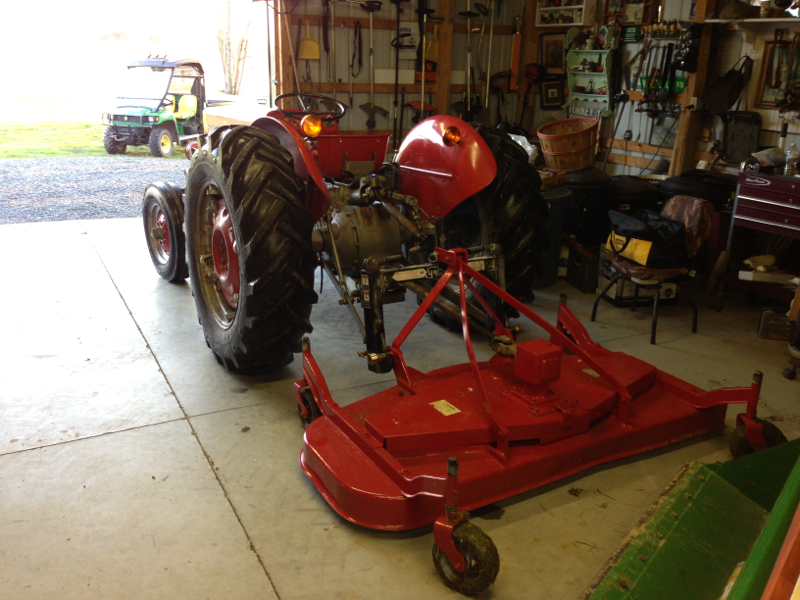

Hello all. Been a while since I first posted about this tractor. I got some good info from you guys (especially The Kid) and I really appreciate it.
I am done with all the repairs for now and I am ready to deliver it back to my father(owner), and it springs a leak. The previous owner changed the fluid and had it overfull. Clean but overfull. Was planning on draining some but didn't. Now it is leaking at the weep hole in the belly. Dead center where the cotter is sticking through. I know it's not oil, so I guess I'm hoping it is blowing out a breather because its over full. Anyone seen this?

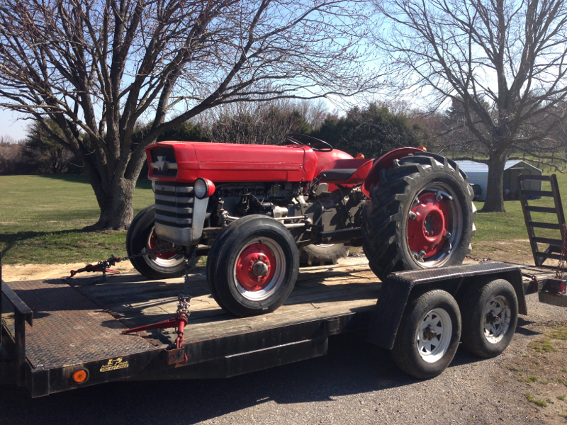

I'm taking her home anyway. No time left. Spring is here. Just have to keep an eye on it.

When you say it's not oil, I assume you mean engine oil. I don't know of any breather for the transmission / differential that would be leaking in to the clutch housing. It sounds like a seal to me. Does this tractor have multi-power?
   / 135 leaking utf #5
G'day sounds like the front gearbox seal to me or multipower piping/valving if it is clean oil you can take the inspection plate off the bottom of the bellhousing and have a look inside, no breathers in the bellhousing.

I'm not sure what to say about this. I drained it to proper level and it isn't leaking now.
Runs great and the old man is very happy!!
