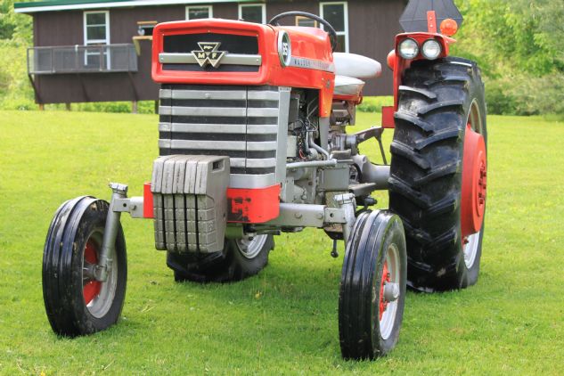

I have been thinking about a second tractor and a year ago a friend of mine bought this tractor in show room condition
with the promise from someone who was going to let him groom land for rabbit hunting with his hawk and after
my friend bought the tractor the guy told him no. So this friend of mine kept the tractor and now wants to sell.
It had it orginally for $6000 and now down to $4800. Is this still too high. All I want the tractor for is a finish mower and
bush hog. Which I already have. I do not need a front end load my JD has one with forks.
Tractor has been completly rebuilt. What is the true value of the tractor. What some gets is sometimes different
than the book value of it. Tractor has been for sale at least 6 months. this guy is funny I would not want to
offer too low as he will get mad. I do not care with a stranger but do with a friend.

Checking http://www.tractorhouse.com/list/list.aspx?ETID=1&catid=1110&Manu=MASSEY-FERGUSON&MDLGrp=165 it seems a good deal, what are the hours?

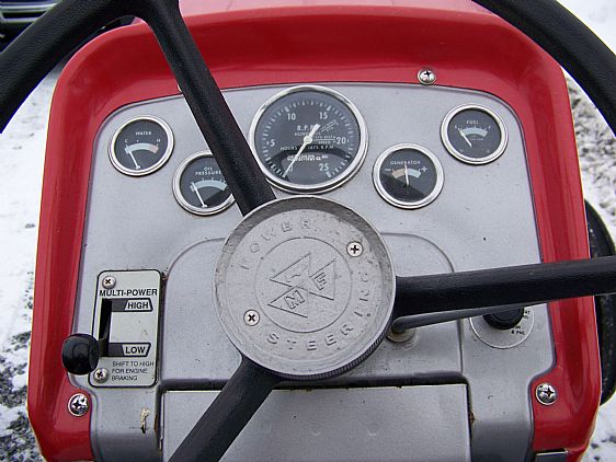

MK: I suggest you offer him what he wants...assuming the tractor actually looks as good as the pics...one thing though, make sure the Multi-Power works as it should..if you don't know what it is, read up on it in the Massey Vintage section...Tires look good...the weights on the front end and the weight bracket are worth $400 to $500 by themselves...have him show you the paperwork on the rebuild... the engine is a 4 cyl Contenintal...good unit for a gasser. I have a 135 with the Cont. engine...wouldn't trade it for anything...it also appears that the 165 has power steering...make sure it works well... good luck. BobG in VA

You can buy all of the 165s that you want for $3500 - $4000 though few if any will look like the one in the photos.
Insuffient information to provide much more help but gasoline versions generally command a lower price than diesels. "[C]ompletely rebuilt" means different things to different people.
It's been for sale for 6 months. I would sit on it for a few more.

The 6 months thing tells me these don't sell very well there. offer 4000.

Judging from your photos, it looks like a Deluxe model (full set of gauges) with Multipower, like my 1964 MF135 diesel (paid $3600 for it in 2006). That 165 is in much better cosmetic condition than my 135 when I bought it.
Make sure the Multipower works in both ranges (when the MP clutch goes bad, the MP gets stuck in t he Low range).
Also check the bottom of the clutch housing. On my 135 there are two small diameter weep holes that generally have loosely fitting cotter pins installed. Pull the pins and check for any fluid drips. A few drops is normal; a steady flow could indicate bad oil seals in either the engine (rear main seal) or in the gear box.
If that 165 passes the driving test and the exhaust smoke test, then the price seems pretty good to me.
