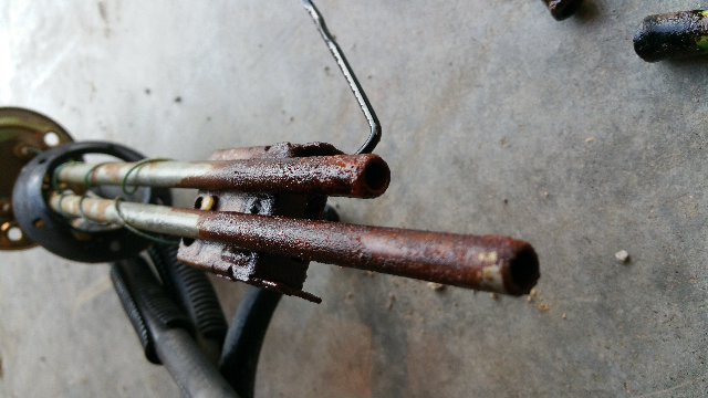

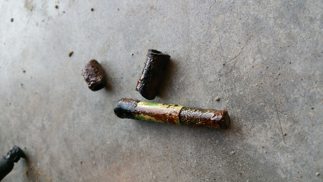

So I just pulled the tank to diagnose a lack of power incident and found the hose and screen busted off
What is the best way to clean inside of tank?i pressured washed it to release any buildup a regular wash wouldn't get wich was alot!
Also best way to clean up the fuel pump/sending unit/fuel gauge mechanism?
Thanks in advance!!

With fuel problems becoming more of an issue I am still surprised the components have not been upgraded to material not affected by water/alcohol.
In the old days I would take a tank to a radiator shop and they would boil it out...
Also had luck putting chain, nut, bolts and shaking/rotating to removed the crude... doesn't work so well with baffles...

I replaced the fuel pickup/sender in my 855 last year at some point because the fuel gauge didn't work properly. It had also lost the screen etc at some point and thus no longer would run past 1/4 tank. When I pulled the pickup, I don't think it looked that nasty. Must have been some serious moisture in fuel at some point.

Last year I picked up a generator that must have sit outside it's entire life because the steel tank was very rusty inside. I dumped a box of drywall screws into it and shook it with some gas to dislodge the rust. It did an OK job, not great. Ended up putting a couple inline fuel filters prior to the carb to catch any residual garbage.
