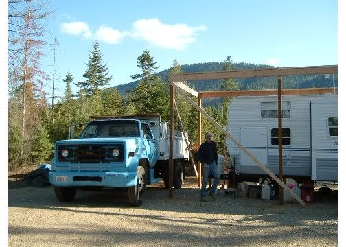

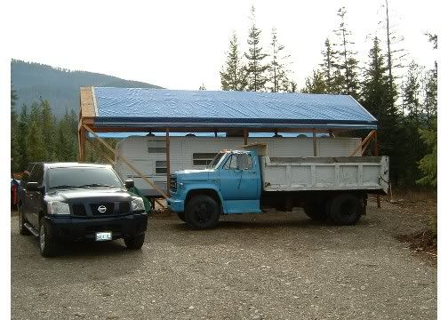

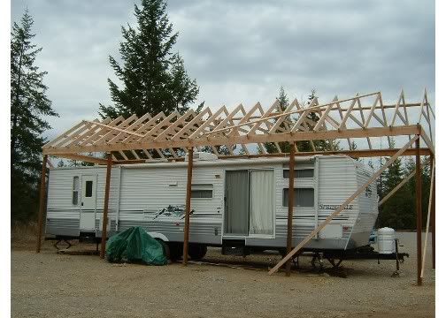

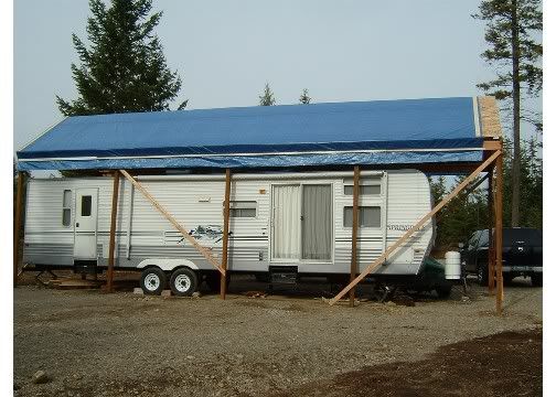

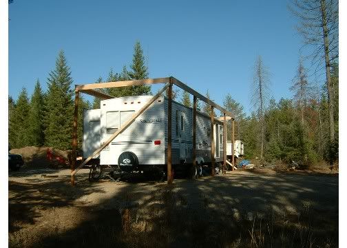

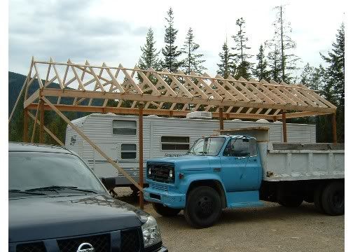

Heres some pics of what I've been doing the last few handfull of weekends.
Building a temporary snow shed over the trailer.
I assembled the whole thing using screws so I can take it apart next summer.
Boy my arm is sore from pulling against the drill/driver. About half way through I got smart and switched to torques screws and that helped a lot!
I built all the trusses myself, and if I ever say I'm going to do that again.. shoot me! What a pain in the rear it is to hammer those plates in by hand!
All in all I'm happy with the out come, but I'm a little conserned about if the wind will pull it out of the ground. I dident use any concrete around the posts as I want to re-use the posts, They are about 2-2.5' deep and hand compacted.
Do you think I should ratchet sprap the roof down to the trailer wheels?

Nice Job...instead of the ratchet straps...check the big box stores for mobile home tie down stakes..it would be easier and they are inexpensive...just screw them into the ground and attach a nylon rope to each one - maybe one at each corner and for appearance sake have a sharp angle down on the rope to the anchor...Just a thought.
   / Snow shed #3

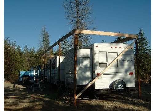

I'd make sure both ends are x-braced w/ two diagonals, not one. That puts one member in compression and one in tension upon loading which is preferred on that type of bracing. I'd do the same on the long sides but the diagonals don't have to stack in an X, just be opposed. That is how you have it in the one slider door side photo but the bottom of that left brace is too far off the ground for my comfort, given the background geology and what I'd guess is some pretty stout wind loading. Your current bracing would probably be adequate for a temporary structure on my tree protected lot in Maryland though.
As for holding it down I'll defer to those with experience in dirt anchorage and strapping. I understand that you are just hand tamped on the supports and that's not much uplift resistance as your question implied. My layman (carpenter) guess is that it wouldn't tend to launch until something approaching 70 or 80 MPH but wind direction matters on an A truss geometry roof. That's an inefficient airplane wing with wind perpendicular to the long side. I will say that winds in that range will also test to potential failure the bracing I suggested.
Just suggestions for discussion of course. I'm no engineer.

I'll check out those RV anchors.
The ends are x braced, you can barely see it in the last two pics.
