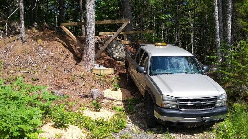

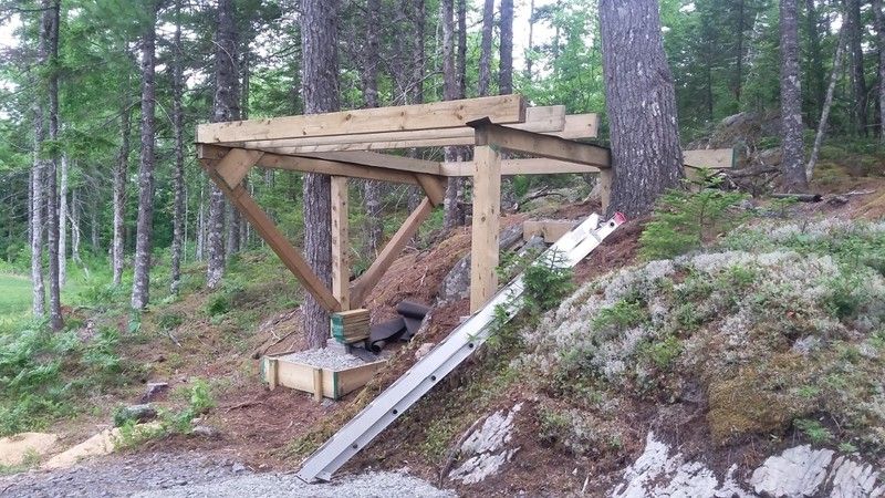

I've been wanting to build this for a year, but just getting around to it now. As with most of my projects, this will be a slow one. The plan is to build a railed in deck this year, and the house portion next year. Deck is 12x12, house will be aprox 12x6 with the roof covering everything and a loft over the deck portion.

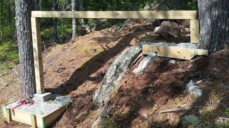

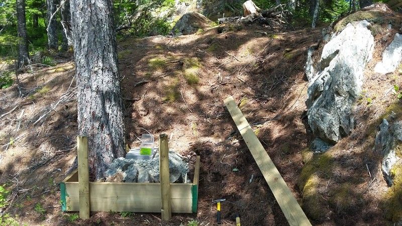

Getting ready for the posts

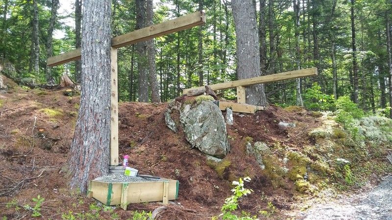

Posts into the trees with 12x3/4" lag bolts. Beam in place just to make sure the posts were level and square to each other.

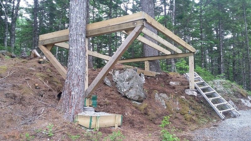

Beams in place
Braces (used the truck instead of a ladder)

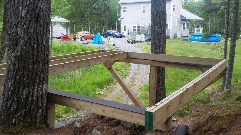

Floor joists going in
View
That's it for now. Working on rail posts before putting down the decking.

Got it all decked and railed in other then the temp. entrance. Started on the permanent entrance.
Ran out of wood, but almost done (for this year at least)
