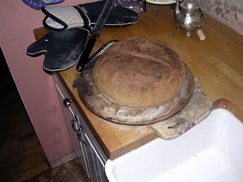

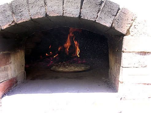

I was told to start on the end to get everybody's attention. Following that advice, this is the output of a project. We are baking:

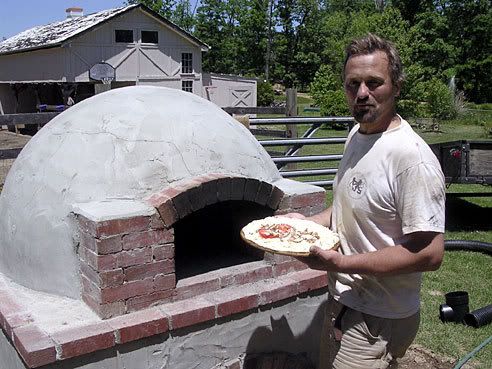

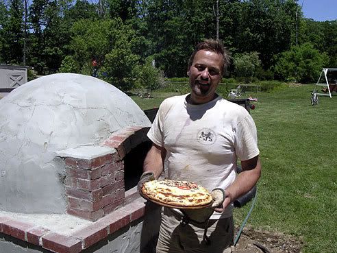

This is not how it started, but it is the oldest picture I could find.
Building the base, using leftover blocks and parts of a chimney:

Ready for rebar and bottom insulation:
I was not sure if the insulation is going to work, but I done it anyway. The logic was the dome will be standing on the sides and middle supports only a layer of firebricks and the concrete is about 2.5" thick above the fiberglass.
Base is finished:
   / Brick oven
I used regular firebricks and mixture of fireclay (from Indiana:)) cement and sand. That stuff smells like a pond mud and it is very sticky. If you keep bricks dry, they hold in place without support almost all the way to the top. The wooden shapes are needed to follow the arch.
The top looked like a hedgehog with bricks sticking up in the air:
