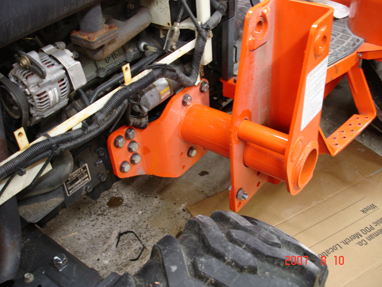

Aug 17, 2007 / 1009 Woods FEL to a L3130 #1 Bill Barrett Platinum Member Joined Jul 11, 2006 Messages 671 Location midwest Tractor Kubota L3130, Satoh G650, Case 580, Case 446 Here are a couple pic of us mounting a FEL to a L3130

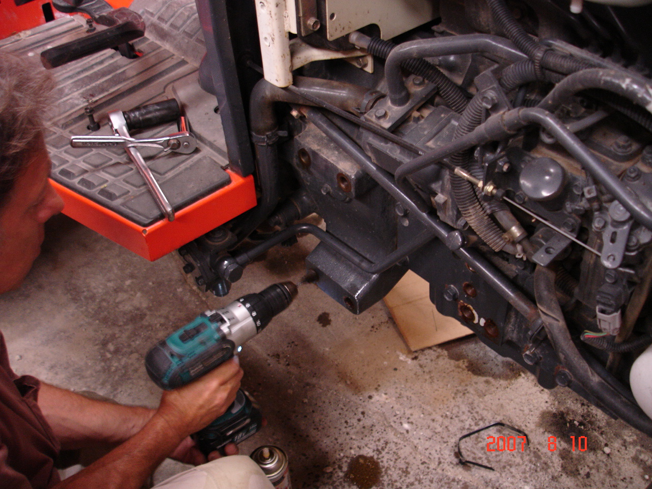

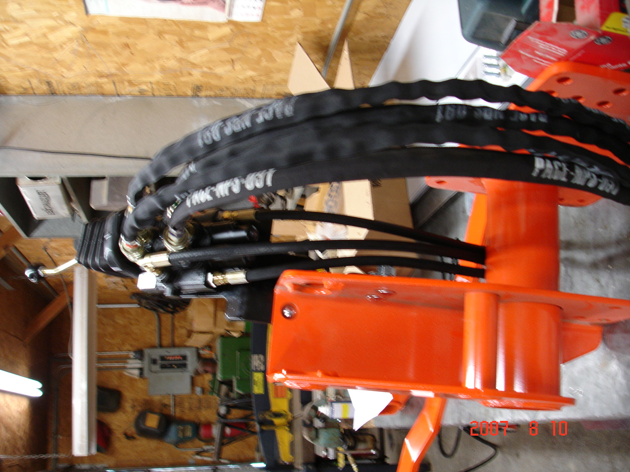

Aug 17, 2007 / 1009 Woods FEL to a L3130 Thread Starter #2 OP Bill Barrett Platinum Member Joined Jul 11, 2006 Messages 671 Location midwest Tractor Kubota L3130, Satoh G650, Case 580, Case 446 1.We mounted the control valve to the reciever. 2. Cleaned the threads on the tractor. 3. Reciever bolted and torqued to tractor.
