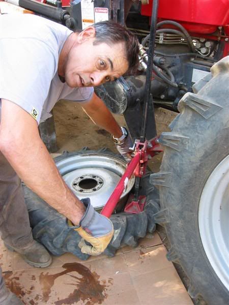

I blocked up my front end and took the tire off. I got loads of huge lumber now, like 12 x 12's and so forth. Also put blocks behind and in front of the rears. Anyway, I drained the liquid into a pan (my tires are loaded with anti-freeze and water) which took about 15 minutes. Then I had to figure a way to break the bead to get to the side wall for a repair. Anybody have to break the bead on those Kama 554 tires yet? My fronts are pretty big and they were on there tight. Plus those tread lugs are thick man.
So here's what I did. I got the farm jack and wedged the carriage under the tractor and the foot on top of my tire. Smashed the bead down, it was easy that way. Then I used pry bars to carefully get one side wall off the rim so I could remove the inner tube. Loretta was taking pictures as usual and telling me what to do.

Great story and repair job using that rad hose. Looks like the jack took care of breaking the bead quite nicely. I wonder if putting the tire under the FEL and using down pressure would have worked?

You have a bead breaker "your backhoe"
Gemplers dose have a bolt on bead braker but i'm frugal some times and use my "hoe"
I lay tire on ground pit a short 2x4 on tire and push down with one tooth some times I have to rotate tire and hit the other side to completly knock it loose.

your farm jack idea is good. Many of us do stuff like that.. AKA.. drive over the bead with another tractor or use a loader blade to pop it off.. etc. ingenuity is the mother of invention.

I will keep the links and suggestions in mind for next time. I guess I had all kinds of tools to break the bead after all? Just didn't think of them. But the farm jack worked great too, so add that to your list.:)

I really liked the 'multi-tasking' use of the farm jack. I always think about lifting things 'UP' with a jack. Never thought of using the jack in reverse.
