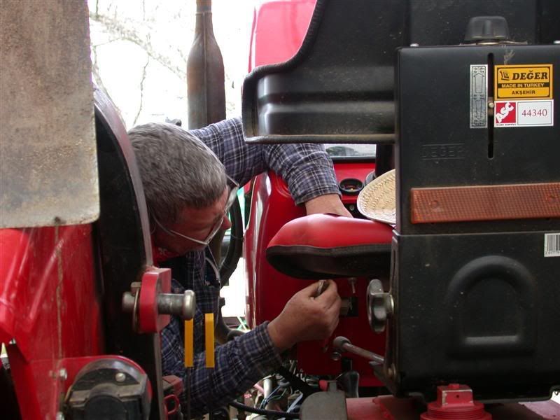

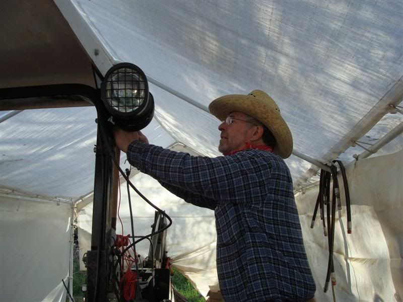

We decided on their mounting position first. I wanted two to face forward, slightly shining to the side, and two to the rear, angled the same way. I already have front head lights and a rear work light, but the front was blocked by the loader bucket when raised up a little.
So here is Larry starting to install the lights on each side of the ROPS bracket.

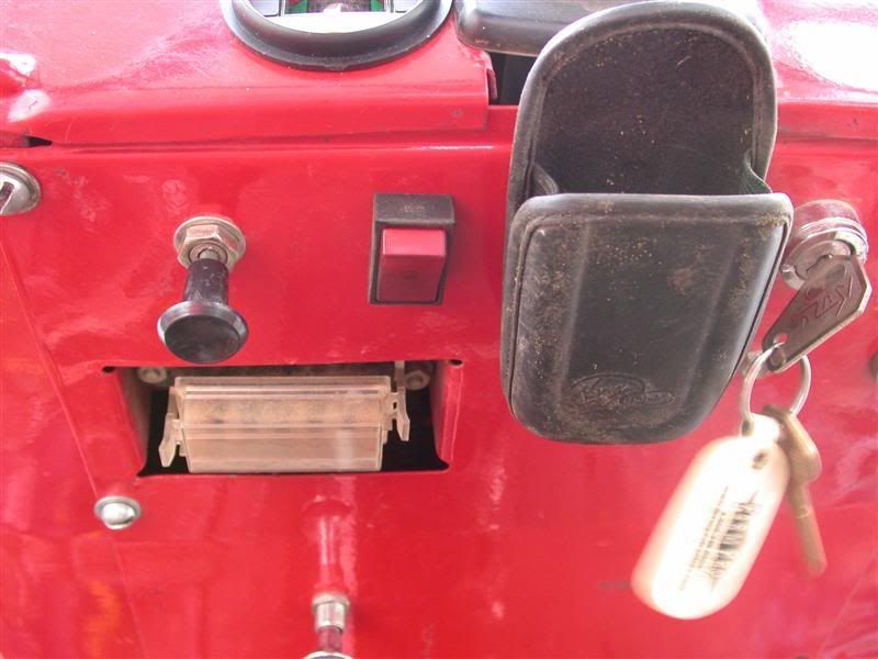

Larry added several heavy duty light switches and changed around the ones that were there. The new lights were wired through one switch with it's own 30 amp fuse. These do not run through the ignition switch to activate them. He added a new switch for the existing rear work light and move the location of switches so they would fit and work. It didn't take him long since he's an expert in this field.
BTW, you can see the fuse box he added last year, when he switched out the OEM Kama fuse box with an automotive style.

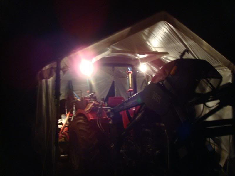

Larry calculated out that the load and amps drawn would not be of concern. He made sure of that before starting the project.
Later that evening, we had a chance to try them out.
Shees, they are bright as all get out. Here they are in the shed, but in driving around with them, it lit up the front and back ... all around the tractor. That was exactly what I was looking for, since I get caught out after dark on my rural property a lot. This makes working at night a lot easier to see and much safer.
You can see in that last photo that I'm very pleased to what was done.

Yeah, they are bright!
After I got the front drive repaired I took it out. I ended up working into the night and used them. They light up the work area all around just as we thought they would. What I really like is that they light up the perimeters of the work area so you can see next to the tractor, both in front and behind. The existing front headlights and rear work light was just for in front and behind the tractor. This mod made all the difference.
