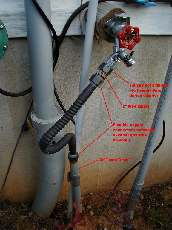

Could you explain this a little more. Sorry for my ignorance. That is exactly what I'm looking to do (I think).

tdenny: I used this set up on the other side of the house. I'll take a picture tonight and post it with explanation.

tdenny: Attached is the picture that should clarify the hook up.

Thats not a water pipe duct taped to an electric conduit is it?? /w3tcompact/icons/grin.gif

Thanks much for the picture. That look simple enough. I have a similar setup with the soaker hoses I use in my front flower beds.

Dang, Inspector - I thought I airbrushed out all the code violations. /w3tcompact/icons/wink.gif
