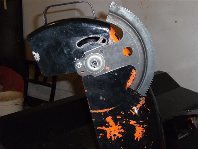

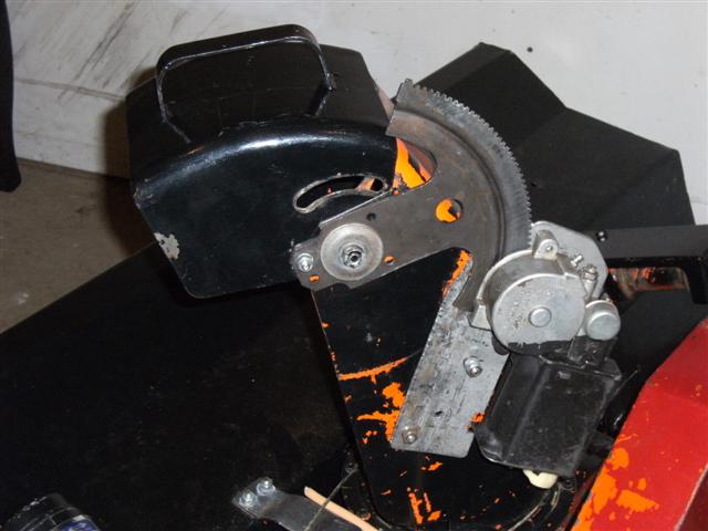

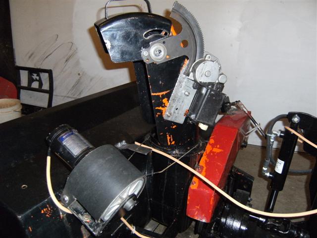

I made a different way to change the snowblower deflector.I did the chute as well but this has been done before.I got tierd of having to get out of the cab to change the deflector,had the window motor already so tried it this way and it works just fine.Larry:D

Nice job, but doesn't your arm get tired now when you roll down the window in your truck? :D
   / New way for electric deflector on snowblower #3
Don't be rediculous. He didn't take that out of his pickup.
It was out of his mother-in-laws :)
   / New way for electric deflector on snowblower #5
I bet he took it from the wifes car!!!!! actualy I did this same thing on a snowblower about 15 years ago on a Makee but it did not turn out as nice as yours and am sure it didn't work as well as yours. NICE JOB!
