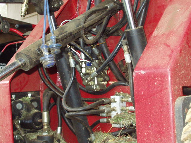

If the upload works, the attached photo will show the diverter valve about in the middle, with six hoses attached.

Charlie, <font color=red>If the upload works, the attached photo will show the diverter valve about in the middle, with six hoses attached.</font color=red> Nice clean installation. Now when are you going to show us your button? Any idea whether Power Trac will offer us a mini hoe too, to say nothing of a dump trailer? And contrary to what bubenberg says I must compliment you on keeping your machine so clean.

I knew when I went down with the camera that someone would comment on a few grass clippings from the two fields I mowed Sunday. If I'd thought a bit more, I would have predicted who would point out that I don't clean after every use. My excuse is that my PT works for me, not the other way around. /w3tcompact/icons/laugh.gif
