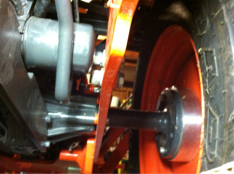

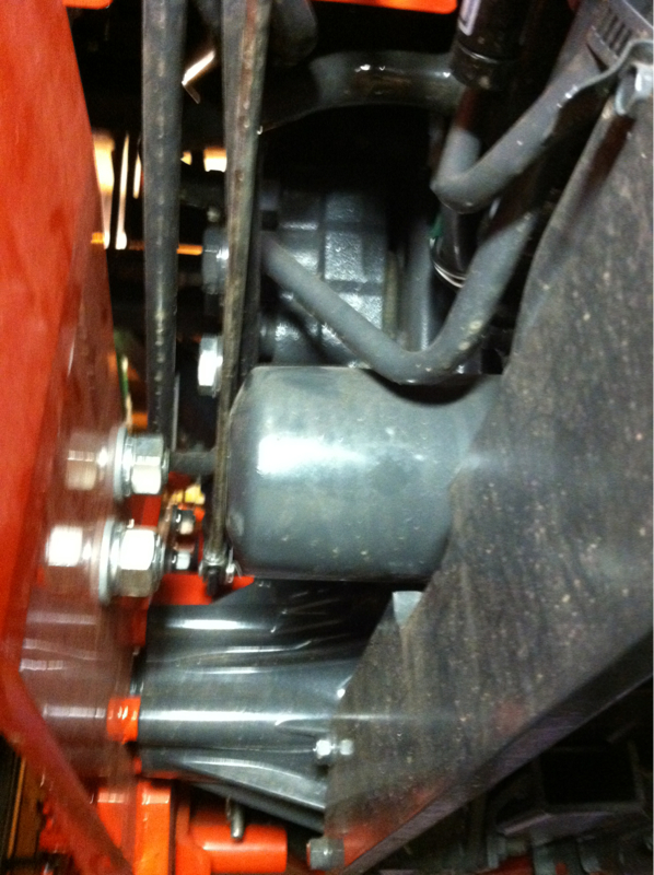

I just changed my engine oil & was about to start changing my Hydraulic fluid when it struck me that I'm not sure I can get the transmission oil filter off with the loader & backhoe frames on!! I think I can get the hydraulic oil filter off with some wiggling! Anyone have experience/suggestions for this issue?

Problem solved once my thinking cap was screwed on straight!
I was able to remove the grey metal bar that looks to be there for protection to enable me to get at the filters from underneath.
Phew! Engine oil/filter, HST filter & hydraulic oil filters changed, new SUDT2 & front axle fluid replaced with 80/90 gear oil!
I'm enjoying a well deserved beer!!

Glad it went well. But I dont think you should have to remove anything to perform the service.
   / B3300 Hydaulic Fluid & Filter Change
Thanks - mission accomplished & I agree that I SHOULDN'T have to remove anything to do it but it was physically impossible to remove the filters without something coming off!!
