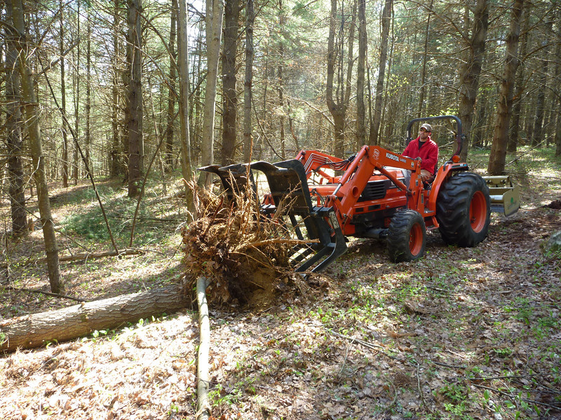

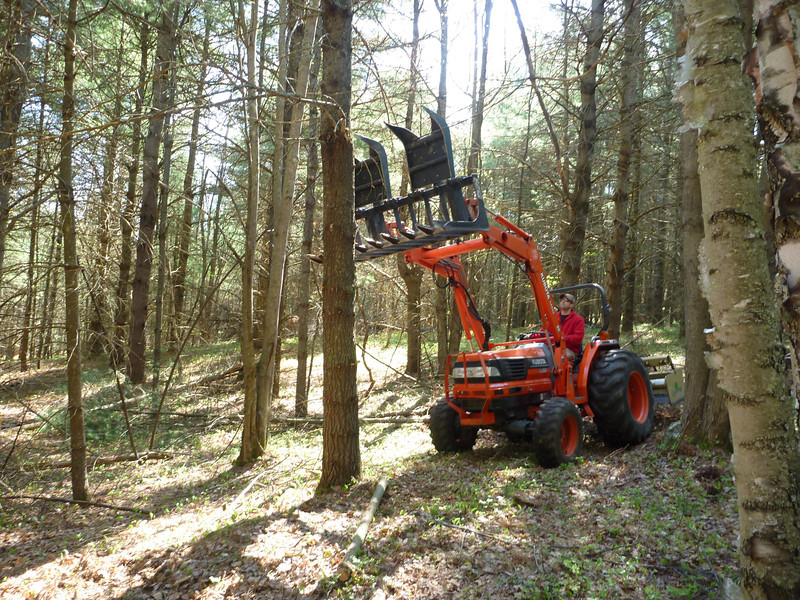

I had a member ask me about how I use my grapple for removing trees and grubbing brush. I figured rather than keep it a private conversation, I'd start a thread on it so other's could benefit as well. Not only that, but I'd like to be sure that what I tell him, is considered safe and effective among other grapple users as well. In addition, I'm always open to learning new ways of operation!
(Note: If you press the "ctrl" key and click the picture at the same time, it will open the image in a new tab, so you don't have to keep pressing the "back" button)

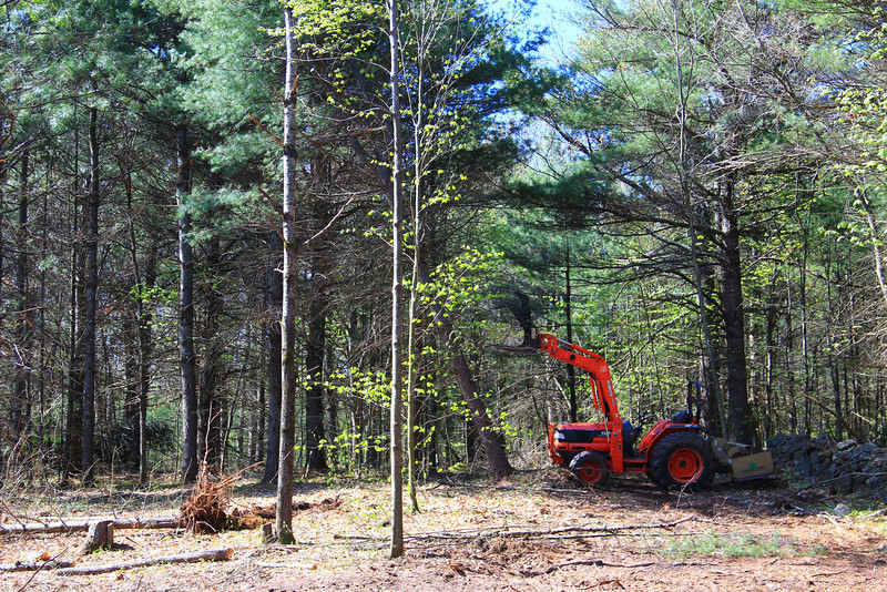

When I want to push trees over using the tractor/grapple, this is how I do it:

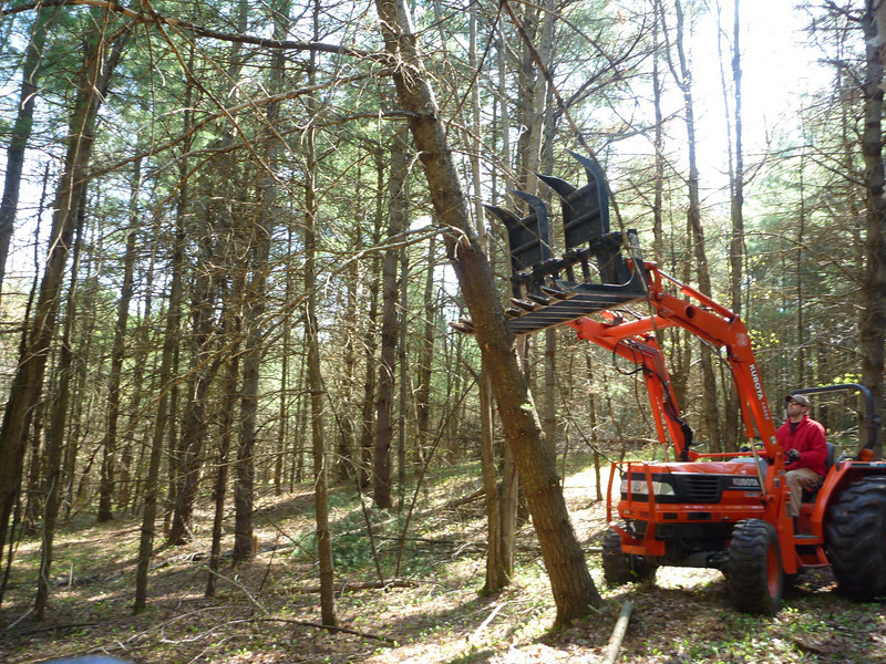

Drive up to the tree slowly, with the grapple arms fully opened and the FEL up in the air. I don't usually have the FEL all the way up however, it's probably around 75%-90% raised most of the time, and the grapple is "level" with the plane of the ground. When I raise my loader too high, it will sometimes lift my front end off the ground, and I find I get more traction when it is not full raised.
My first step is to "test" the tree. I nudge the grapple up against it and give it a little push, if it moves pretty easy then I should be able to push it right over. If it seems very "stable" and barely moves, I'll have to loosen up the ground around it a little bit.
This tree didn't need any digging around the base, so I just started pushing. It was in fairly loose soil and has a very small root structure. This is pretty common when your in a very thick stand of trees-there are so many trees so close together, that even in very windy conditions, the trees don't need a very large root structure to keep them from blowing over, since all the trees together tend to 'break up the wind' and help support each other. If your dealing with a single tree that has been growing on it's own for a while, with not many trees around it, you'll have a much larger root system to deal with, and would have to loosen up the soil around it by digging. You can actually dig very well with a grapple.

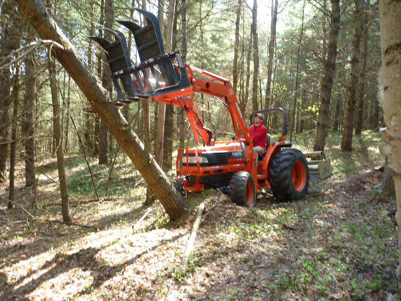

You can see as the tree is going over, the root ball is coming up. If your dealing with a tree with a good sized root system, and your not aware of what's happening, this root ball can come up pretty quickly as the tree goes down, with plenty of force to lift the front end of the tractor right off the ground, and very possibly roll you over! :eek: -This is something to be VERY mindful of. :thumbsup:
Anytime the tree starts to fall on it's own, I back up right away, and let it fall as far as it will (sometimes all the way, sometimes not.) I want to minimize any chances of the root ball getting caught under the front of my tractor!

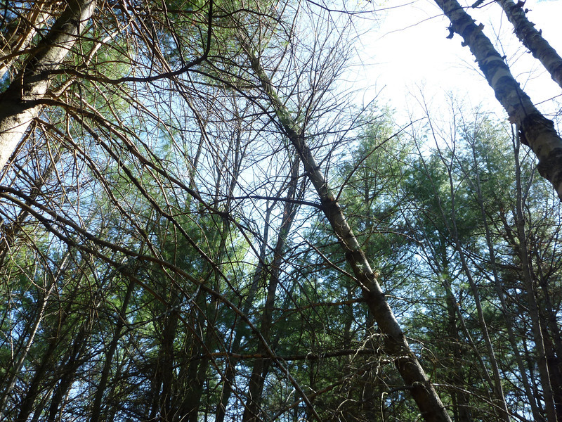

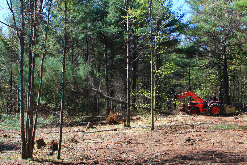

This tree didn't fall all the way to the ground, it got caught up in other branches as it was going over. This would be a good time to mention how important it is to take some time before pushing the tree over, and take note of any branches that are in the way, that may possibly come crashing down on (or anywhere close to) you. As we all know, they're called "widow makers" for a reason!
Another note about falling objects, be very careful of dead trees. I don't push over dead trees with my tractor, but if you do, be aware that there is no way to predict what's going to happen. There is a very good chance that the tree will snap, and come crashing down on you. The root structure of trees stay much stronger, much longer, than the rest of the tree itself after it is dead. Something has to go, and it's not usually the roots. ;)

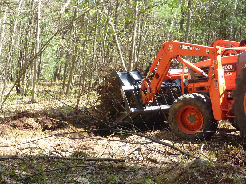

This is obviously an "after" shot, but what I did after the tree was caught in the other branches, was back up away from it, lower the front end loader and drive towards the root ball, then insert the lower tines of the grapple underneath the rootball, and lift the FEL while slowly creeping forward. This effectively "pushes" the rootball up, and out of the ground, with the added advantage of the tree's weight pulling it the rest of the way to the ground.
Then drive forward a little ways until the rootball is clear of the ground (obviously be careful of where your front tires are, you don't want one of them falling into the huge hole you just made!)
If I did need to dig around the base to loosen the roots, I would have dug the backside of the tree first (let's call the front of the tree, the direction we want it to fall, so the rear would be between the tractor and the tree) then just angle the tines into the ground, push the FEL down, curl and lift to break up the soil and roots. At this point you can try again, if it still doesn't go, dig up the left side of the tree, then the right (I always do either both sides, or none), then the only solid ground holding the tree is in the front of the tree, acting as a hinge. Never dig up all sides of the tree. Some just need the chainsaw!
You don't necessarily need to dig up the roots either, sometimes just loosening up the soil is enough to let the roots break free. Obviously, trees with large root systems are more difficult to get down. Always remember the limits of your machine.

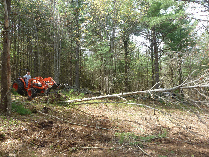

Here are some more pics using the same method...

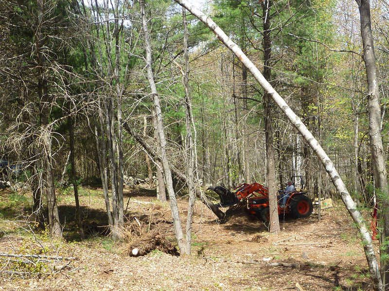

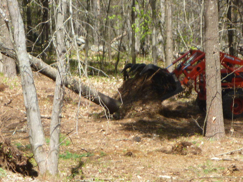

Getting the tree to go over, notice the tractor is positioned so the rootball won't get caught up underneath it if the tree decides to drop to the ground too fast.

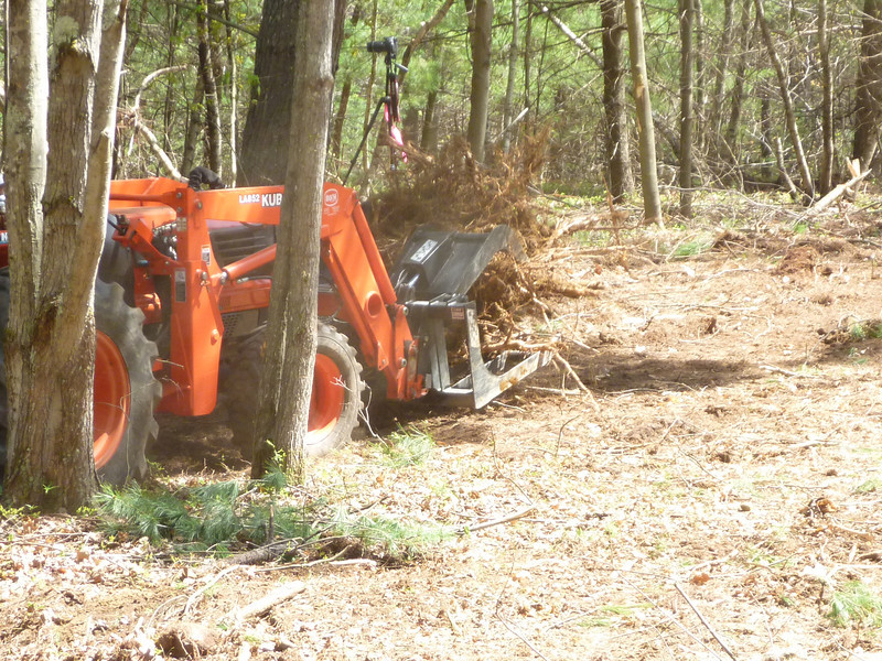

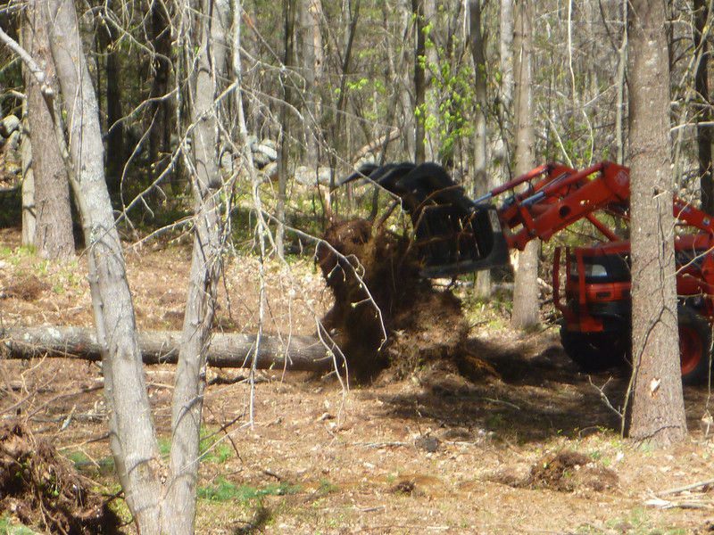

Inserting the grapple under the rootball (notice the grapple arms themselves are open and not doing anything, just the lower part of the grapple is under the root ball). Then lift and push.
And here we have the desired results. :D

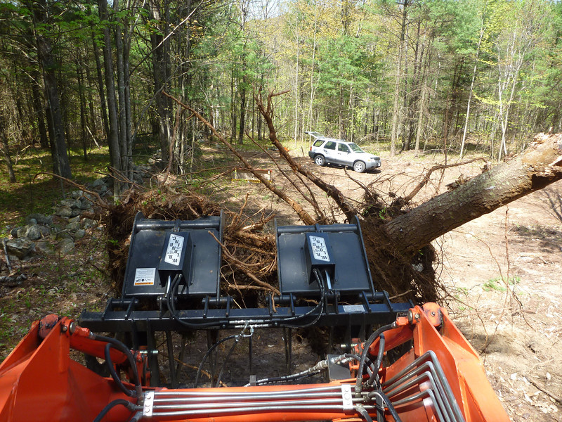

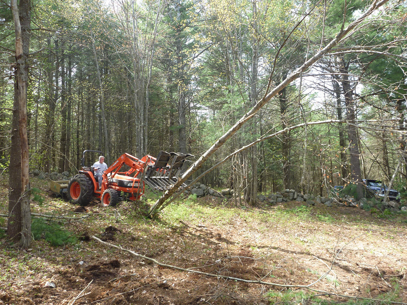

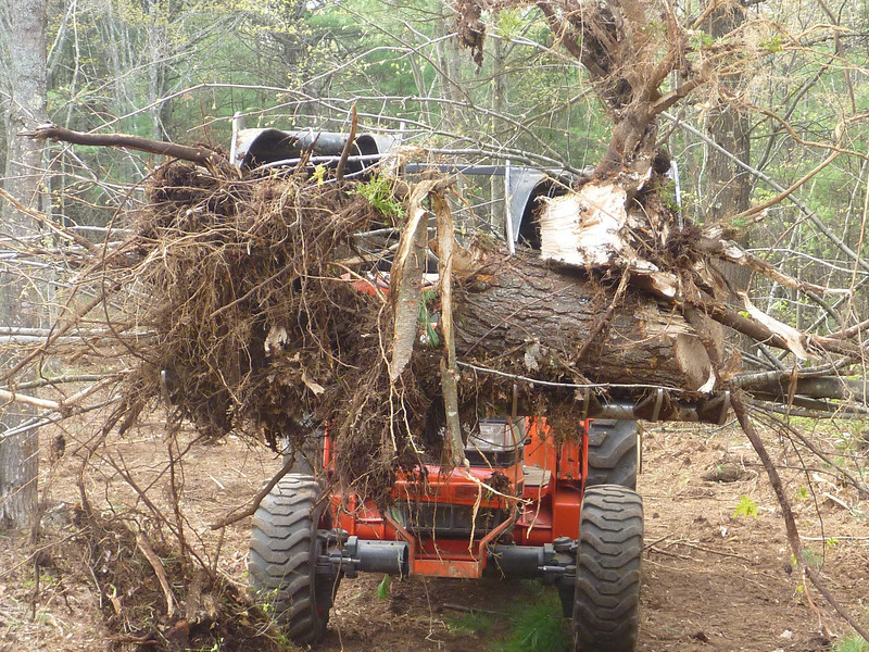

This tree was too big/strong for the tractor to push the rootball all the way out with the tree still attached, so we cut it off and dealt with the stump separately. (actually, the tree wasn't too big, the tractor was too small:laughing:)
Then pick it up....
....and carry it to the pile.
Here are some more pics of the same process on some different trees....
Gotta love how useful the grapple is for carrying stumps to the stump pile!
