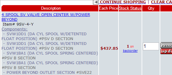

So I am exploring other valves as I want to be able to float both the top link and side link. Is there any scenario where one would want to float them both at the same time? I can't really think of any right off...
I am looking into this valve http://www.surpluscenter.com/item.asp?UID=2008032012213814&item=9SV-4-Y&catname=hydraulic in either the 3 spool or 4 spool version, and like the fact that it has a joystick option to control 2 valves. I really want to get the valve mounted down between the seat and fender and have the lever sticking up where my hand would be operating the 3pt lever. Just seems like it would be more natural than going from the 3pt lever back to up on the fender or ROPS and back.

Here is a good question,
Can you add joystick levers to two adjacent spools on a stacked valve, and have the T-N-T cyl go into float together.
   / Rear Remotes - Planning stages, need advice
I wouldn't think so, that's why I was wondering if there are any situations where you'd want to float them both at the same time.
