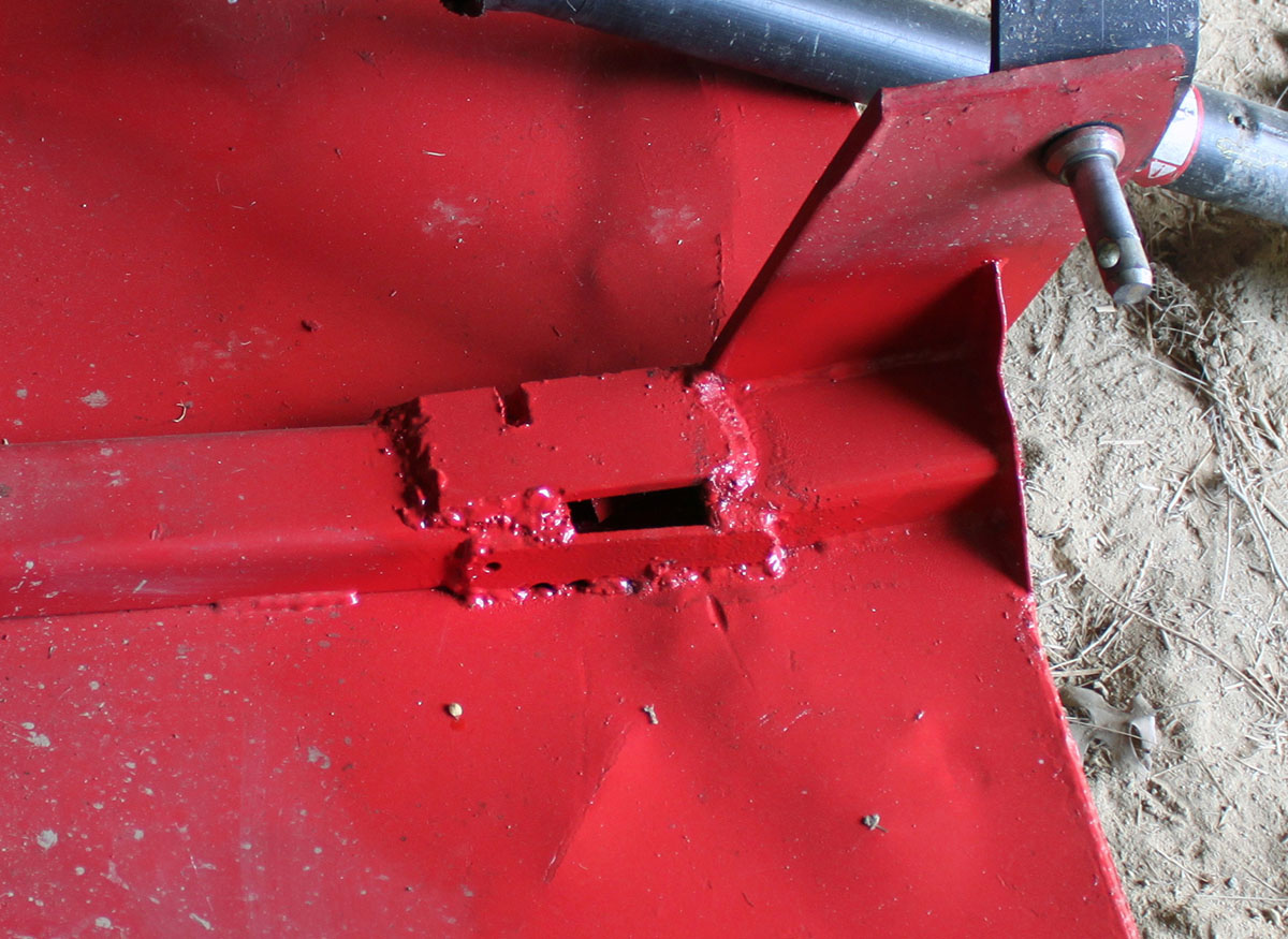

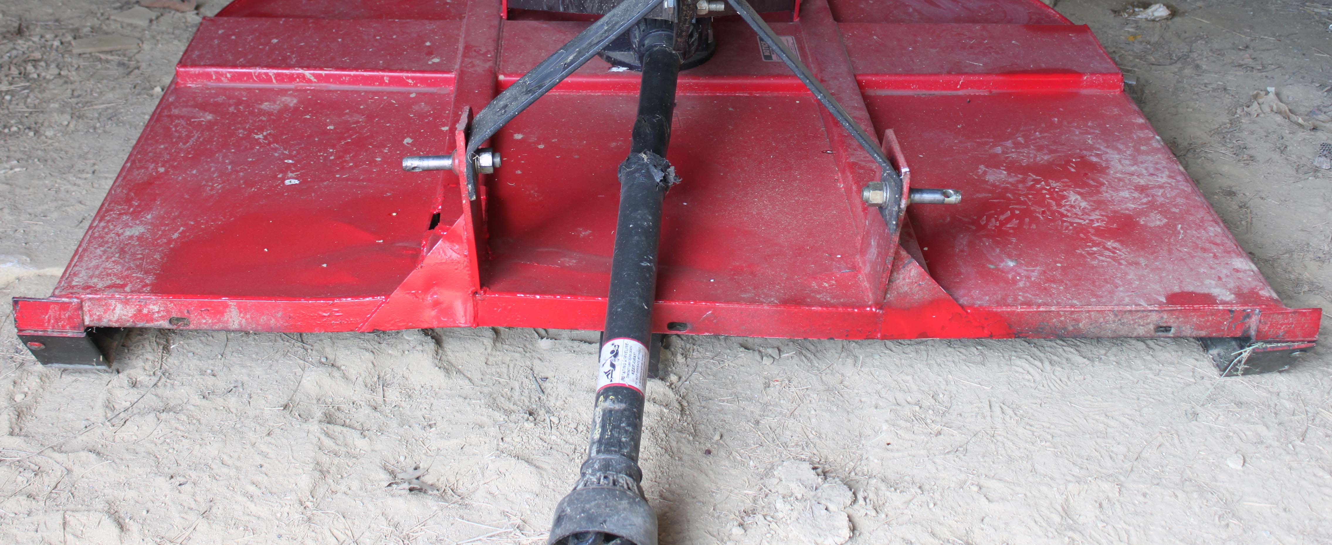

I have the 6' medium heavy duty roundback rotary cutter and I am not very fond of it. The design and engineering are not the best in my opinion. I backed into a small stump about 4" diameter by accident and it buckled the deck. The HD skirt did not bend, however, the way the deck is braced it buckled. My cutter is branded Kodiak, but the owner's manual is Mahindra. Also, the design of the lift allows the hinge bar to get into the driveline safety cover if you have a steep mound to mow over. The cutter is heavy at 815 lbs., but leaves a lot to be desired. It is a tough gearbox and will mow over pretty much anything you can push down. I managed to straighten the deck and weld some bracing to repair the damage, but the skirt should bend before the deck buckles. I, in all honesty cannot recommend this mower. I bought it earlier this year and would gladly sell it if anyone is interested for basically half the price I paid for it.

That sucks you damaged your Medium Duty cutter like that. Personally, with having the potential of hitting 4" stumps I'd think you'd need among heaviest of heavy duty cutters to not see damage. I've not seen the medium duty lift hinge, that does sound like a bad design. Maybe you could post a picture so future readers know what to avoid?

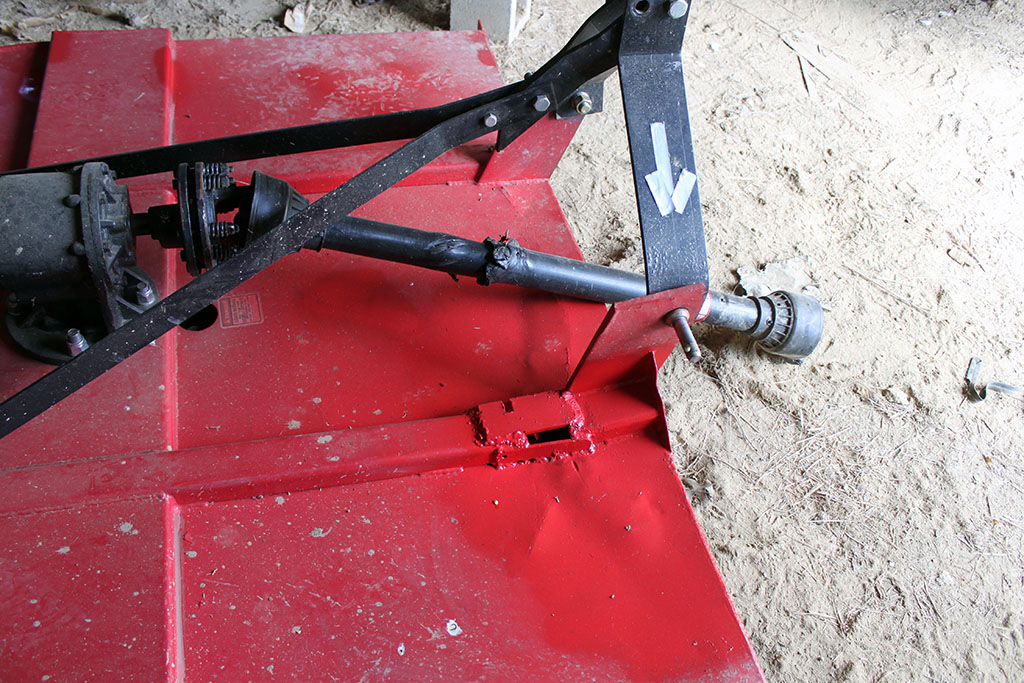

I didn't take a picture of the rear of the cutter skirt, but there is no damage to it from impacting the stump. Here is a better image of how the lift arm on the mower frame works and if you run over a hillock or some other change in terrain the hinge lift arm can contact the driveline housing.

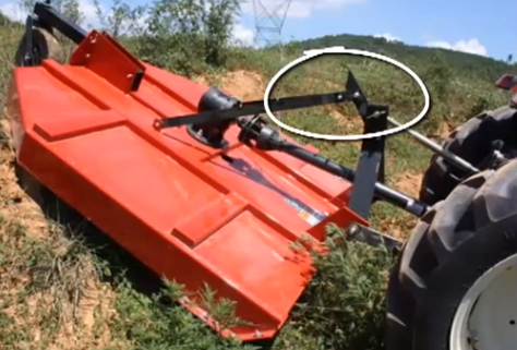

That joint is upside down is why. Someone put that unit together wrong. Note in this capture I've attached below from that video how that joint should flex up and away from the driveline. If the unit was assembled by a dealer, I'd complain to Kodiak and the dealer and have them make it right. If the assembly was left up to you the buyer, I'm not sure if they would do much to help. You did say you got it straightened and working again, so perhaps just correcting the assembly will help prevent future damages.
