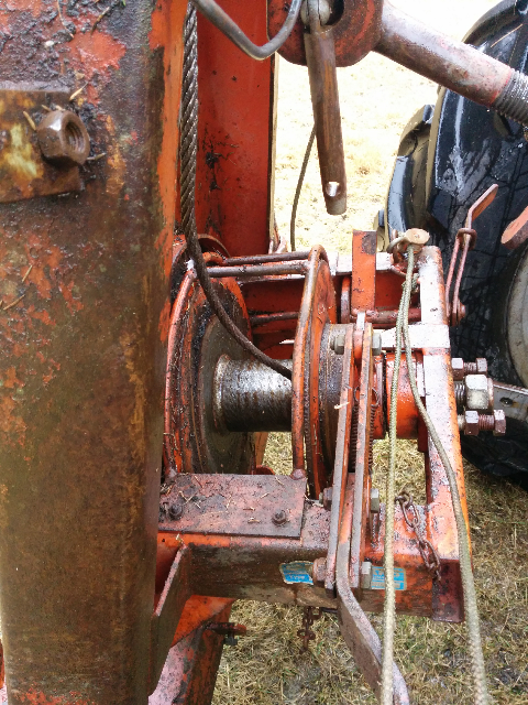

Starting to turn some bolts, so far it looks promising.

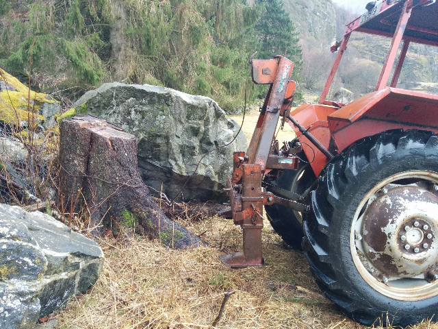

Removed the wire today
It was a mess
Hooked it up and off we go
After ca 50m it was the end of the line.

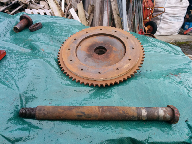

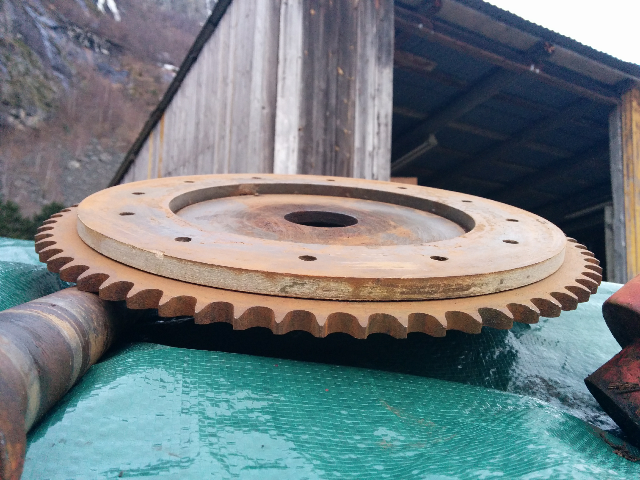

Removed the broken PTO axle.
   / Logging winch repair/restore project

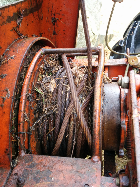

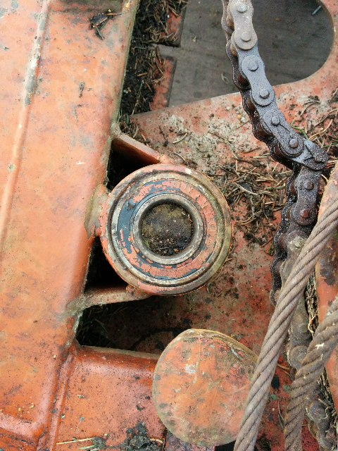

All bearings are dead
Clutch seems almost unused
Winch drum full of water and junk

Repairing the chain tensioner on my Sandvik/Norse 3081

Chain tensioner was worn, welded it an grind it into shape
