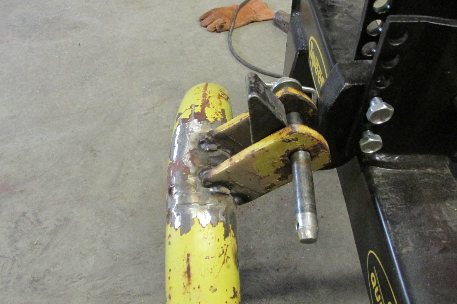

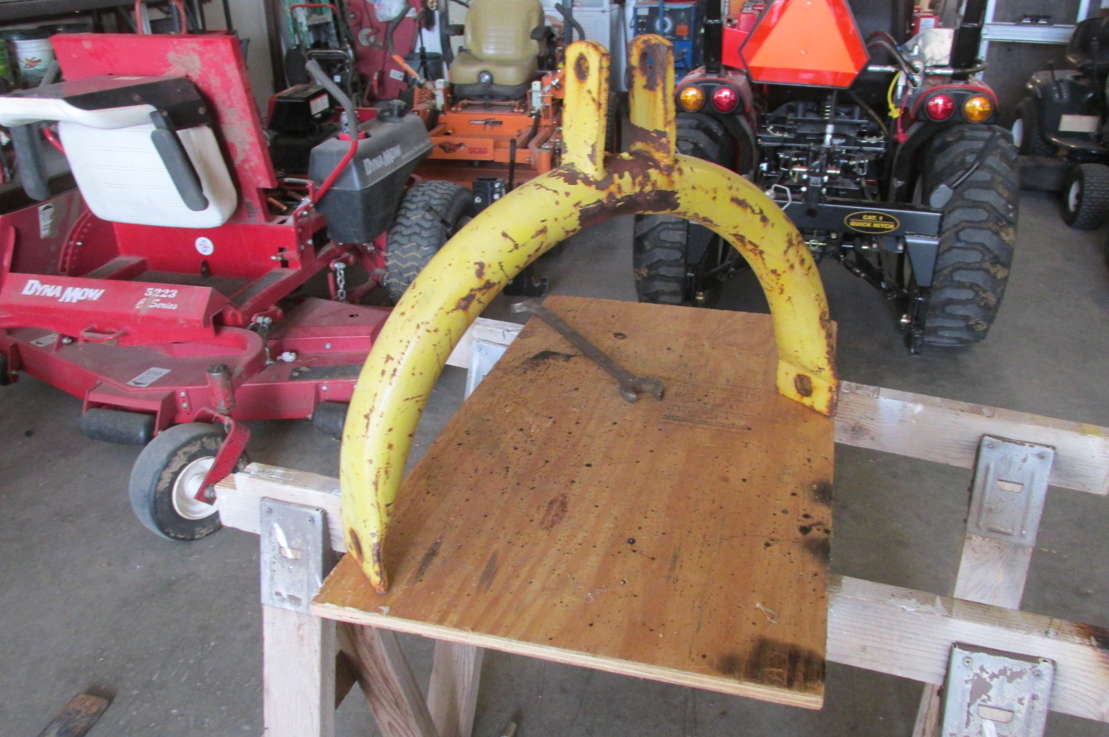

Back in the summer I had bought an old complete 3 point hole digger with this idea of converting it to the quick hitch set up.
Here are some pictures of my 3 point hole digger conversion to a quick hitch hook up.

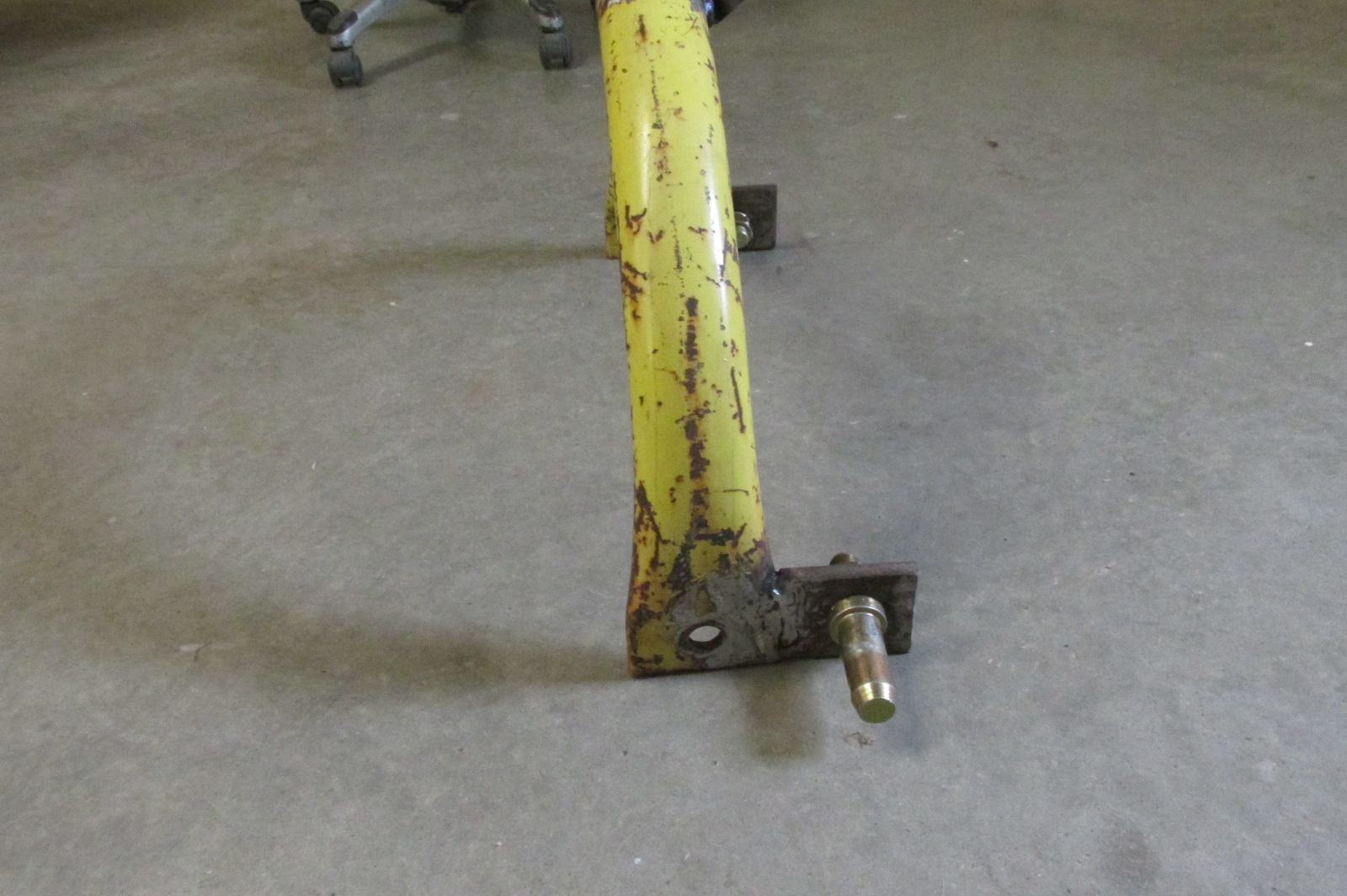

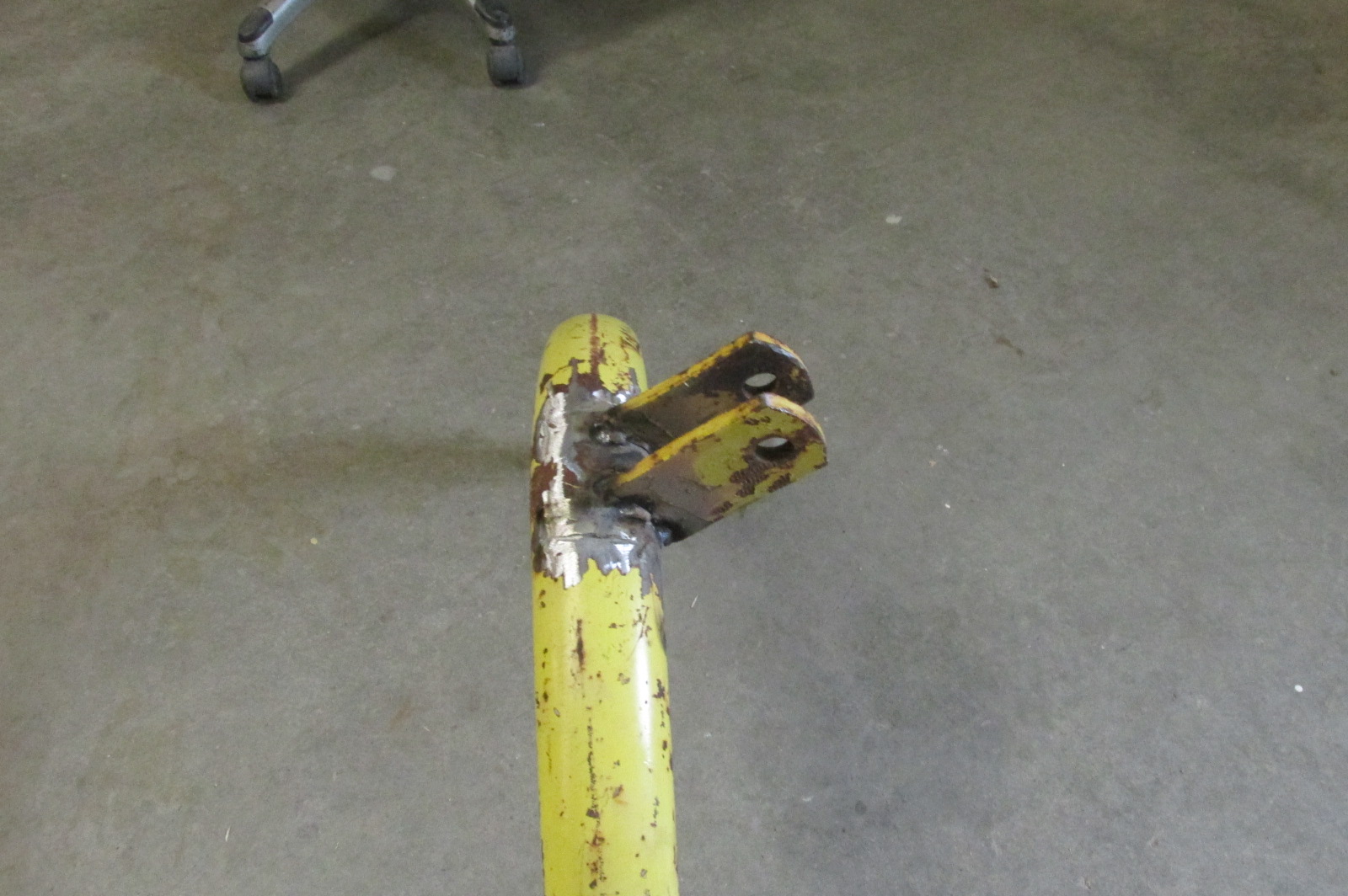

I started with the modification of the yoke.
First step is to move the lower pins forward 4"
This step will allow me to move the top connection forward so the top hook will clear the yoke and allow for a true quick hitch connection.
Top connection
Yoke sitting on Quick hitch
All of the connection points on this modified yoke match the measurements on my BB and Brush hog
