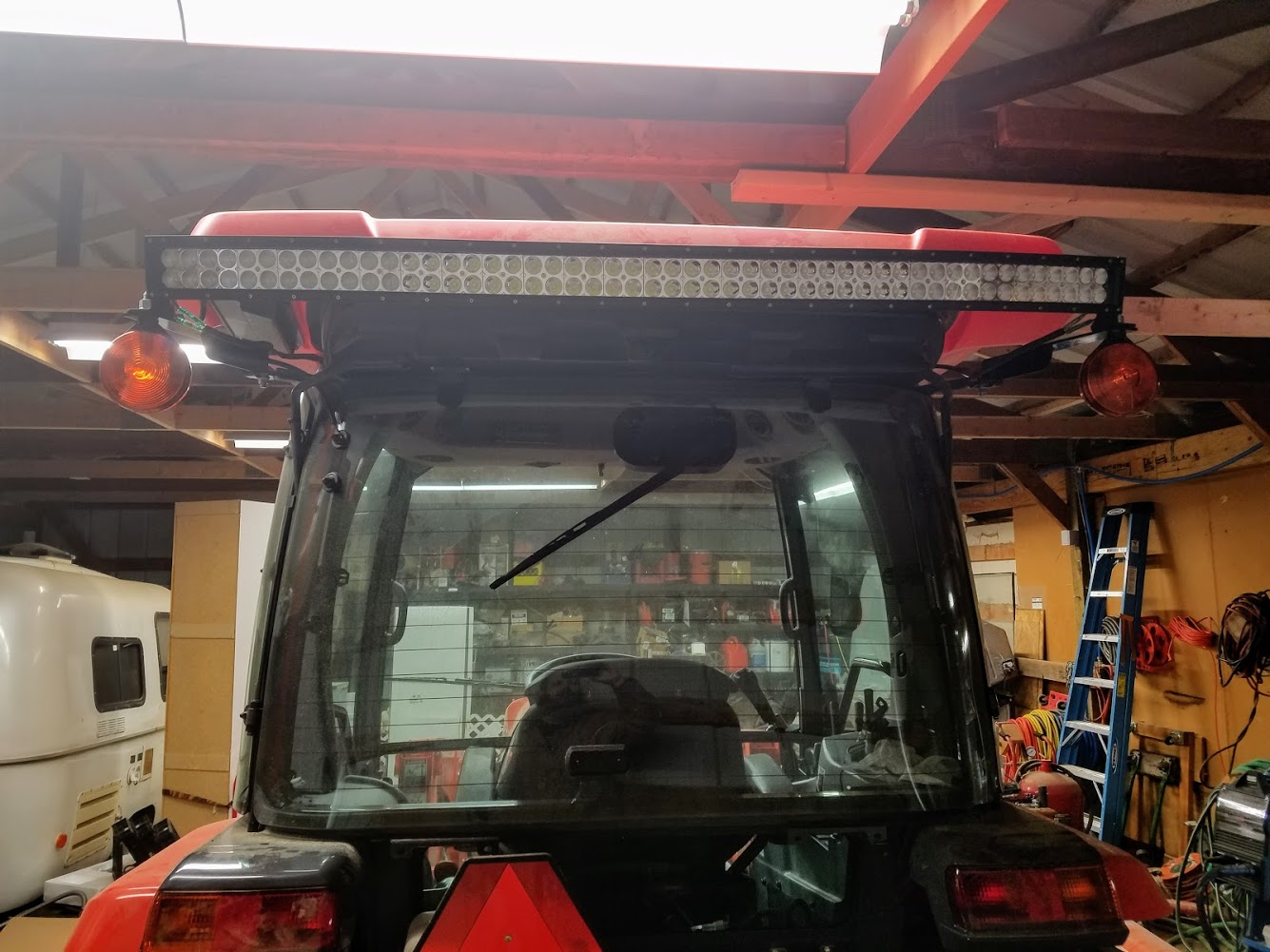

The 2 halogen cab lights on my new L4060 didn't cut it at all, and I wasn't about to pay $150 for 2 more of the same $10 lights & a $5 switch for the OEM solution on the back.

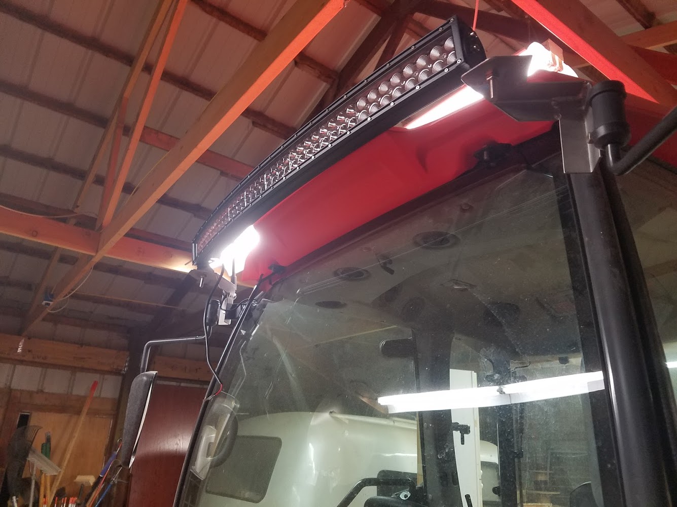

Picked up a $50 43" curved LED light bar up front Amazon.com: Led Light Bar, Senlips 43" 24W Curved Light Bar Off-road Light Bar Flood Spot Combo Beam IP 67 Waterproof for Off-road Vehicle, ATV, SUV, UTV, 4WD, Jeep, Boat- Black (43"): Automotive & $65 52" curved LED light bar for the rear Amazon.com: Led Light Bar, Senlips 52 inch 3W Curved Light Bar Off-road Light Bar Flood Spot Combo Beam IP 67 Waterproof for Off-road Vehicle, ATV, SUV, UTV, 4WD, Jeep, Boat- Black (52"): Automotive. They claim to be 240 & 300 watts, but when I hooked them up to my power supply (after I started planning the wiring) they topped out at 175 watts or so.

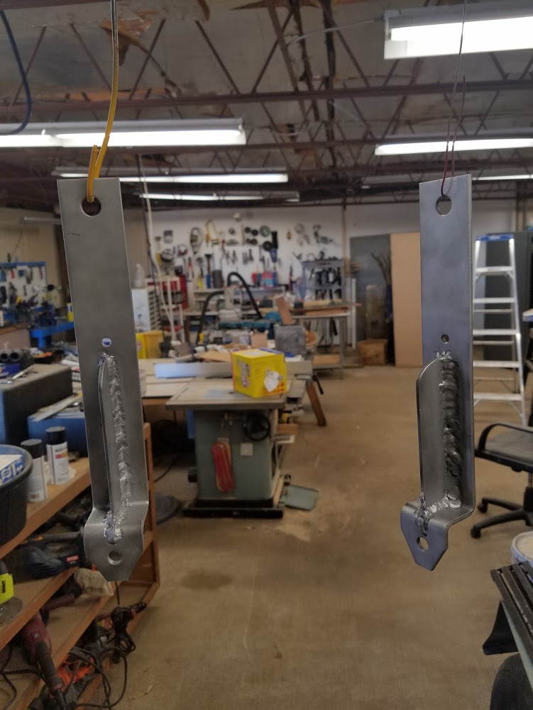

I welded up some brackets to mount the front bar onto the mirror mounts out of some angle iron & bar stock. Painted Kubota grey.

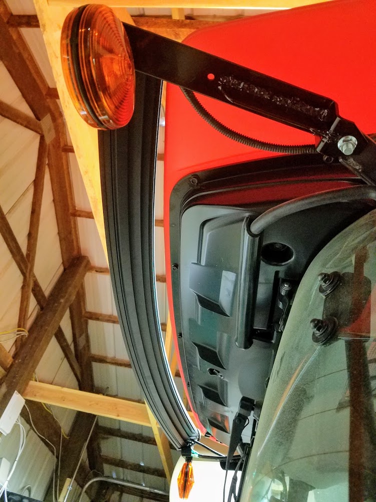

I removed the rear hazard lights & pumped the hollow mounting stud full of some sealant so they wouldn't fill up with water then flipped them upside down. Loosened up the mounting bolts a bit & they folded back to align with the mounting holes on the light bar. They upside down hazard studs now the mount point for my rear bar. The bent bar stock arms flexed a bit, so I removed them & welded on a vertical piece to support it better then painted them Kubota grey. Amusingly they were originally black rather than Kubota grey. The rear bar still bounces a bit & I can see the light shake a hair when driving. Might get around to adding more reinforcement later... Maybe.

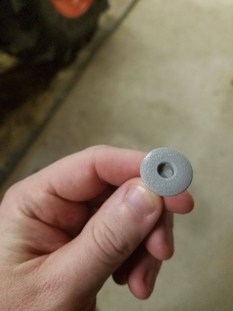

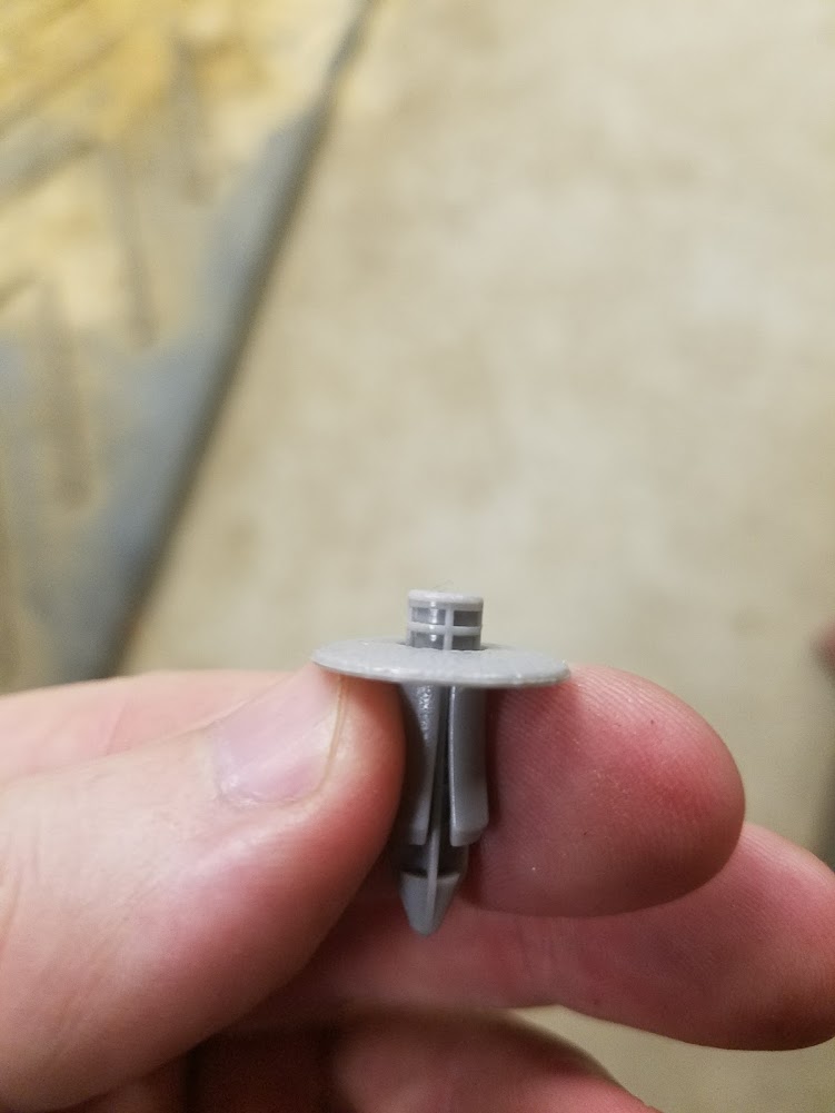

Figured out how to remove the buttons holding the pillar covers on. Just push the center in, then pry them out. To reinstall, pop the center out a bit & they go back, push the center level to lock

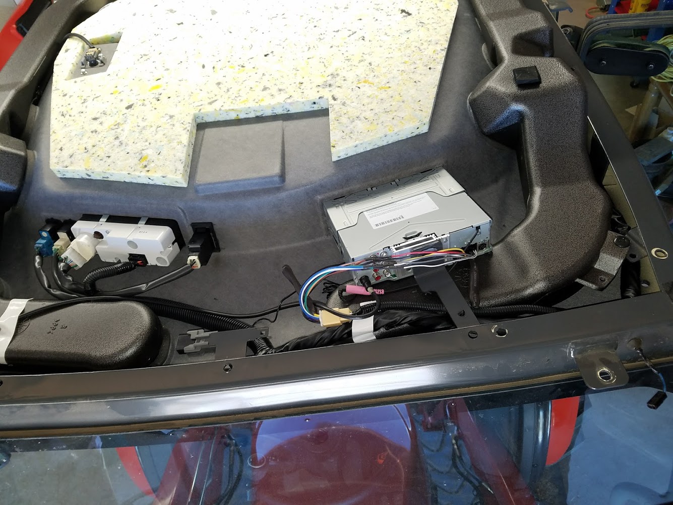

Popped the top. To do that you just remove all the round grey caps inside in the cab & undo the bolts underneath them. Leave the ones with the Philips socket alone. Also remove the bolts on the black bit around back around the edge. After that the roof just slides off. I managed to wrangle it solo despite having a back back, but 2 people would be easier. As suspected there is plenty of space up there next to the radio. Not much room in back as all the HVAC gear is there.
For my wiring, I basically decided to use DIY Bussmann RTMR Fuse Block, Part 2 – Parts | Bodenzord as a guide. Getting the Metripack connectors & crimper was a bit expensive, but I love the way it came out & how professional the results are. I have 10 fuses & 5 relays sitting in that box now. Only using 2 relays & fuses for the LED bars & another to power the USB charger & lighted switches running the relay.
Designed a template to match my fuse box & cut a hole in the headlinder.
Wired it all up, dedicated circuit for each light bar with relay & fuse.

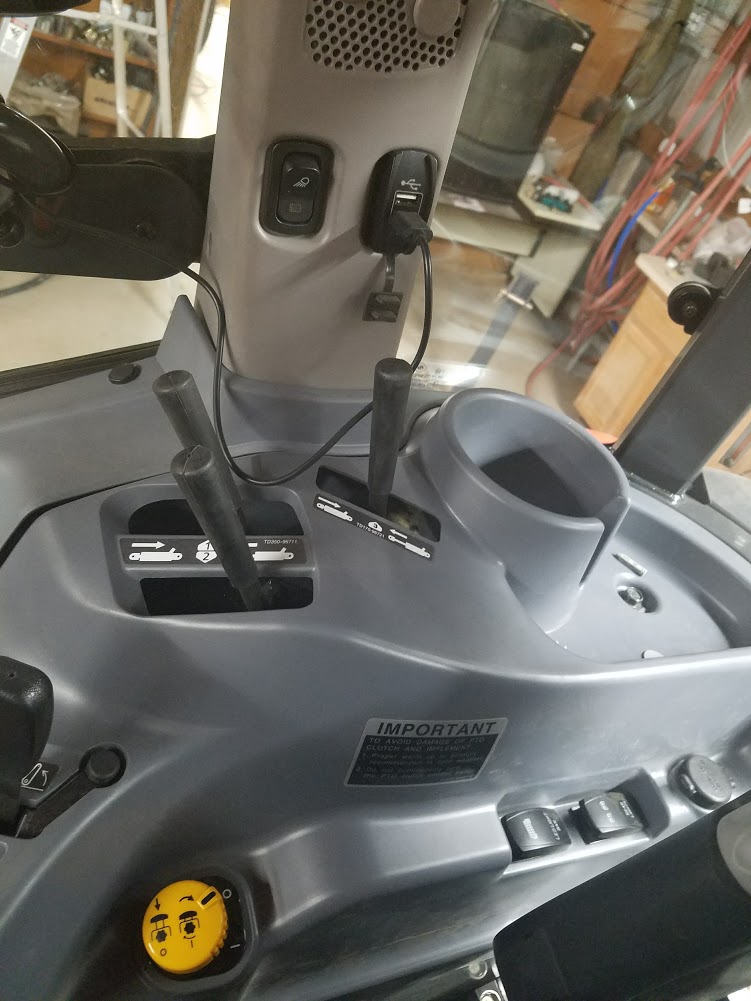

Another 5@ circuit running down to the side panel feeding the USB charger & the 2 new switches. The switches went into the cutouts for the OEM power SSQA switches I think. I would have put them on the pillar but I wanted them together & didn't want the USB charger laying flat so junk would fill up the ports. So I put the USB charger in the hole for the OEM rear lights. As a side node, the plug for the OEM rear lights is right behind the cover, just plug in the OEM lights & plug in the switch to get the OEM solution working. I left the OEM front light switch there. It does nothing for now, may use that circuit for something else later. Or may just pop the switch out & put a cover on it if I get motivated.

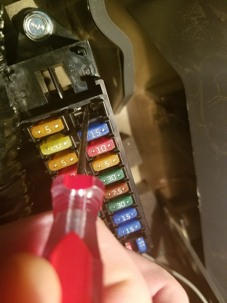

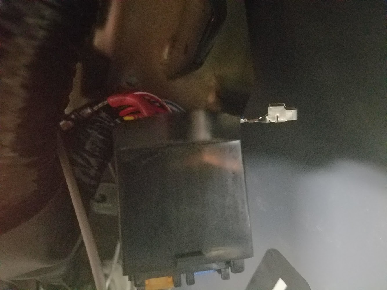

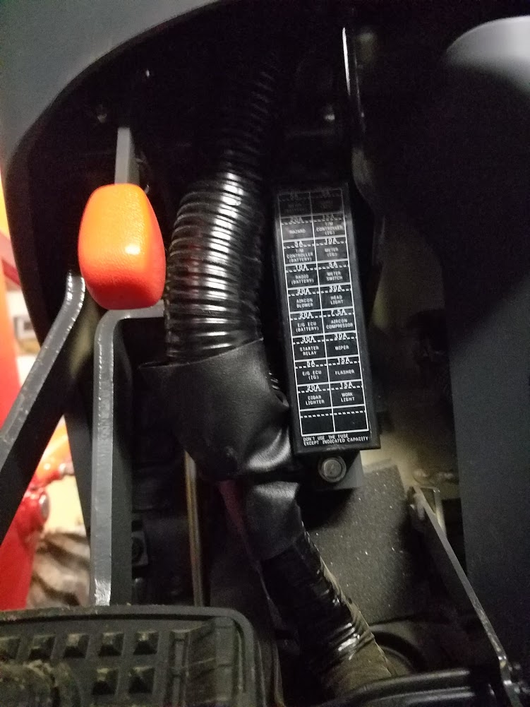

For years nobody has ever been able to figure out what terminals to use for the OEM fuse box. I didn't fair any better, but still didn't want to tap a wire. So I popped out the radio terminal. From the front use a tiny screwdriver to press in on the center side of the terminal & pull it out the back. Soldered on the wire I ran to run my front relay & popped it back in. I have a Add-A-Fuse, but it was kludgey & the OEM cover wouldn't have fit on afterwards.
10c-OEM_fuse_panel.jpg11a-Removing_OEM_pin.jpg12_OEM_block_pin.jpg13-Solder_on_wire.jpg

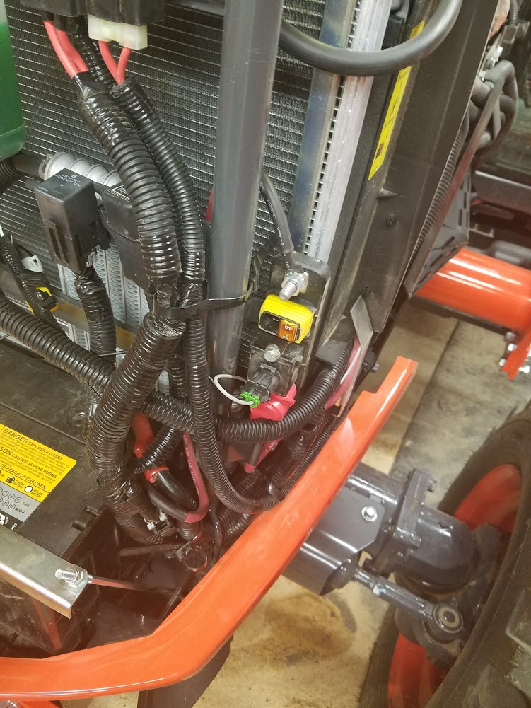

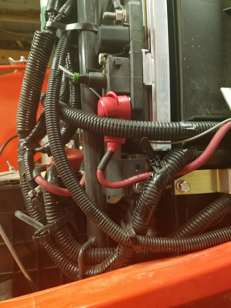

I stuck a 60@ fuse & relay unit up front. It provides a 60@ always hot (unused, didn't put in that fuse) & a 60@ relay switched circuit. EATON's Bussmann Series 3772-1AN22 Power Relay Module | Waytek Gets me the relay closer to the battery & protection right next to the battery. I ran 4ga (I think, got it from Napa & can't double check gauge without running up to the shop) wiring for everything, which is way overkill, and now that I look at it the same size as the ground going from the battery to the chassis. I should have gone a size or 2 down to save on cost, but I was planning for a fair bit of headroom in the new fuse box & trusting the OEM claimed wattage ratings on the light bars. $40 for a cheap hydraulic crimper 16 Ton Hydraulic Wire Terminal Crimper Battery Cable Lug Crimping Tool W/dies - - Amazon.com (same as from Horrible Freight) made short work of the battery cable crimping. Overkill for just this project, especially if you use smaller wire, but I'm crimping a lot of big Anderson 175 plugs for some nice jumper cable setups & while re-wiring my 25kw PTO generator.

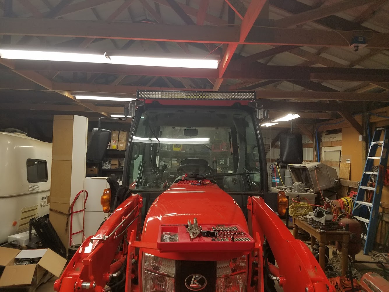

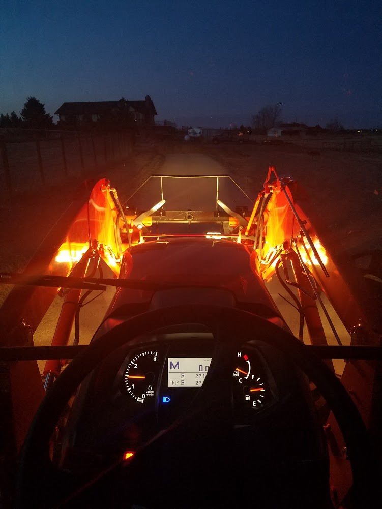

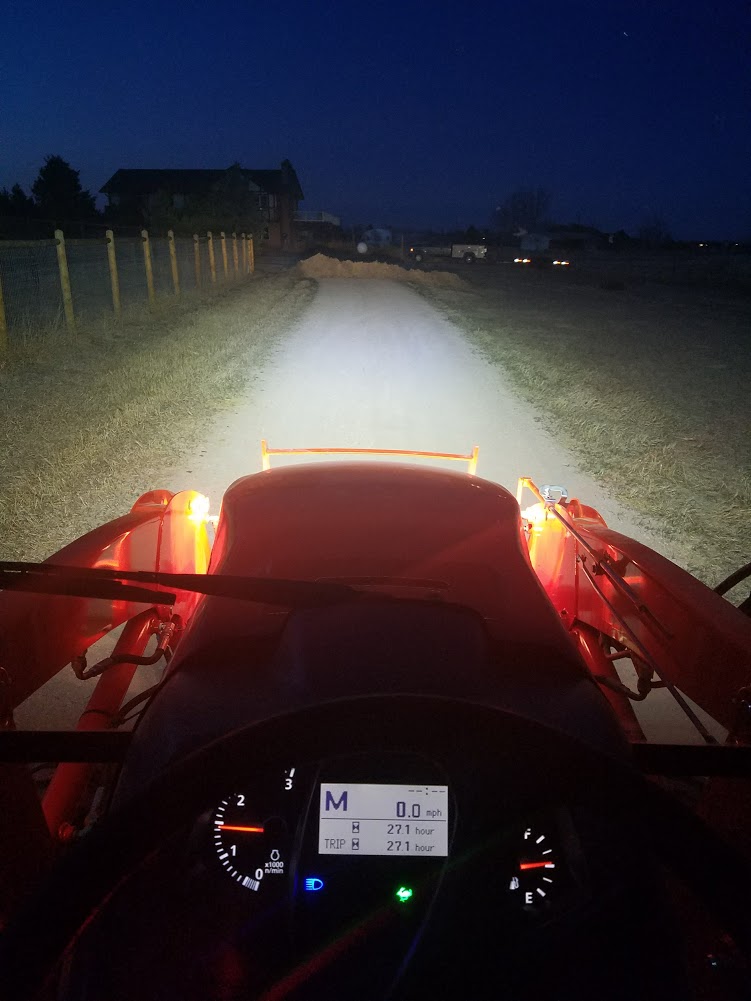

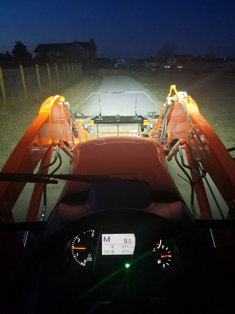

Now that it's all together I'm loving it. Took some action shots at dusk.

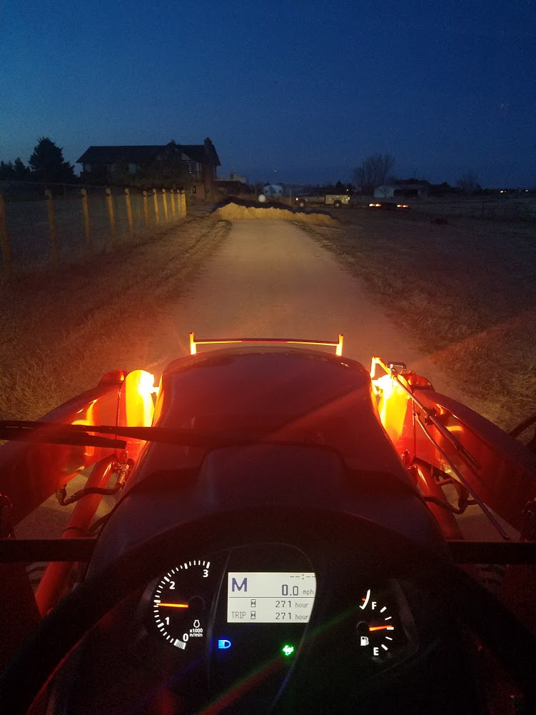

OEM running lights (not front cab lights, those are gone) & brights with the loader in the normal traveling height & all the way down. Lots of glare off the forks (bucket is even worse), but not a lot of light on the road in either case.
Front LED light bar only with loader at normal traveling height. Piles of light everywhere & no glare off the forks.
All lights on, light bar, running lights & brights with the loader down. Not really any more light on the road than just the light bar.
I didn't grab any shots of the rear light, but it's coverage is as good as the front. And there is absolutely no light back there stock, unless you get the puny OEM light kit.
I really love the light coverage of the curved light bars I got. Not only do they match the Kubota cab roof line front & rear, but they give a nice wide even coverage. Really happy with how this project turned out. I can see REALLY well in the dark now & have all the electrics I need for any future mods I'm likely to do.

Ya, those things drove me nuts until my dealer told me you just push the center in. Some of the easiest ones to remove once you know how.

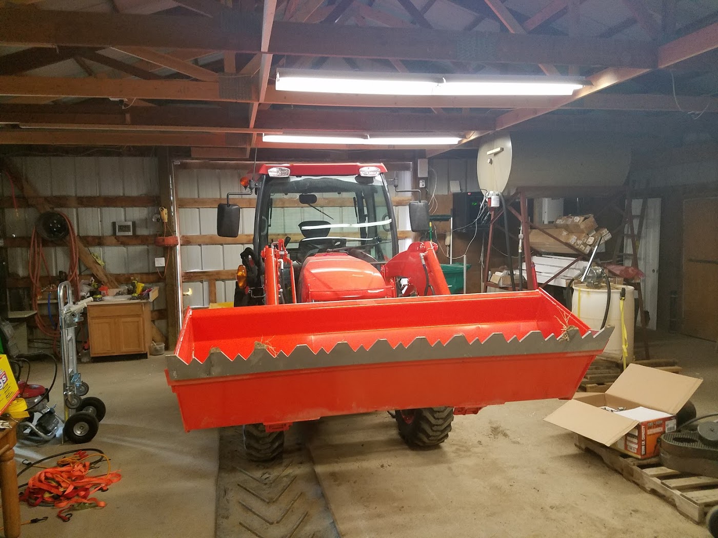

Ya, diesel. I put it inside to minimize the potential for getting water in the tank & to keep it out of sight. No theft problems around here, but better safe than sorry. I expect the 300 gallons to last me a year or 2 at least at my usage rate, so want to make sure it stores well & stays dry.

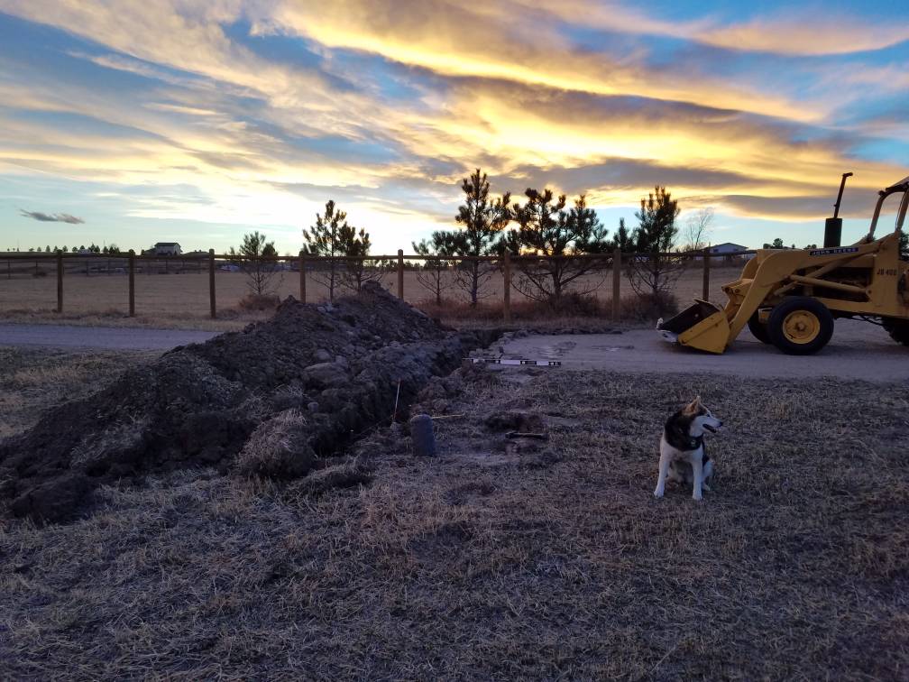

I borrowed a 40 year old backhoe from a friend to put up a ranch arch. Still have some pole trimming to do, then put up the crossbar.
While I had it, I dug a 3' ditch across the driveway where my driveway branches up to the barn & shop. Water just washes stuff down the branch across my main driveway. Gonna put a culvert under the driveway & re-slope the branch so it leans towards the "front" side where the culvert is rather than the back side near the house. Front of the hoe bucket is hiding the driveway branch
Old *** sloppy hoe. Some of the pins have almost a quarter inch of slop visible between the pin & bushing. But it was free & works way better than a shovel. My bucket spade on my L4060 couldn't have done that work if I had unlimited time. Took me under 2 hours to dig that trench. Did the last third the fastest & most level, despite it being dark & digging by braille.
