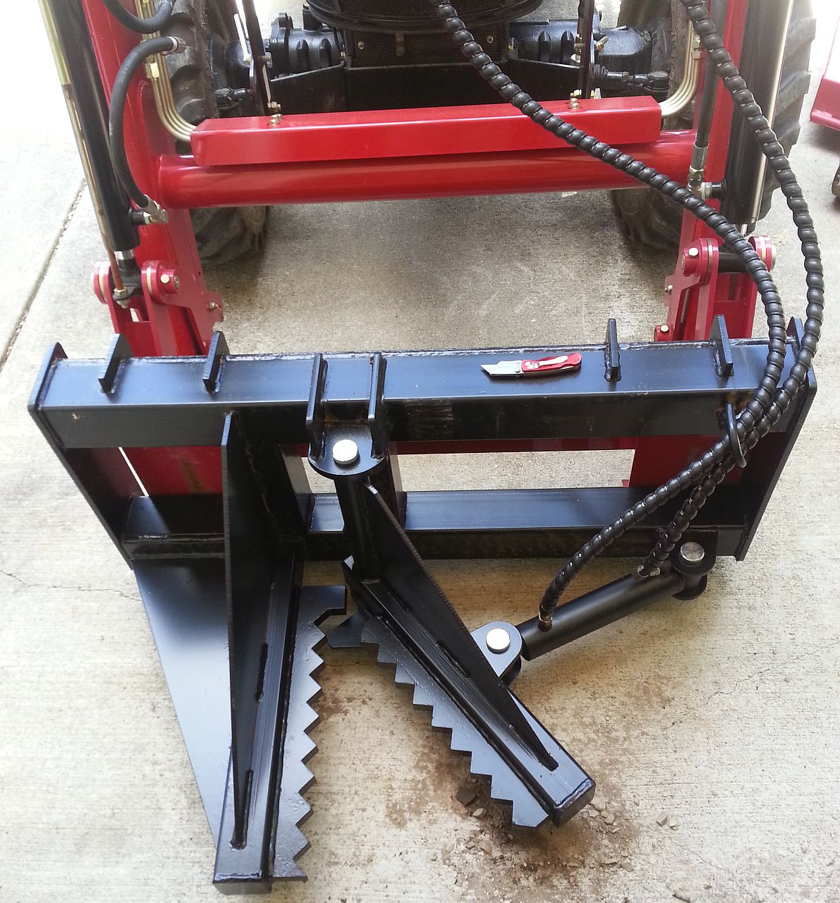

The Titan Tree and post puller is cheap and fun, and is what prompted me to buy a new FEL valve with a grapple spool. I hooked this up temporarily this morning (using the curl/dump valve, I don't have the new valve mounted yet) just to give it a try. It's loads of fun; I ripped out some roots that were sticking out from a stump excavation, and live honeysuckle is dead meat (and I have about an acre of that stuff!), popping right out of the gournd. It's a bit more trouble on a "real" tree, requiring some rocking back and forth, but everything I touched with it ended up in a brush pile. I even moved a couple of logs with it. It will be more usable when I can tilt the thing at right angles to the ground.
I have some t-posts and rebar sticking out of the ground, I imagine this will make short work out of that.
It does come with what I consider very long hoses; and the hoses for my new valve take into account the shortest hoses I've measured for any skid-steer-mounted attachment, so I'll need to figure out a routing to keep them out of harm's way.
Very solidly built, about seven hundred bucks when it's on sale (which was two weeks after I bought it, of course!)

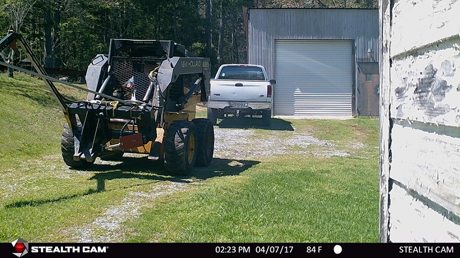

I found a picture showing the steel plate I attached to the cylinder to help protect the fittings against limbs.
So far it's protecting them. You can see in the picture I attached it using U bolts made from 1/2" all thread.
I'm trying to think up another way to build another guard that don't actually attach to the cylinder but to the body of the puller. I have something in mind and if I build it I'll post a picture.
   / Titan Tree Puller
Yeah, that cylinder is right out in the open, and the fittings appear a bit spindly. Perhaps I'll rig something up (I'm thinking overlapping angle iron or half pipe that attach at the cylinder eyes.)
   / Titan Tree Puller #7
That has been an option I was thinking about but I'm leaning toward a few pieces of steel somehow welded to the bottom frame 3x3 with just enough clearance for the cylinder to retract ? I'm still in the thinking process so I'm dangerous right now. :D

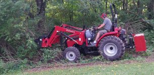

I have a Mahindra 2540, which has a basic weight of ~3,500 lbs, and 40 hp. Lift is just over a ton, and "transport weight" (what you can drive around with) is about 1,100. I have a 700 lb. (approx.) weight box on the back (also have 1,100 lbs. of backhoe, but that makes it a bit tight in the woods.) Honeysuckle and small saplings come right out, as others have mentioned, larger trees require a little working. It pull exposed roots nicely, as well (see my first post) and moves logs and unwanted visitors.
Note that I can get the rear wheels off the ground with just the weight box, if the tree I'm lifting isn't moving. With the backhoe, I hit the hydraulic pressure limiter.

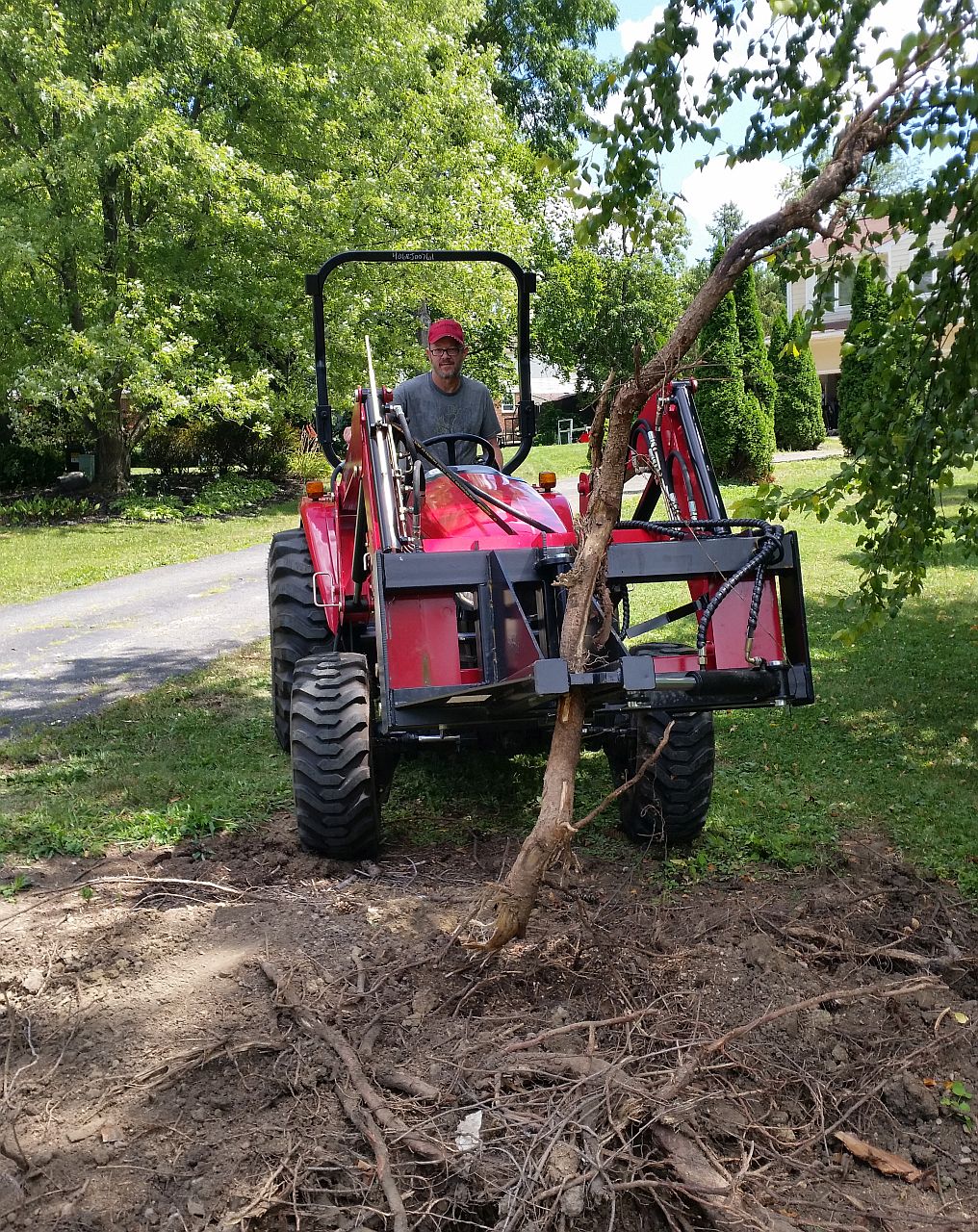

I'm not sure what brand of puller I have - but I love it!
For those wondering if their tractor is big enough - my 30hp with a breakout force of 1900# - with a bit of work was able to pull out this 8" tree. IMG_1799.JPG
a couple key tips when pulling out something more than brush. Cut the top off so you are just pulling out the roots and not wasting effort lifting the tree. Clamp on and drive forward - when attempting to back you will lift the rear off the ground creating both a dangerous condition and limiting your lifting affect.
