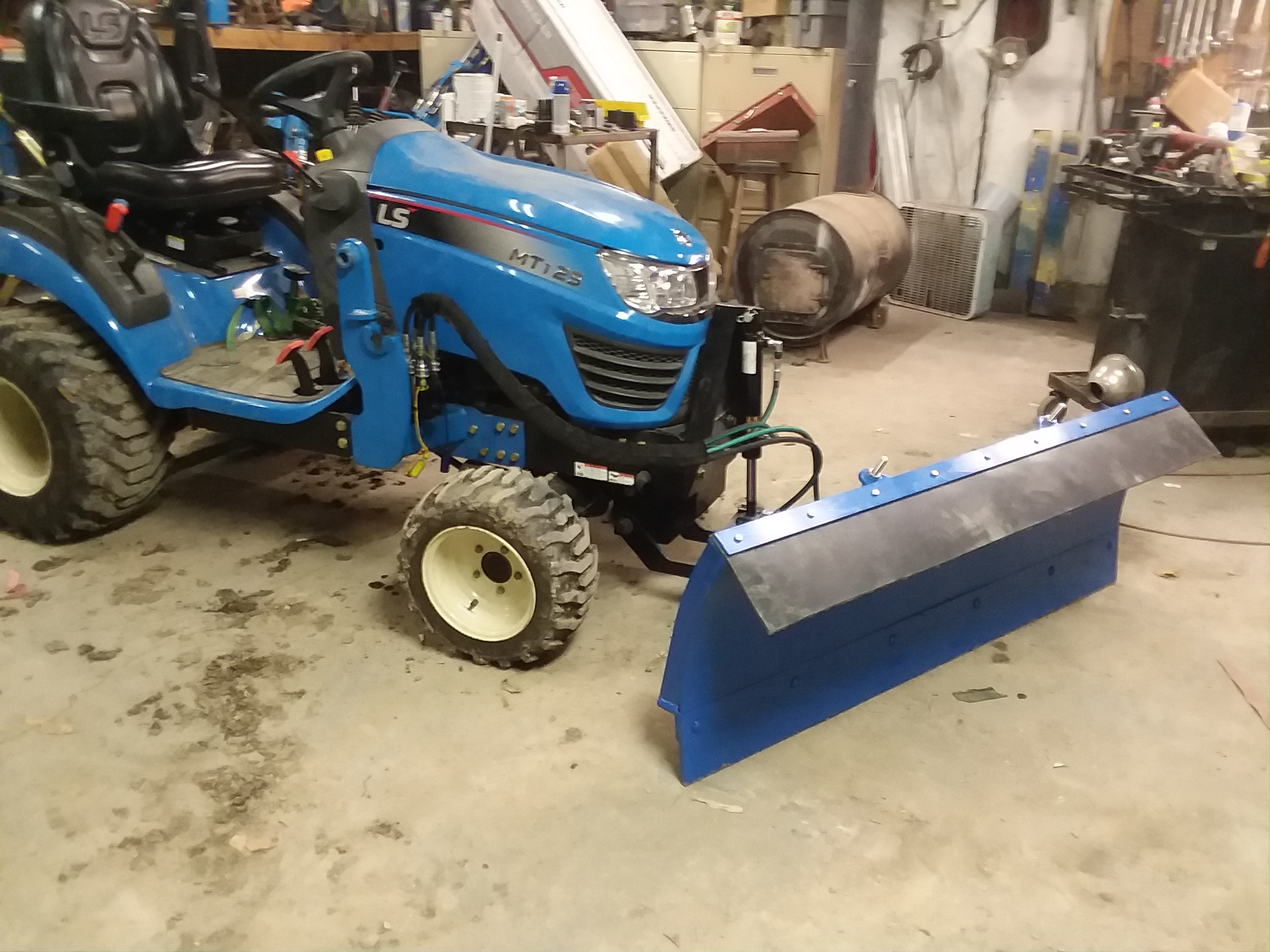

I could not wait for a plow for my ls mt125, so I built one out of a old round fuel tank and some drops from my local metal shop

Wow, awesome job! Now all the 125 owners (especially me) are gonna want more specifics / measurements. Do you have a total cost?

Put pipe on the bottom of that edge. Most folks find 1" pipe is too narrow to split, but 1.5" works pretty well. Cut a slit, bang it on. We put a half dozen welding tacks in addition. Makes a huge difference when pushing snow off gravel, back lots, etc.
Nice job, btw. Really nice. Did you put any articulation into your design, for left and right angling? The one photo looks as if you used a second cylinder?

Very well done! We don't usually need it in TN, but I could have this week. We have over a foot of snow on the ground. I pushed my drive off with the buck. That plow would have been great. Great job again.
