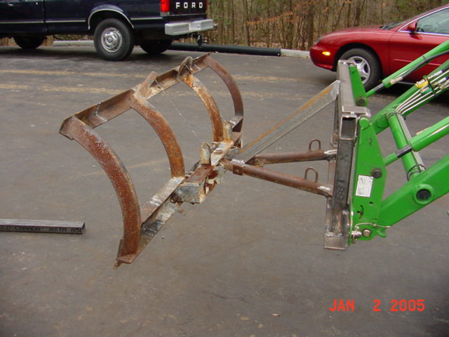

The following are pics of the Snowplow that I am building. It is a follow-up project the the remote I added to the FEL in this THREAD
I started with a Meyer's 6.5' Poly Plow that I bought used from a member on this board (Thanks Scaper).
The A-Frame was shortened as much as posibble to get the plow closer to the tractor, then welded to a heavy piece of angle.
Time for a liitle snack before I start welding!
   / FEL Snowplow
#2
The Frame is now done. The mouldboard was cut down from 6.5' to 5' and welded back together. This was done for 3 major reasons:
-To reduce lateral loads on the FEL arms
-To make storage easier
-And to reduce weight
Time for a test fit!

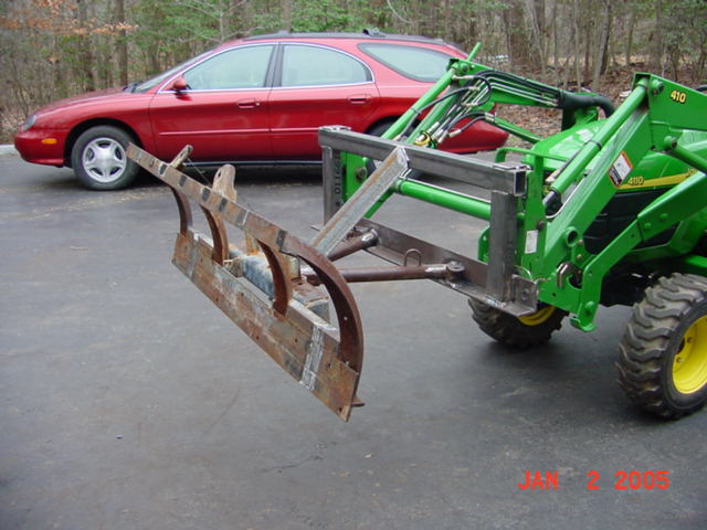

   / FEL Snowplow
Side view of frame and mouldboard.

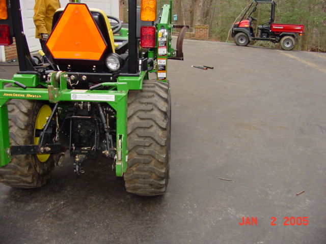

   / FEL Snowplow
Front view, plow full RIGHT
   / FEL Snowplow
Rear view, Plow full RIGHT.
As you can see, 5' is plenty to cover tracks, the JD plow that is sold for this tractor is only 54", it barly is as wide as the tractor when fully angled.

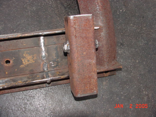

   / FEL Snowplow
This plow had no skid shoes on it, there were not even mounts for them. We felt it important to have them, so we made them.
