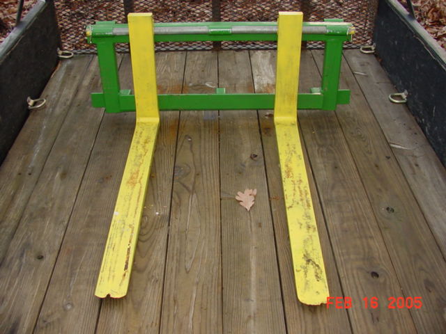

Last year I made a forkilift attachment for my FEL. I do not have any pics of the build process, But here are some pics of the completed project that I have had a few requests to post.
First pic, Front view

Second Pic, Rear view

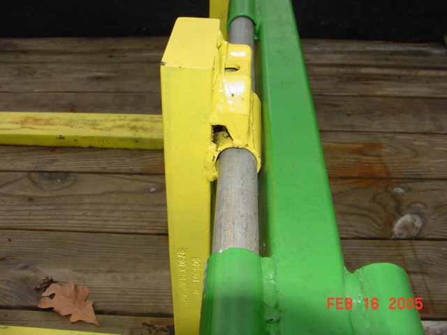

Third pic,
Detail of how the forks attach to the frame. Just steel pipe and 1 1/4 rod. The frame is made from 2x2 and 2x3 box.

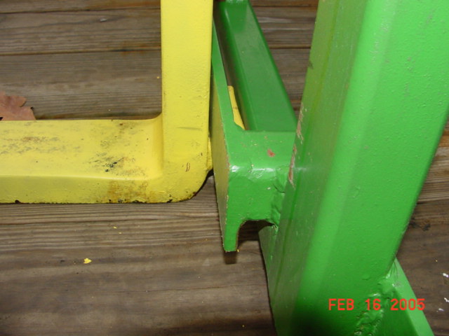

Fourth and last pic,
Detail of the bottom of the frame, The 3/8" x 3" plate keeps the forks from rotating on the rod, and helps keep them from sliding unintentionally.
The forks where purchased from a local forklift service company, they where "worn out" by their standards, but lots of life left in them for me. They cost $100.00, but probably could have done better if I had shopped around.
