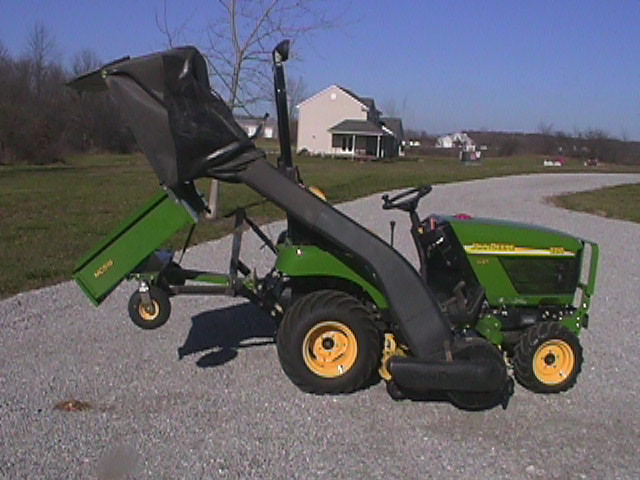

I am looking at the X595 vs the 2210. I've read the many posts on the choice, thanks they are helpful. I do have one issue still with the 2210 - is there still no material collection system for it? Seems silly when there are collection systems for the 790/990 and X series.

The MC collection system has sucessfully been modified to fit the 2210.

I believe it was a poster on tractorpoint.com that had his dealer do this. I did a quick search, but I never have good luck with searches. The post did include pics and did use the 3PT hitch and hydraulics.

I too struggled with your decision. I had a 445 with the MC519 and powerflow head and loved it. I wanted to upgrade, but the 2210 did not have a collection system. I wanted the 2-speed hydrostat and higher capacity load on the 2210, but wanted the X-series collection system.
I studied the situation and decided I could make the MC519 cart work with the 2210 since the mower decks are identical and the powerflow head would fit the 2210 decks. All I had to do was mount the MC519 cart.
If you search on my user name for my previous post, you will find one on my MC519 conversion. I ended up making a hitch that bolts to the front of the cart and works with either the links or a quick hitch. I've been real happy with it and I have the added benefit of being able to carry the cart and dump it from a height of about 3 feet. Let's you pile the collected material onto existing piles.
Let me know what you think.
John
