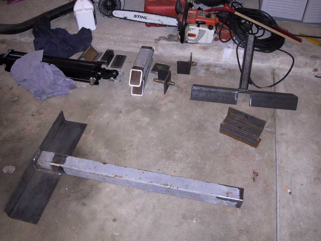

Start of the 3 point. The angle is 4" x 6" x 3/8" and the box tube is 3" x 3/16" - kinda light .... but hey it was free. /forums/images/graemlins/grin.gif
You can see some of the additional components in the background.

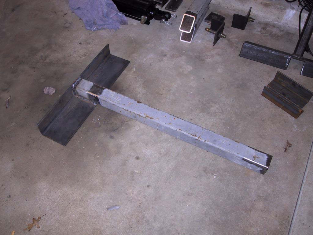

Another angle, showing the upright for the 3 point (3"x 2" x 1/4" tube) and the angle (4" x 4" x 3/8") which will form the box for the lower link pins and some other components in the background.

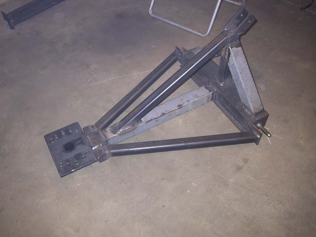

Big jump in progress here. The 3 point is basically complete except for capping the stubs in the rear (in front of the index plate) and adding a little bit of plate at the top link to reinforce it..
Because it was suggested to me that using 3/16" x 3" for the main tube was a little light, I used a couple of pieces of 2" x 2" x 1/4 box tube running back at an angle from the lower bar on the 3 point to the rear to hopely prevent any twisting. The rear of the box tube where the index plate is also has two pieces 3" x 1/4" angle welded around it to beef it up.
The index plate was made from 1/2" plate and the hole for the pivot pin is 2". The index plate is drilled for angles of 0°, 20º, 40° if memory serves me correctly. This probably should have been 0°, 15º, & 30° but it seemed to me at the time that this would have not left enough metal between the holes as I would have liked, given the diameter of the circle I was using. ..... in hindsight ...... /forums/images/graemlins/grin.gif

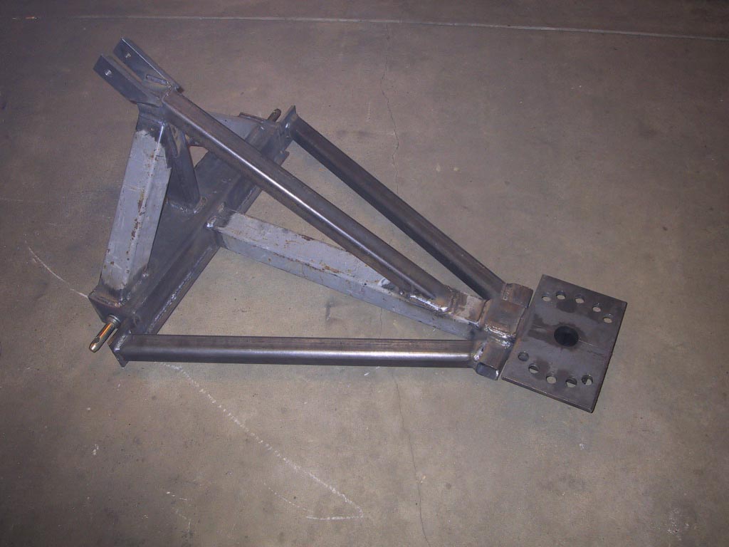

Re: 80\" Landscape Rake
Another angle. The pin mount for the top link is set forward from the upright so that I could use a Quick-Hitch - it's basically a guess ..... since I don't have a Quick-Hitch yet. /forums/images/graemlins/grin.gif

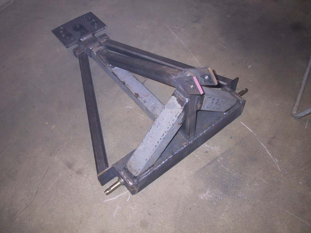

Last one of the 3 point from another angle.

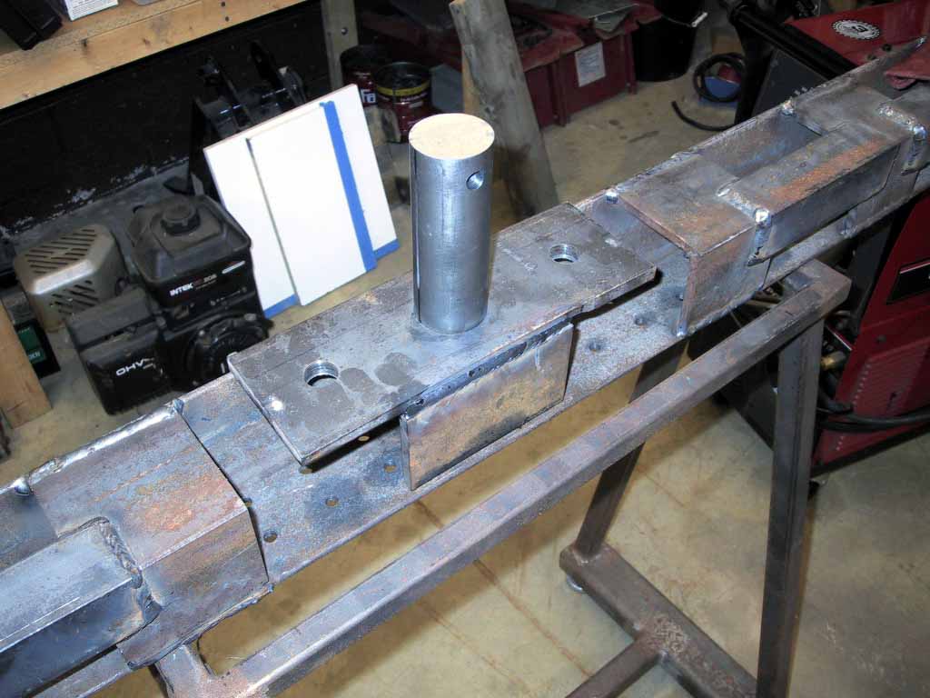

I used a piece of 2" x 6" cold rolled steel for the pivot pin. Image shows the pivot pin welded to the angle adjustment pin plate and ready to be welded to the tine holder.
I drilled a 2" hole in the angle pin adjustment plate and then welded the pin on the bottom side (slightly recessed) This in turn, was welded to a piece of 4" x 4" angle which will be welded to the tine holder. I drilled a 1 1/32" hole (biggest S & D bit I had) in 4" x 4" angle so that I could weld the 4" x 4" angle directly to the pin, as well as welding it on the sides to the angle pin adjustment plate.
