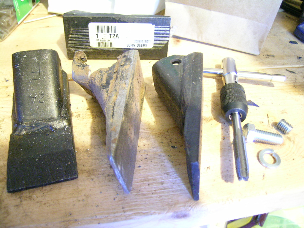

I have a very small backhoe (no laughing please), and I recently damaged a peened tooth. I went to the JD dealer and asked for a tooth for a small backhoe such as a JD7, hoping it would be generic enough to use on my FCM rig. They came up with part number T2A for $Cdn 8.42 and it seems like a good match.
The JD tooth looks too beefy to peen or crimp on, which is fine by me. It has two holes that line up with the dimples on my tooth stubs, so I decided to put threads in the holes and secure the tooth with bolts. I used a 16NC SAE thread and 3/8" bolts. I couldn't find short enough bolts at the local store, so I had to cut off 1/2 inch or so. I used lockwashers, since there was no room to insert nuts. I've tested it for a couple of hours of rocky digging and so far, everything is very tight. The remaining peened-on teeth are wiggly, so I'll replace them as needed. I'm hoping that this will turn out to be a quick fix for all future broken teeth.
The photo shows a few of the new JD teeth (I bought spares) surrounding the damaged tooth, along with the threading tool, bolt and lock washer.

Apologies for posting to a necro thread but... yesterday I finally lost another crimped-on backhoe tooth, 11 years after the previous one! I grabbed one of the spares made long ago (see above), bolted it in place, and was back to digging within minutes. Also, the bolt-on replacement from 2009 is still going strong. This approach really seems to work.
