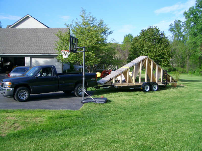

We moved into a new house not too long ago, and I've been missing my storage barn ever since. The new 3-car garage is jammed with junk and because I hate clearing the snow and ice off the cars, shuffling 'em around to plow, etc., I knew I'd have to do something before winter set in. So I've been keeping an eye and ear open for some cheap trusses at the local lumberyards; hoping some builder's mistake would be my gain. I just 'happened' to have a few hundred in pocket and my trailer behind me when I spotted these, so my excuse to start a new project was born...

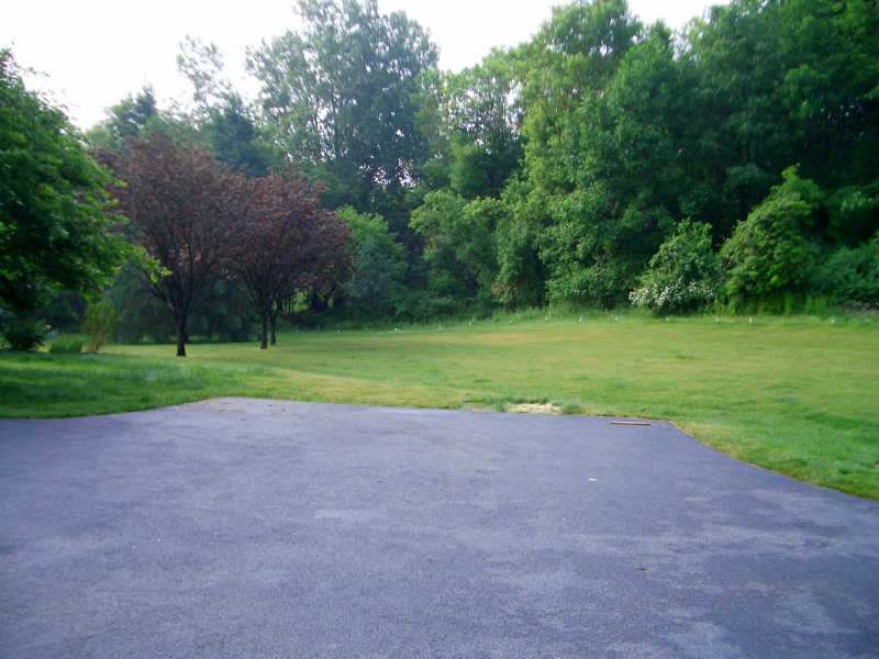

The trusses are (16) 6/12 pitch cantilevered plus (2) gable end trusses, pretty fresh, and rated to meet the new 50psi snow load codes in force this year. Came with all the design spec sheets and drawings, so the local building inspector will like that! That makes for a 24' x 34' footprint and it looked to me like the best place to build it was right off the 22' wide driveway turn-around.

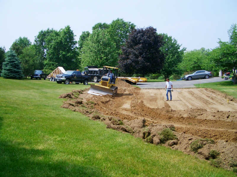

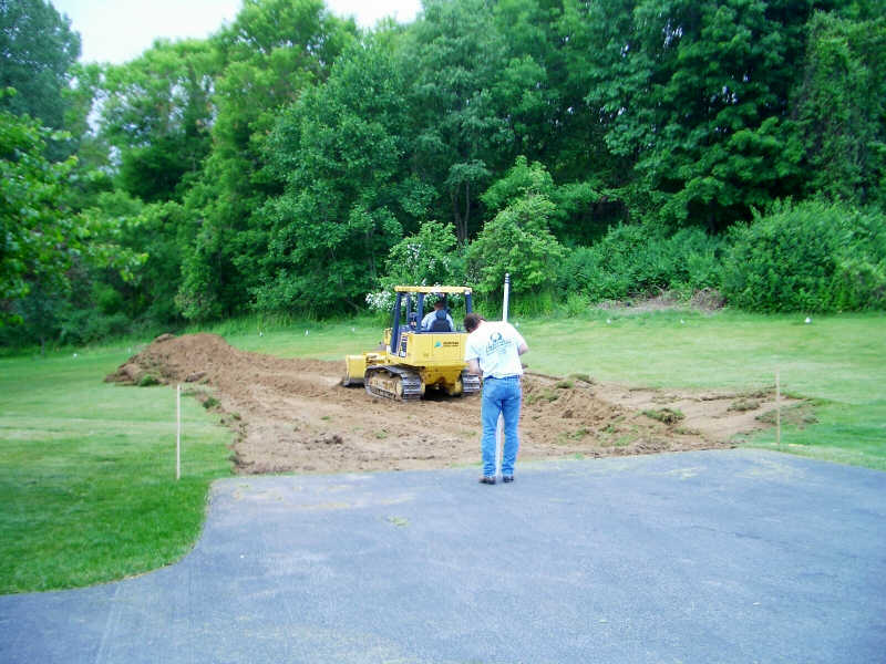

Just so's you know, I was 'constrained' by the 'boss' from putting up a nice, big pole barn. "Wouldn't look very good next to the house." she said. So, I will have to make do with a more traditional 'residential' looking garage/shop on a monolithic slab. Here's the Komatsu 31EF dozer breaking ground.

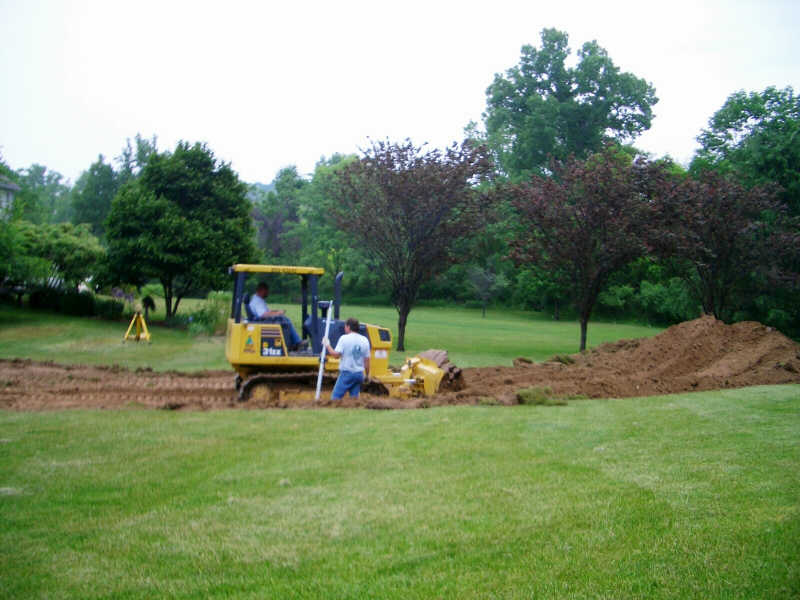

Have a bit of a grade to deal with, there was a slope and a drainage swale running thru the slab location. There will be a 2nd overhead garage door 9' x 8' in the right rear side for workshop access and inside tractor parking, which means we have to cut into the slope a fair amount. Need the side overhead to gain easy workshop access without having to move inside vehicles. Standard 16' x 8' overhead door on the turn-around gable end... both 8' for ROPS and pickup ladder rack clearance!

Here's a better view if the dozer starting to cut back the slope. Thankfully, we have great soil at the new house, real easy to push, not the rocky mess we had just a few miles up the road at the old house. The Komatsu hardly broke a sweat, and made short work of this project!

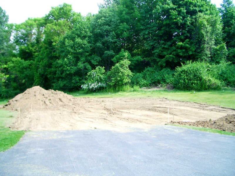

Here's the finished rough grading. I can use the dirt for a couple of other projects I've been working on so I just told the operator to leave me one big pile in the rear and a smaller pile up near the driveway. Pay to haul it away?! I don't think so, I want the seat time!

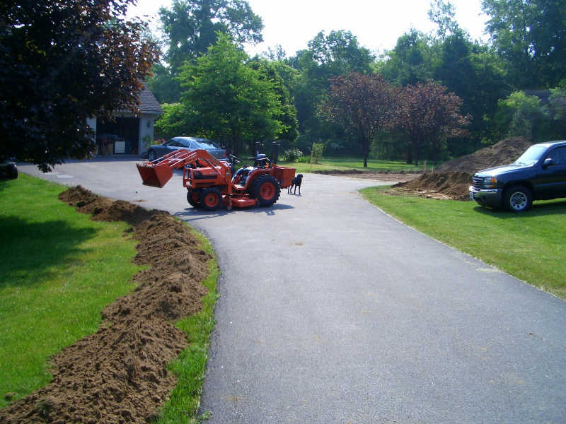

Ever since we moved in and the moving van cracked the edge of the driveway, I knew I'd need to do something about building the adjoining grade up. Didn't take long to move the small pile of dirt with the new 7610. "See Honey, I told you this new toy, er, tractor would pay for itself!"
